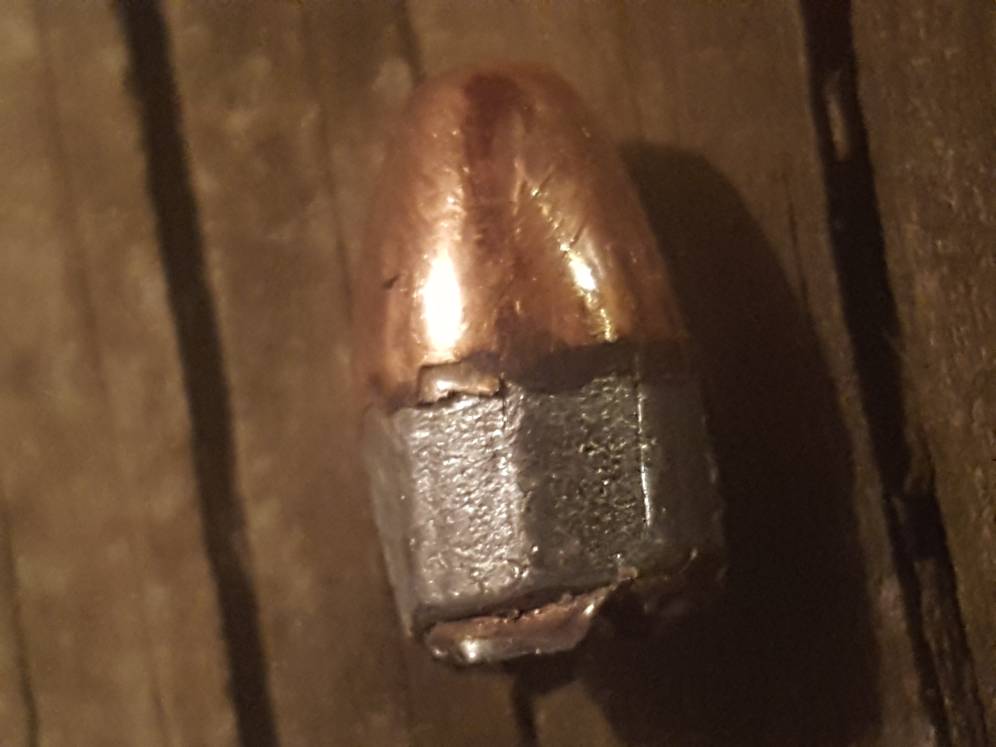

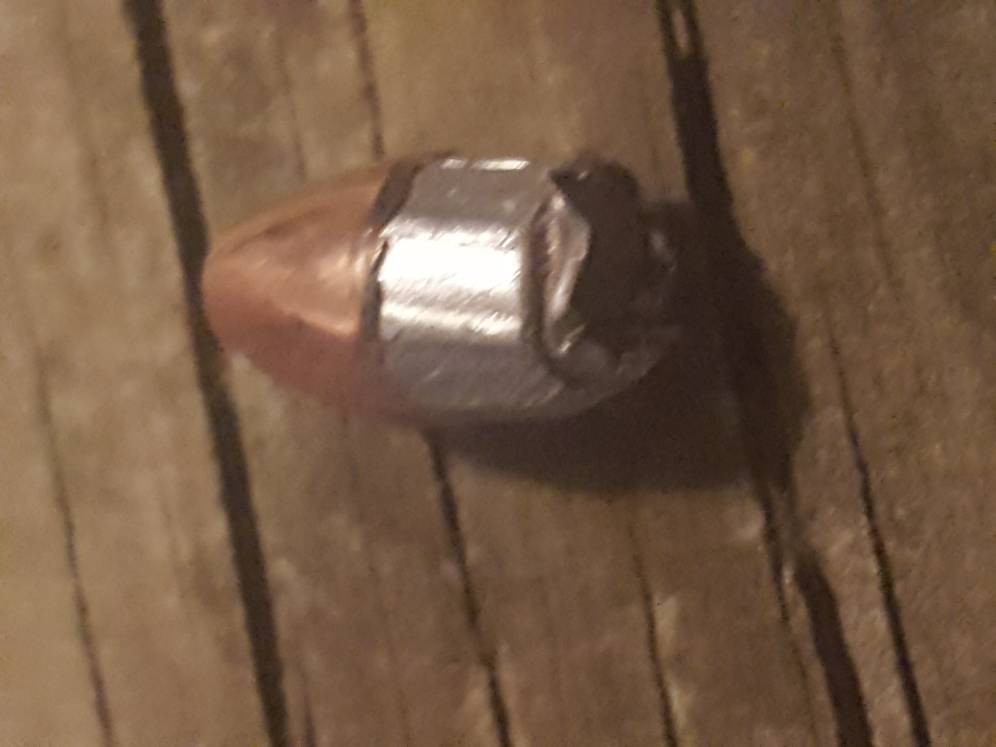

Anyone experienced with Berrys Plated bullets. Specifically, 115 gr 9mm? I shot some with 5.2, 5.6, and 5.9 gr of CFE Pistol, from a Hi Point 995 Carbine. uploadfromtaptalk1520465711692.jpg Shot into 3 gallon jugs at 15 yards, went into ground after 2nd jug. Does this seem normal? The copper jacket is gone from where the rifling engaged the projectile.

Did you find the electroplated jacket I the jugs? My understanding is it is only for reduced leading in the barrel and not a structural jacket.
I did not, but it could be in the sand around the jugs.
   / Cheap Start to Reloading? #88
Check your barrel.
All that holds the plate on is the friction with the soft core. The strength of the foil like jacket is insignificant. If the friction of the jacket to the barrel is greater than the friction of the jacket to the core, the core could"squirt" out of the jacket.
   / Cheap Start to Reloading? #89
Those Berry's are copper plated, not jacketed, so what you're seeing is not unusual, just a good tight bore and riflings. I've reloaded and shot thousands of them, but at James mentioned, I've switched over to coated bullets since they've got the prices down to being compatible with plated bullets.
If you're really concerned over it, shoot an email to Berry's, they are really quick to reply to any questions or concerns.
   / Cheap Start to Reloading? #90
I have reloaded and shop thousands of Berry's and other manufacturers plated bullets and recovered many of these bullets that I shot. In 380, 357 and 45 cal and have not seen any that lost their plating along the rifling. Your picture to me indicates either too tight a fit or too hot a load. Bob
