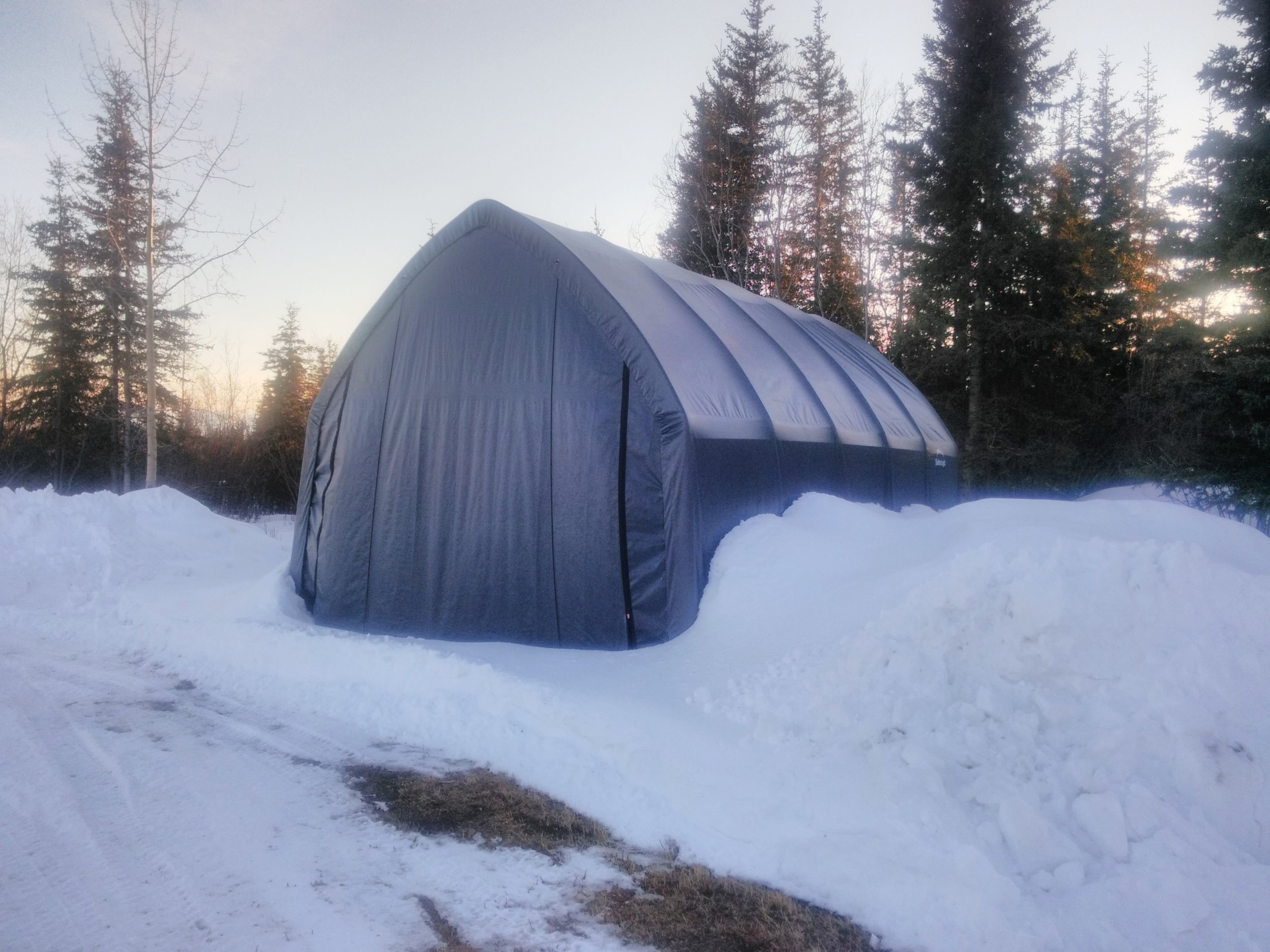

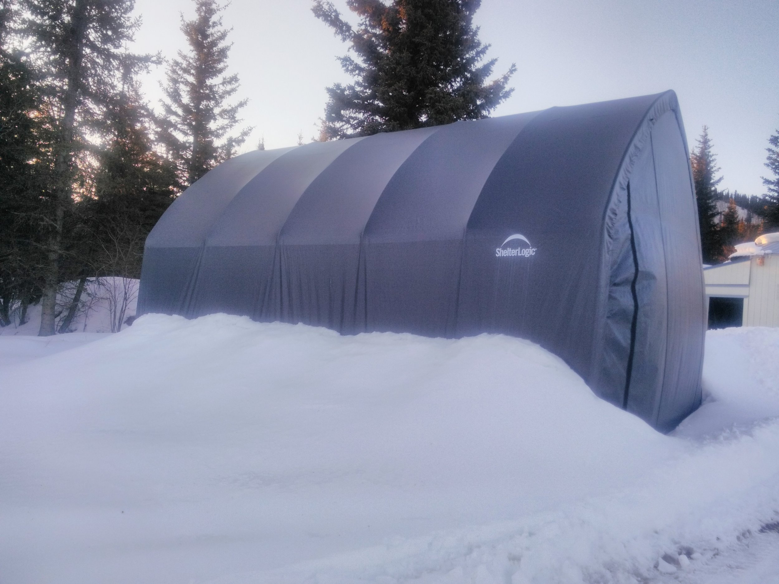

13x20' ShelterLogic until funds are available for either connex's, carports or home built sheds. Mine are going on 3 years in the harsh alaska climate and are still like new. You can buy replacement covers or add metal roofing for more longevity.

That’s impressive and encouraging to hear.
