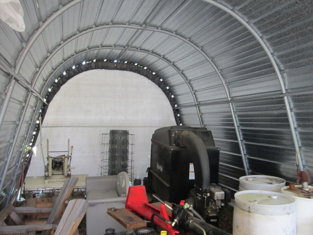

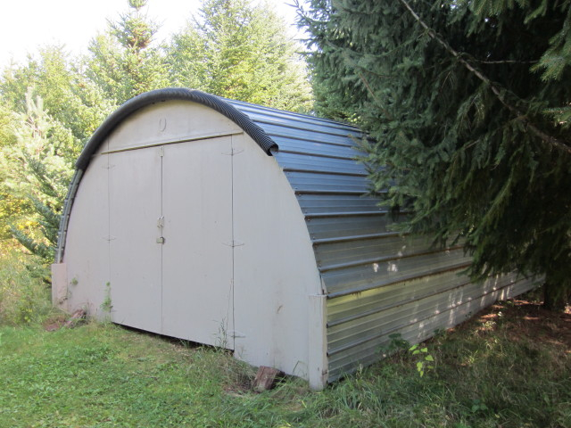

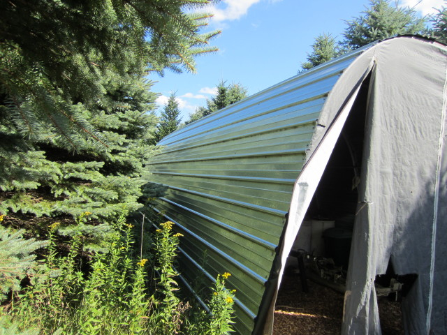

Those fabric covered buildings don't last long, depending on the quality of the fabric. Once the fabric tears, install some metal roofing sheets, easy and durable. I now have 3 sheds covered in this manner and have not had a snow load issue. You MUST get all the hoop frames all level and straight as it really helps the process. One building was a old greenhouse and I built wood ends. Once the metal is screwed to the hoops, it REALLY stiffens up the structure.

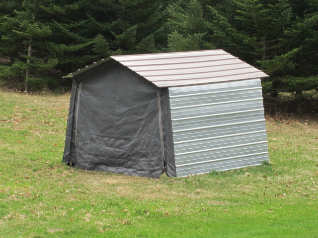

The fabric on my 10x10 shed finally gave out after 20+ years so I had to put metal on it last Fall.

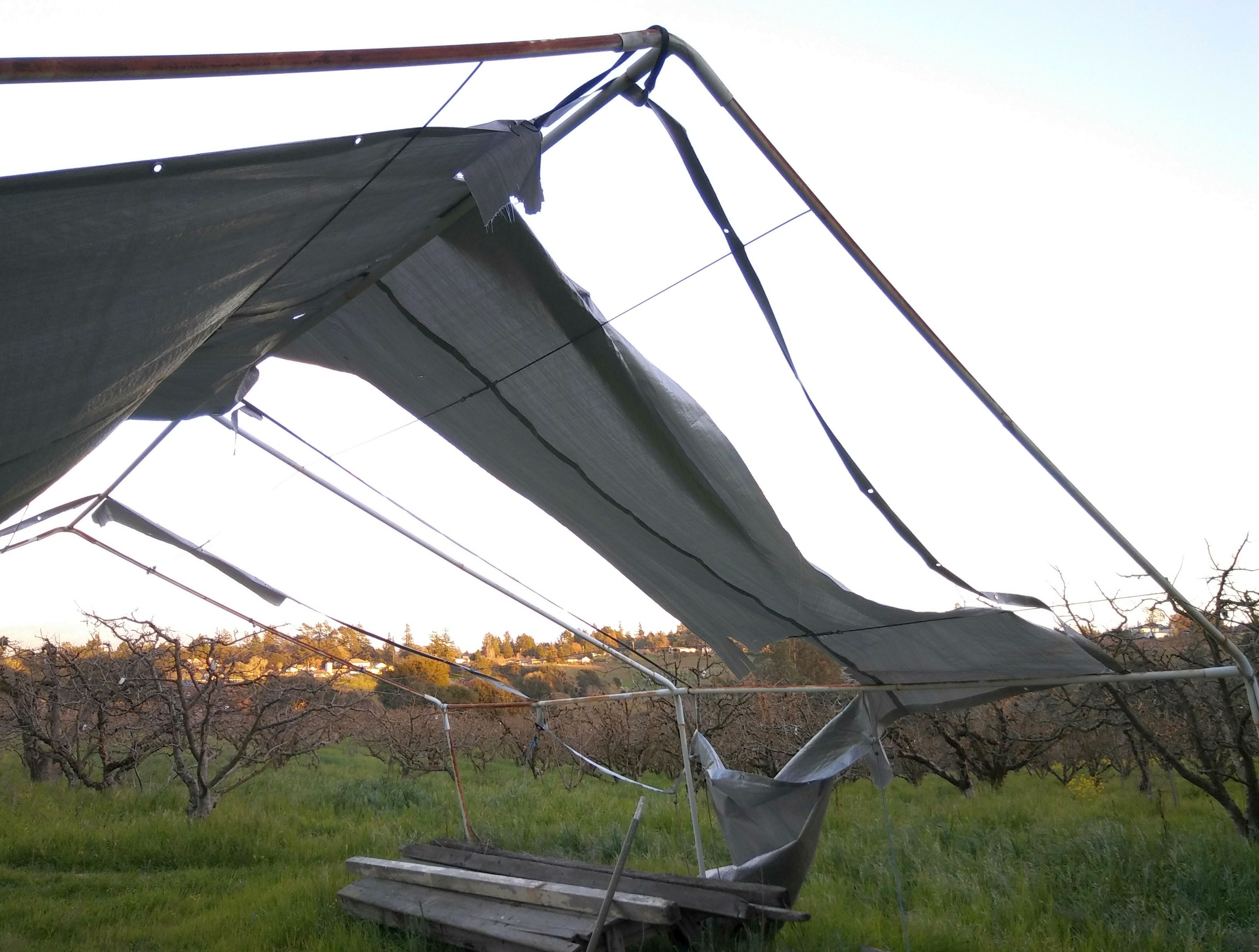

I didn't have much luck with Harbor Freight's 'instant garage'. Over several years I don't think I ever had a tarp last long enough for a third winter. No snow here. Here's a photo after the second winter for this HF tarp that replaced the original one.
   / Cheap ways to put a roof over equipment? #28
That's not the same thing as what I have bought, but the covering may be the same material. I don't really have winter, just an extended fall . We'll see how it goes! I got the 1 year warranty so I can see if it'll last or not.
