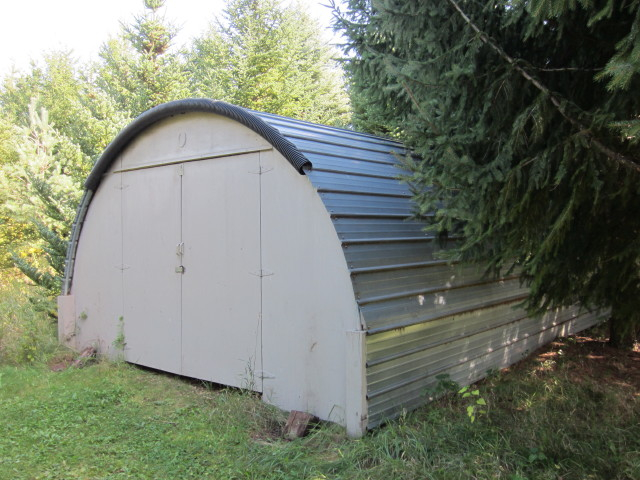

Those fabric covered buildings don't last long, depending on the quality of the fabric. Once the fabric tears, install some metal roofing sheets, easy and durable. I now have 3 sheds covered in this manner and have not had a snow load issue. You MUST get all the hoop frames all level and straight as it really helps the process. One building was a old greenhouse and I built wood ends. Once the metal is screwed to the hoops, it REALLY stiffens up the structure.
It can be even cheaper if you can pick up old roller doors. I use 6 uprights and 3 hoops rolled from 30x30x1.2 SHS.
Works a treat.
No snow here though.
Cheers

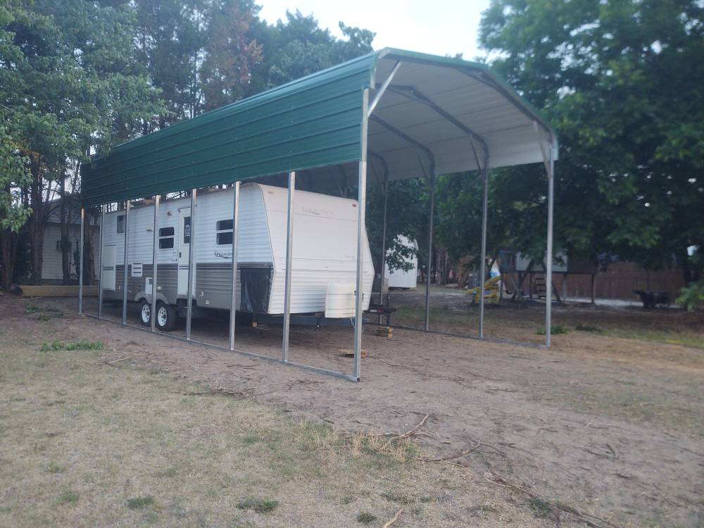

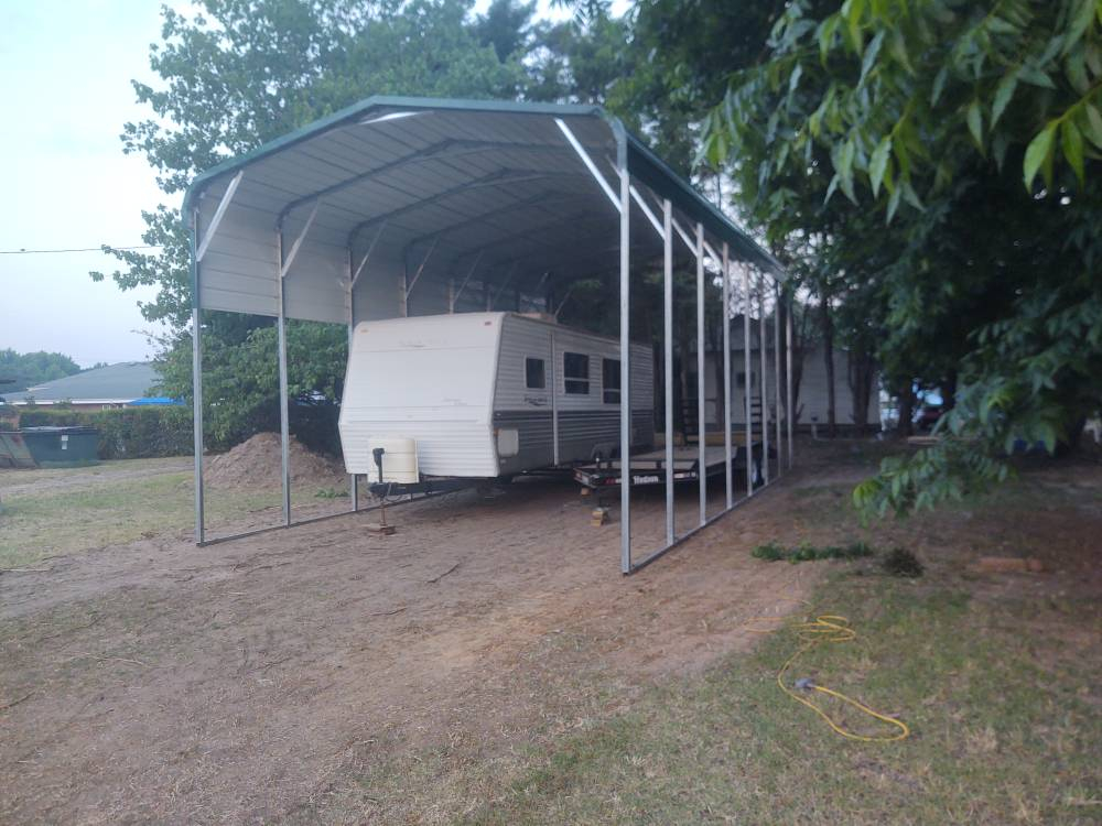

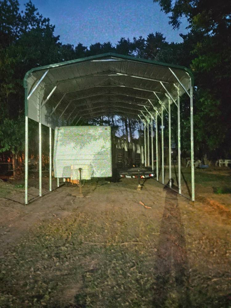

They showed up about 6 pm yesterday and installed my shed. Couldn't be happier!
$3400 installed for 18x36 with 13' leg height, and a 3' strip down one side.
