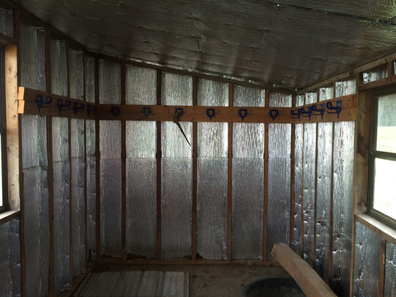

My in laws are moving their chickens into an 8x16 building they bought used from a neighbor. My MIL wants it to be insulated. Can I just install fiberglass over that thin foil that is in there now (see photo) or should it be removed? I then plan to put OSB on the walls and paint for easier cleaning. Perhaps just leave the ceiling as is? Or should it be packed with fiberglass and paneled as well. Concerned about moisture. Thick plastic on the floor with stall mats on top of it. Any thoughts are welcome!

First thing, how many chickens are going to be living in it? What breed are they? Most of ours survive quite nicely without any insulation in their coops. Only ones we baby are the single comb breeds and the old english bantams, they get the warm room treatment. We keep them at 35 degrees so they don't freeze their combs and wattles. The bantams are tight feathered and can't take the below freezing temps. I would at least put OSB over the foil. Chickens love to peck at shiny stuff.

Because of condensation I wouldn't insulate over the tin foil. If it were my chicken coop I'd most like just sht. the walls the way they are.

You'll get all sorts of recommendations when it comes to vapor barriers like that. Similar to how the rules have changed back and forth for insulating basement walls. I'd leave it and insulate over it. But you will definitely need ventilation. Vents on both end walls, and/or a eave or roof vent.

Chickens don't need insulation for the winter. Just keep them enclosed, with adequate ventilation but, make sure your ventilation doesn't produce a "wind tunnel" effect that allows it a straight shot thru the coop.
Another beneficial tactic is to use the "deep litter" method, which is what we do... Instead of cleaning out the coop, cover up their droppings with another layer of wood shavings, straw, and some diatomaceous earth. This will allow it to naturally compost and generate heat inside the coop. Each week, add another thin layer. In the spring, clean it out and add it to your compost pile!
