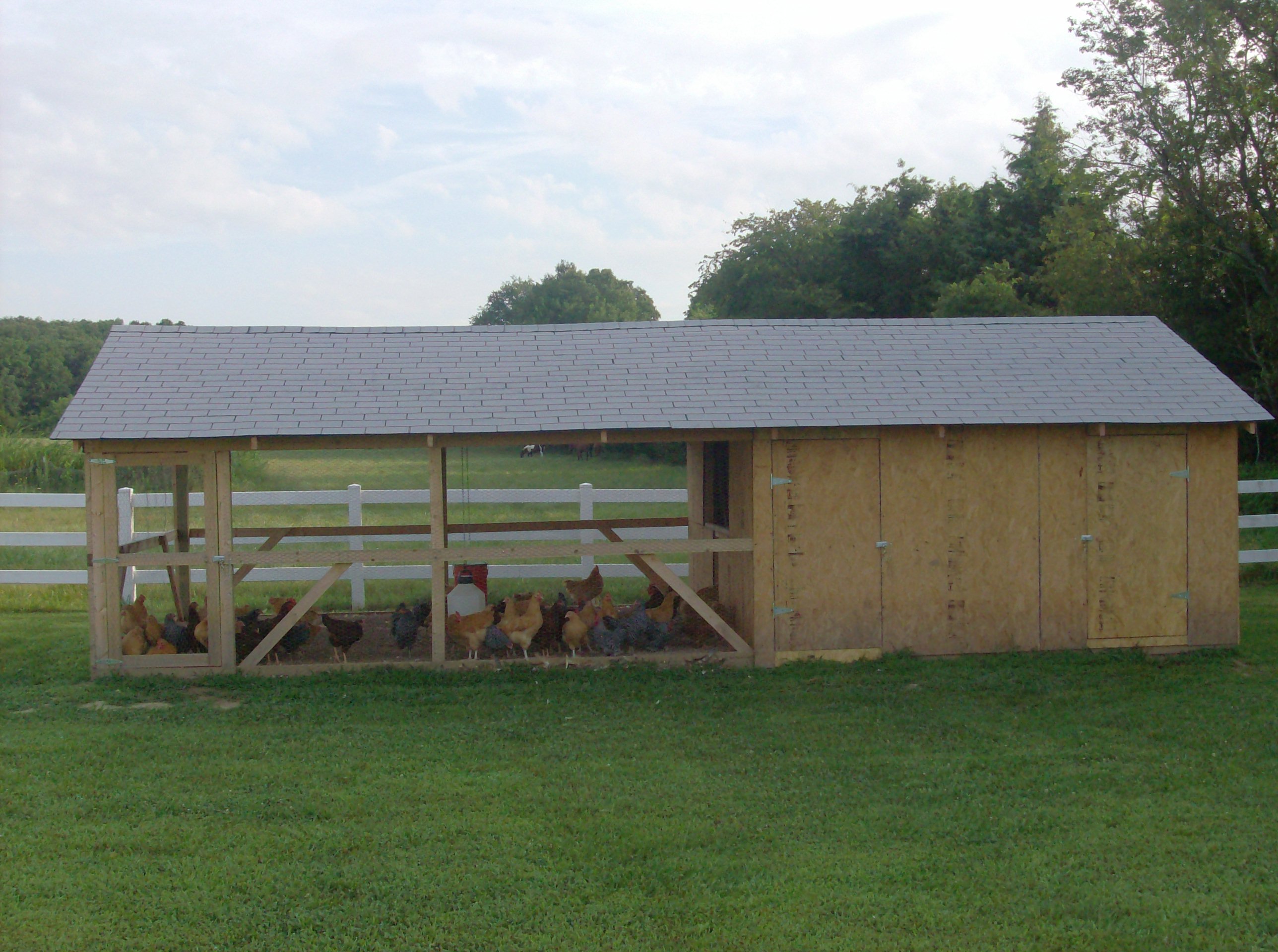

Now, I have to figure out how to design the rafters for the roof. For no reason in particular, I'm thinking of a 6/12 roof pitch with 1' overhang for the soffits and 1' overhang on the gable ends.
I've never used a framing square for anything other than drawing straight lines and making things square. I know they can be used in rafter design, but I'm not sure how to use it for that purpose.
I looked on the web for a rafter design calculator to help me determine length and angles. I've had only limited success with this. The roof rafters may end up being a trial-and-error progect unless someone here can help me with a template or something.
That'a all for now. Will update when the roof is done.

For a small building like what you have built, the simplest roof design is probably the best. You can build trusses, but that's more work and there's really no added benifit.
For a 6:12 pitch roof, place a 2x4 on the center or both end walls so it's standing up horizontally. The math here is really simple for the height of this board. Mesure one quarter of the width of the building and subtract 3 1/2 inches. If your building is 12 feet wide, then the 2x4 needs to be 32 1/2 inches tall. (3ft minus 3 1/2 inches) If your building is 16 feet wide, then the 2x4 needs to be 44 1/2 inches long. This is your support stud.
Brace this with some temporary pieces of wood on the inside of the wall. I just screw in a short piece of scrap to hold it into place.
Now depending on the length of your building, and your desire for a one foot overhang on both ends of the building, place a 2x6 on the top of those two 2x4's that are standing straight up. Lign up that 2x6 so that each end is even.
For exactly a one foot overhang, take into consideration the thickness of your siding and facia board. If you want exactly a one foot soffit, then the overhang should be one foot plus the thickness of your siding past the standing 2x4.
This is your ridge beam. To lock it into position, I like to cut a pair of 2x4's two feet long with 45 degree angles on each end. Then I screw those onto either side of the support stud and up at an angle to the ridge beam.
Now the simple way to do the rafters is to first cut the end off of a 2x6 that is longer then you need it to be. Use a framing square to make this cut or a miter saw. 6:12 is also 22 1/2 degrees, or half of 45 degrees. A 12:12 pitch would have a 45 degree cut, your 6:12 pitch is half of that.
To use the square, and you'll need to use it for your other cuts, lay it flat on the 2x6. Use either the inside numbers, or the ouside numbers. Never mix inside numbers and outside numbers, you only use one or the other. Find the 6 on one end and the 12 on the other end. Line those up on the edge of the 2x6 in such a way that you create the slope you need to cut for your rafter.
It is important that you realize what the angle is that you want to cut in order to line up the square in the right place. For the end cut, it's a simple angle that will give you the top and bottom of the rafter. There are two options here, one will give you a tight fit against your ridge beam, the wrong cut will be a long, shallow cut that wont' fit against the ridge. If you get it wrong, you won't make the same mistake twice. LOL
After you have that first cut made, you can measure for your next cut. You need to measure from the top edge of the ridge beam to the top inside edge of the top plate on the wall. You might need help with this to hold the tape in place, or you can put in a temporare screw or nail to hold the tape at the edge of the ridge beam. It might even be short enough that you can just hold it there and read your measurement.
Transfer that measurement to the 2x6 in the exact same manner that you took it. Hold the tape measure at the farthest point of the angled cut that you already made. Then pull the tape across the 2x6 and to the other side of it, or the bottom side, and mark it.
From that mark, you need to make a cut into the 2x6 so that it will rest solid on your wall. Your wall is probably 4 inches thick with the siding on there.
Use your framing sqare in the oposite way that you used it on your end cut. This time you want a long, shallow cut. Imagine the rafter up against the ridge beam and the rafter resting on the wall. When this cut is made, the rafter will rest solid on the top of the wall.
Draw that line at least four inches long, and measure where that four inch mark is at. If the wall with siding is more then four inches thick, then that is how long you need to measure. Now you can either make a 80 degree line from that point, or use the framing square again exactly like you did on the very first cut. Remember, 6 and 12 on the same side of the framing sqaure.
This is your notch that will rest on top of the wall.
From the bottom of the notch, measure out one foot for your soffit. You can either keep it simple and have an angled soffit, or you can add another piece of wood to create a flat soffit. I'd just leave it alone and keep it simple, but if you want to go flat, let me know and I'll explaing how if you need me to.
At the one foot distance, make a mark at the bottom of the rafter. Use your framing square to cut the end off off the 2x6 so that you have the oposice cut then you have at the other end of the rafter. When in position, this cut will give you a flat line for your facia board. You can also skip this step if you are not going to install a facia board, or if you want your facia board to be at an angle. It's up to you how you want to finish it off.
Check the fit of this first rafter to be sure that it works at all four corners. If it does, use it as a template to make the others. If it doesn't then there is something wrong and you need to find out what's off. If the building is square and the supports are the same height and installed plumb, then the rafter should fit at all four corners exactly the same.
What type of roof are you putting on there? If it's metal, then your spacing of your rafters can be further apart. If it's shingles, then you need to have your rafters at least 2 feet apart, on center so the OSB decking wont sag. Even at 2 ft, you need H clips with OSB.
This is also important in how you will build your overhangs. If you are using metal, then your purlins will create the overhang. If it's shingles, then you need to frame out the overhang.
Either way, you need to cut your facia board from the material you will be using for this.PT 1x6's work, as do a variety of other composit materials that do not rot, but are half an inch to 3/4 of an inch thick. You can use your template for these cuts, but you have to remember that they will be 3/4 of an inch longer then your rafters. That's the width of your ridge beam, and since the facia boards will cover teh end of the ridge beam, they need to be half the width of the ridge bean longer then the rafters. Otherwise, the end cuts are the same, and there is no cutout for it to rest on the wall, since there is no wall for it to rest on.
The space between the rafters is where you will put your vents. Put a solid 2x6 in one space to help secure the raftr to the wall, and in the next space cut out a 2x6 so that you can put a screen over it to allow air to pass through there.
For added strength, you can add a 2x6 to the top of the wall, dead center in the middle of each wall. This will pull the walls together from the natural force of the rafters pushing them out. With the use of a ridge beam, this is minimal on a small structure, but still a good idea for the integrity of the building. It also makes a good place to hang things from.
Eddie
