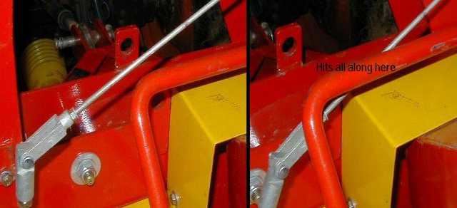

I assembled mine yesterday. A few minor issues and observations. For some reason all of my bearings have only one zerk each where yours has two. I'm not sure why that is. I'd rather have the two.
Another issue is that the feed roller cross connect rod hits the frame when I go to disengage the feed roller. Does yours? From your photos it looks like it might.
Also, on the lift pins, when I assembled the unit I bolted in the bars with the lift pins so they were sticking all the way out which is the way it appeared to me in your photos. When I went to hook up, the drive shaft was too short. I ended up shoving them all the way back. The drive shaft is now connected and I ran it but I'm not so sure it has enough engagement. Did you have any issues with yours?

I'm not sure which rod you mean. There's the lever on top, the horizontal member that connects it to the lever to the lever that disengages the feed roller.
The roller itself uses 2 bolts in the side of the hopper as stops to prevent the roller from being lifted to high. The big heavy frame hits these bolts.
None of my mechanisms hit the frame however. A picture would really help.
My shaft and lift pins are set as far back as I could. Although it looks like there a lot of ajustability there, it's really pretty small. I had the advantage that the parts all had dents in the paint from factory assembly. Made it a little easier to put together.
Jinma assembles and tests everything 1st. Then those for export are disassembled and crated.

</font><font color="blueclass=small">( I'm not sure which rod you mean. There's the lever on top, the horizontal member that connects it to the lever to the lever that disengages the feed roller. )</font>
DIYGuy,
Sorry for the big delay in responding...been kinda busy. Here is the photo. Steel rod hits and is deflected by the red feeder bar over it's entire travel (when it is disengaged).
