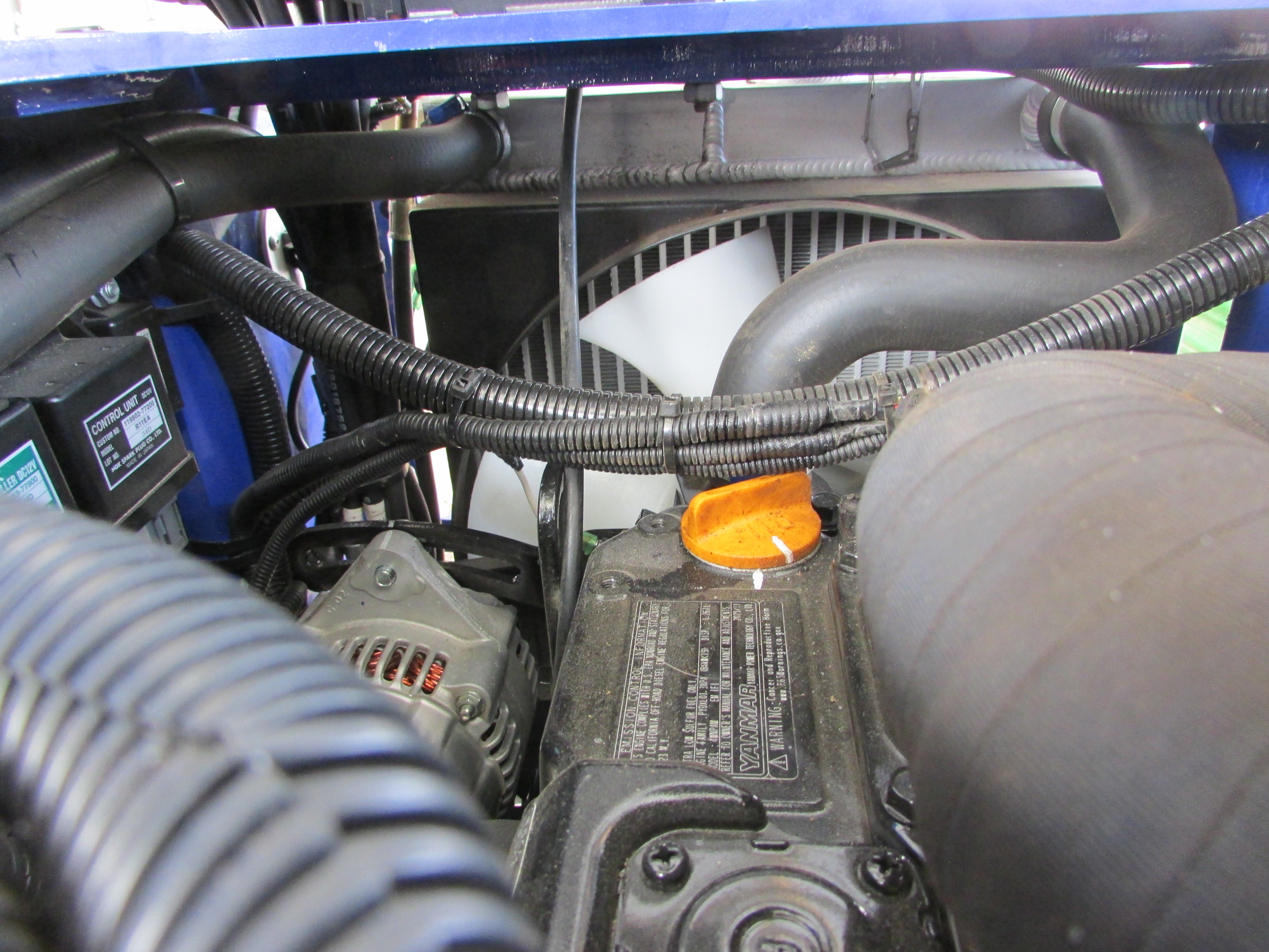

The hydraulic cooler is mounted on the back of the radiator. The hydraulic return line comes out of the top left corner of the cooler - it goes though a 3/4" rubber line with hose clamps on either end - it dumps into the top of the hydraulic tank and the fluid goes though the drop in filter underneath the plate on top of the hydraulic tank. You can see it in the first photo where it runs along the back and turns by the positive post and does to the top of the tank - Also in the second photo top left
The other line I believe supply line is mounted on the bottom of the cooler and starts as a rubber line - transitions to a metal line and runs to the different motors. I did not get picture of cooler side but the other side where it is a hard line is in middle of last photo.

Trying to follow you but you are going backwards in the flow! The pipe in picture 2 above is the top radiator is the return to the oil tank "after cooling".
This line (or preferably the input line to the "cooler" is where you want to install the 10U filter.
The Hyd oil input line to the cooler will be at the bottom of the cooler -so if there is more space, install it there.

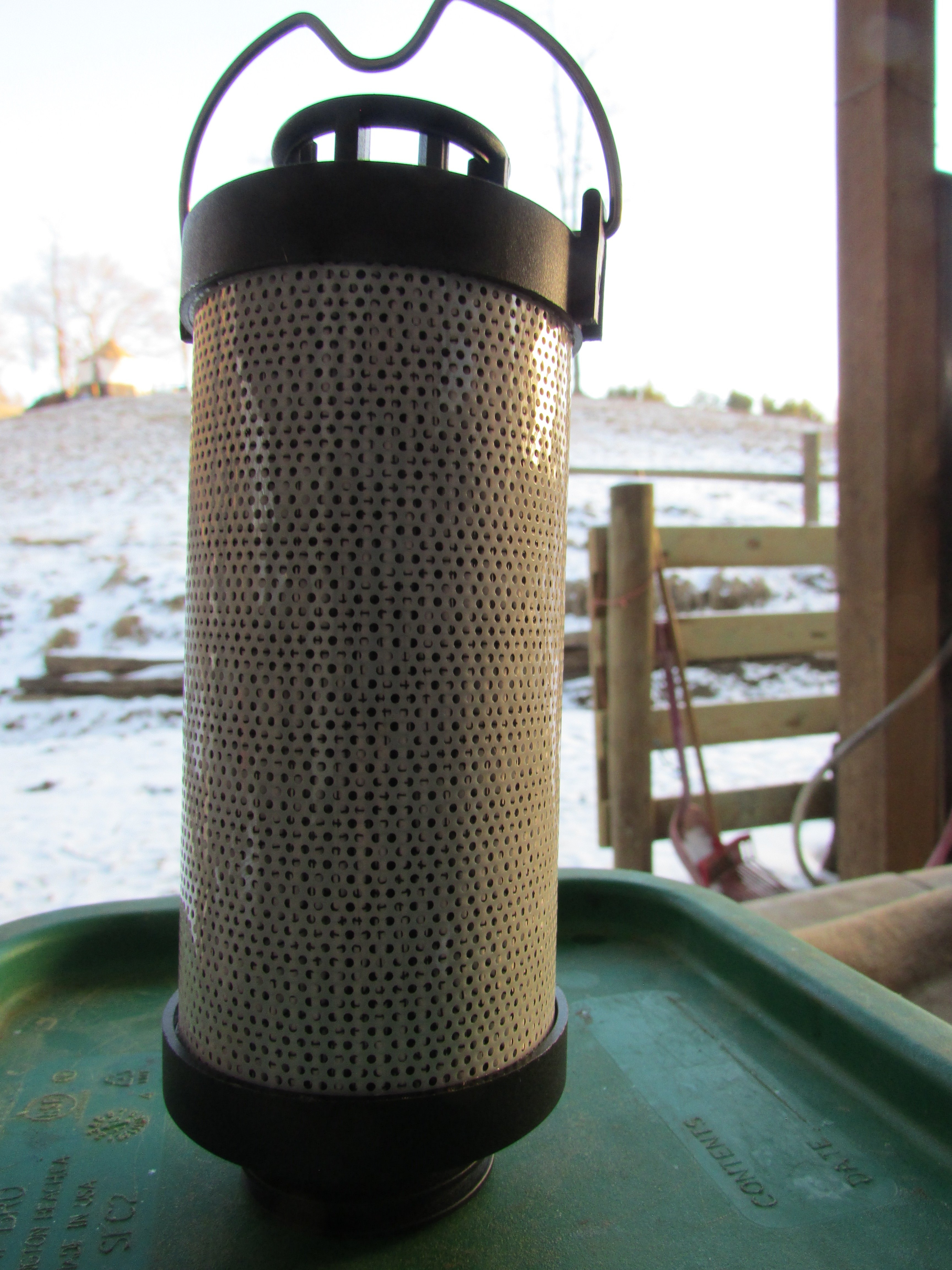

Here is a picture of the Kymron filter which goes in the top of the tank -oil is forced through it to go back in the tank. The filter is screwed on and has a gasket to seal. I am coming on 50 hours and about to change it as recommended in manual.
That appears to be 12" tall by 6" around and if its in the return line as you stated, there is no need for another filter in the return line. Does the filter have a P/N or indication of the specs micron rating etc?

I am almost at 40 hours now! Yeah it's not to hard to work in cold weather as this machine keeps me somewhat warm sitting on top of the engine! My land is a south facing slope with few trees which also helps keep me productive.
The filter is only 2 1/4" by 4 3/4". It is heavy for its size and looks well made. There are no specs on it. I could ask Kymron if they have any specs on it but I am not hopeful on that. I wonder if this is generic filter I could find online somewhere to get specs?
The filter is in the return line - though after the cooler not before.

I can see the paper element thru the holes in the outer casing. That is a fine filter, not a simple steel 100u mesh filter that is usually on the pump intake part of the reservoir. Maybe even 10-microns. But where do you get replacements? KYMRON had better have answers.
The common steel external spin-on cartridge filters will usually have a pressure bypass in case they get clogged, so I do not see a problem with installation before or after the cooler. Your in-tank filter may or may not have such a relief valve. If a 10u return filter gets clogged, then you have a huge problem.

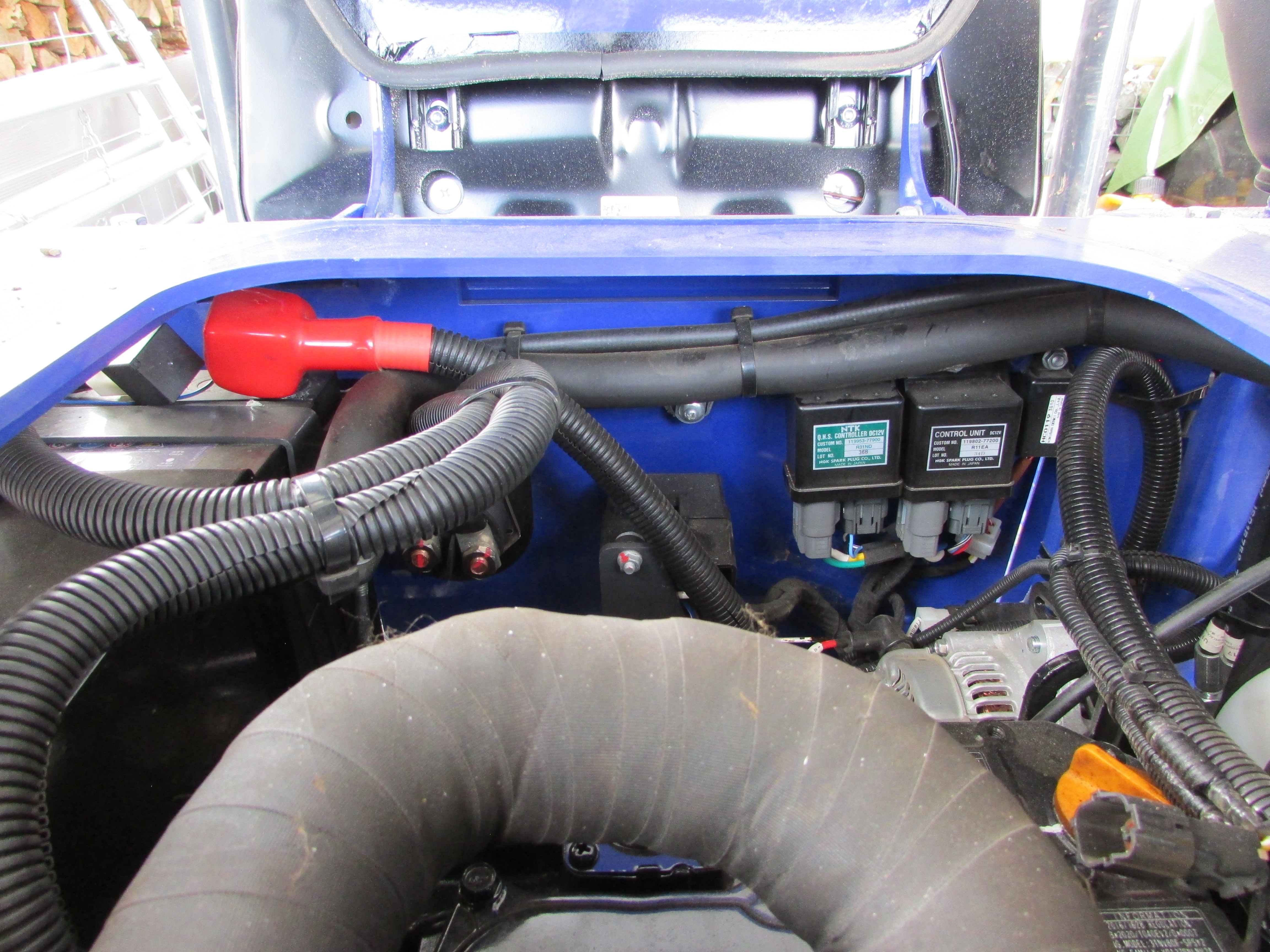

If I couldn't get the filters from Kymron anymore and can't find them anywhere else - Couldn't I just install a spin on type right in the line just before the existing filter? This is the easiest place to install one it seems. I would leave the old filter out if it does not have a RV.
   / Chinese digger recommendations #218
Sure, you could do that. I probably would.
Looking at your last photo, the 2 controller boxes seem to be for the diesel engine's intake heater or glow plugs (QHS controller), and possibly the fuel solenoid. An electrical schematic sure would be nice.
