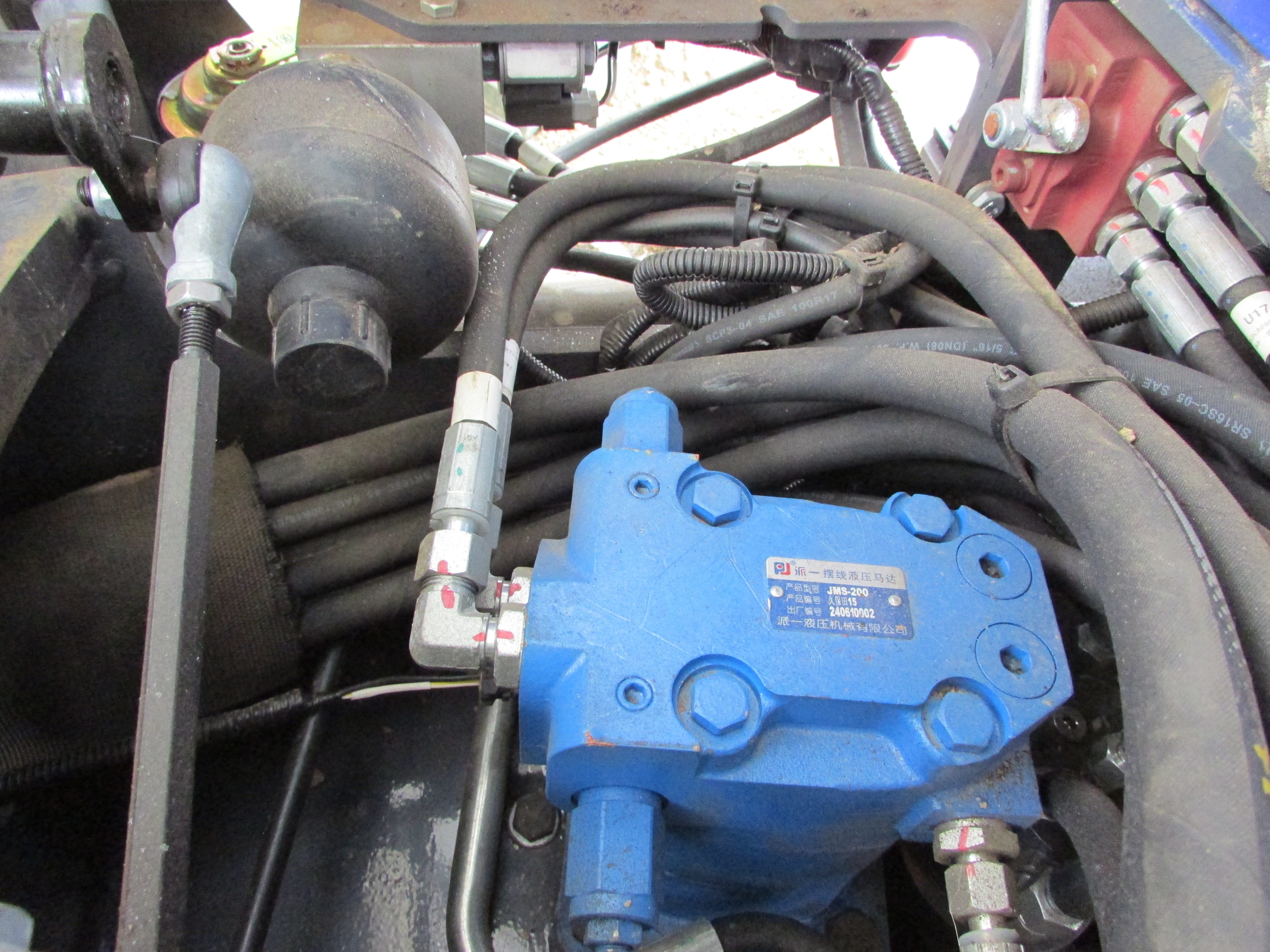

What is it that makes the wheel motors particularly vulnerable without filtration?
Of all the machines I looked at I did not see any with filters on them, including the Kymron ZX22 - Sounds like this is is something I need to consider adding, space is really tight so it will be challenging.
The whole hyd system is very vulnerable to dirty fluid, but variable piston motors (and pumps) are especially so. Worn-out gear pumps and leaky gearoller wheel motor seals have been reported for Chinese minis with no pressure-return filtration.
I would be surprised if the ZX22 has no return filter. But hey, I have been surprised before. Like the Diggit machine I have worked on, it may have in-line filter(s), that are kinda hidden. You really want a 10u easy-to-service cartridge filter.
Get any manuals you can, but you should also do your own investigations.

The manual talks about a hydraulic filter insert that is replaced after 50 hours than every 500 hours after that. The manual states if you are doing hammer work hydraulic oil/filter need to be replaced sooner and indicates percentage.
The manual says there is also a breather filter on the hydraulic oil reservoir.
The manual does not tell me where the hydraulic filter is or how to change it - all service related topics refer operator to licensed Kymron service center.
I will take the panels off again soon and take pictures. If you see where the hydraulic filters are please let me know.

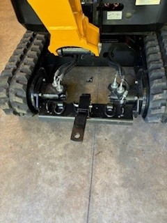

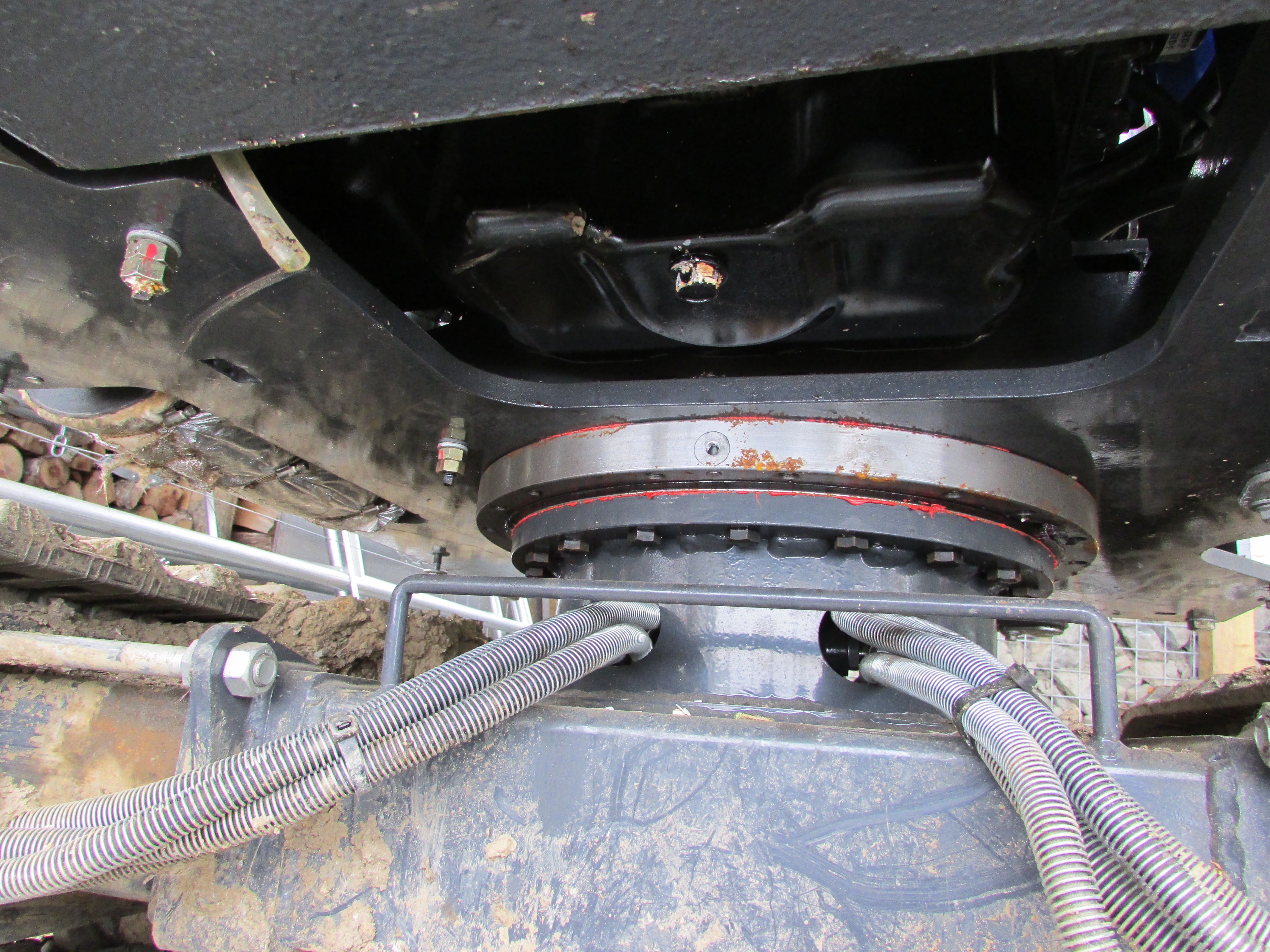

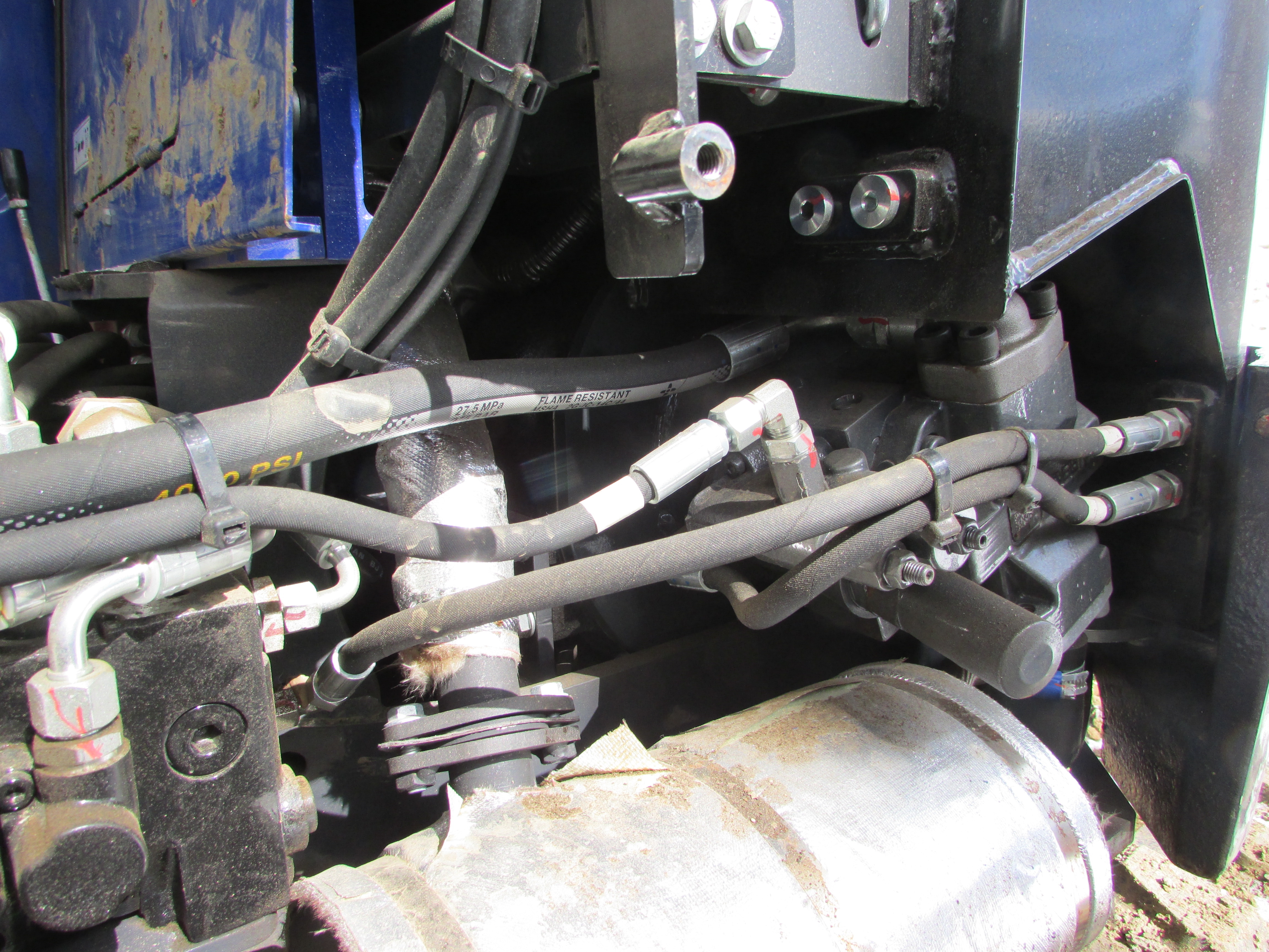

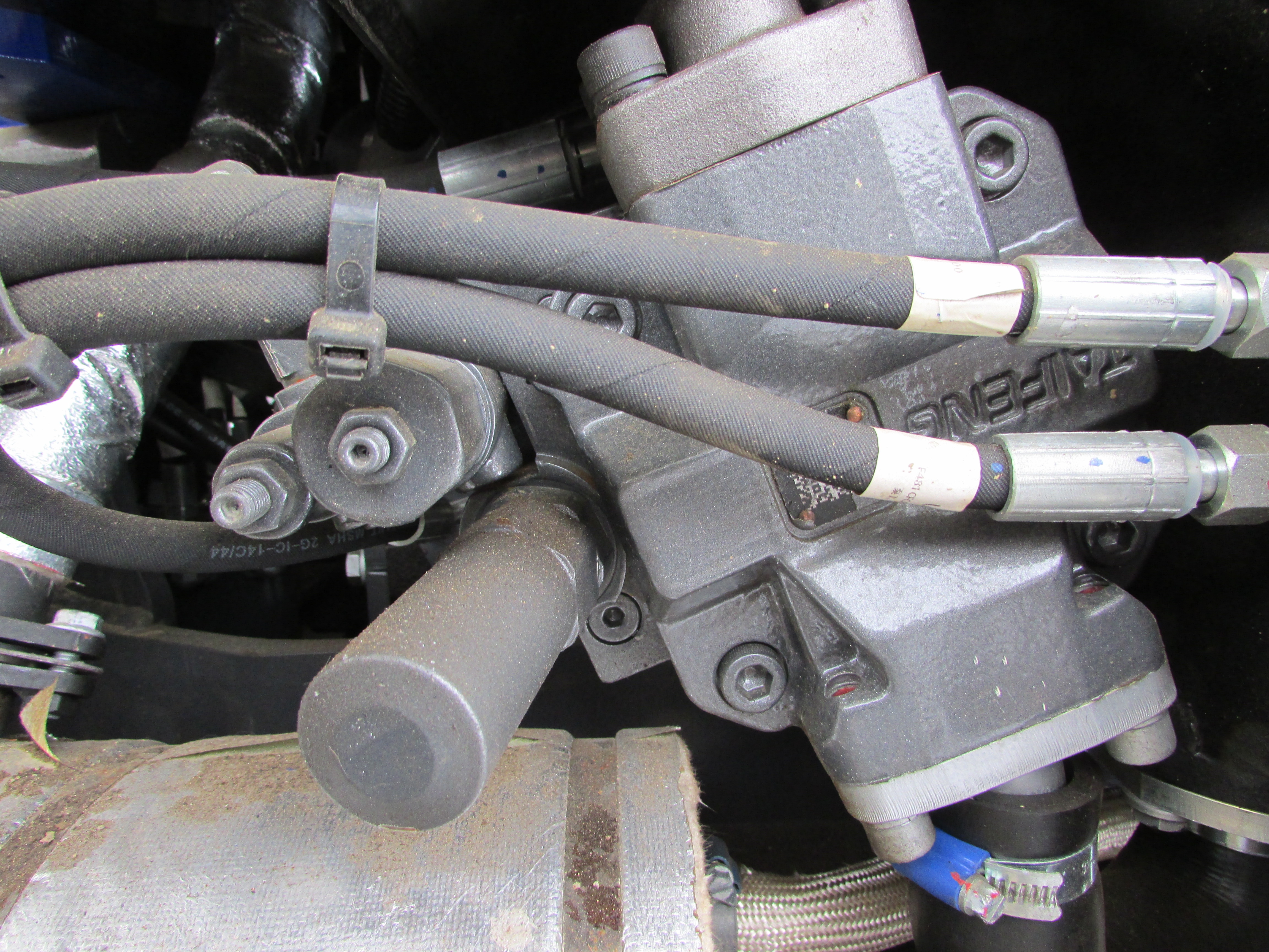

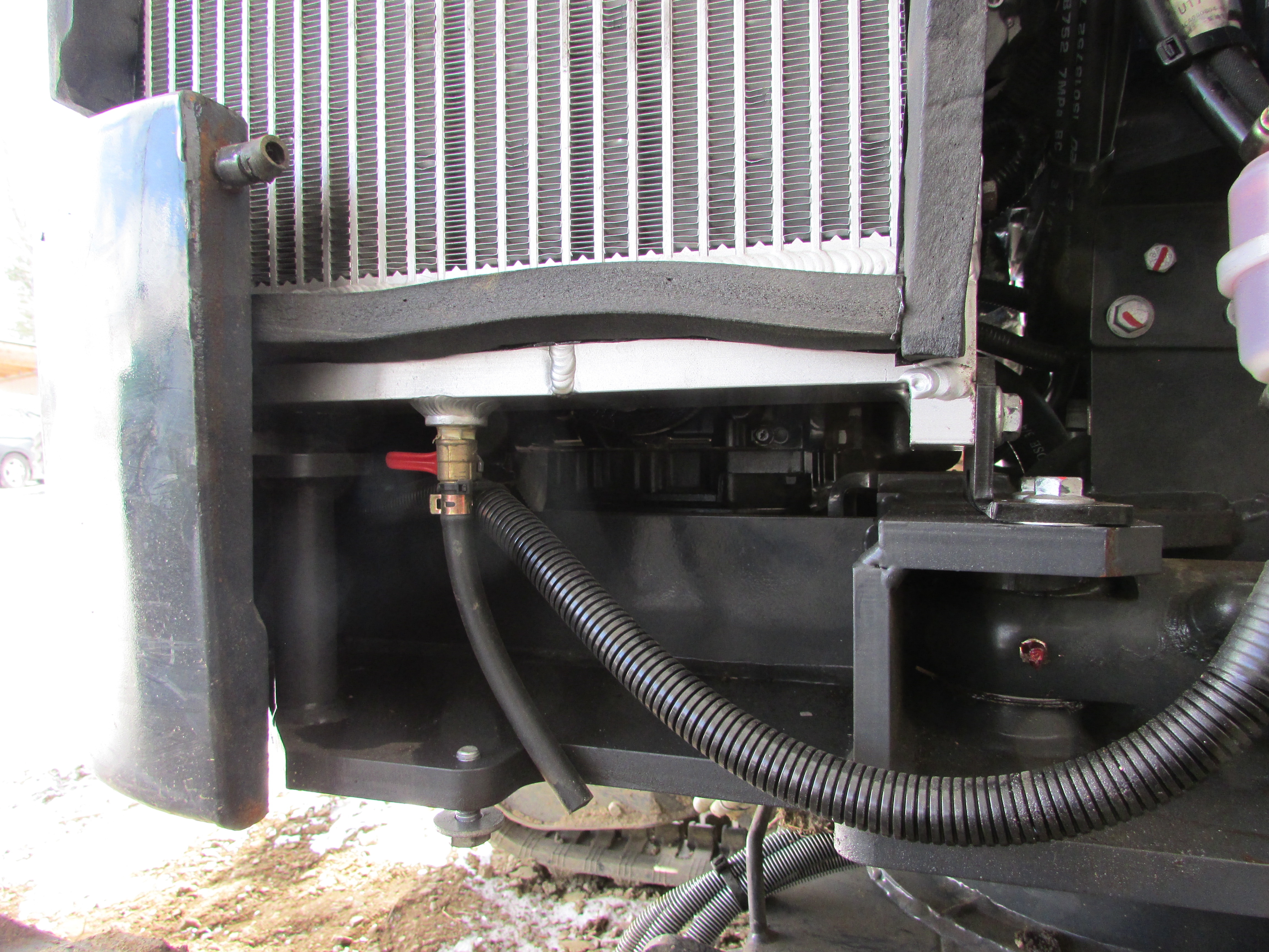

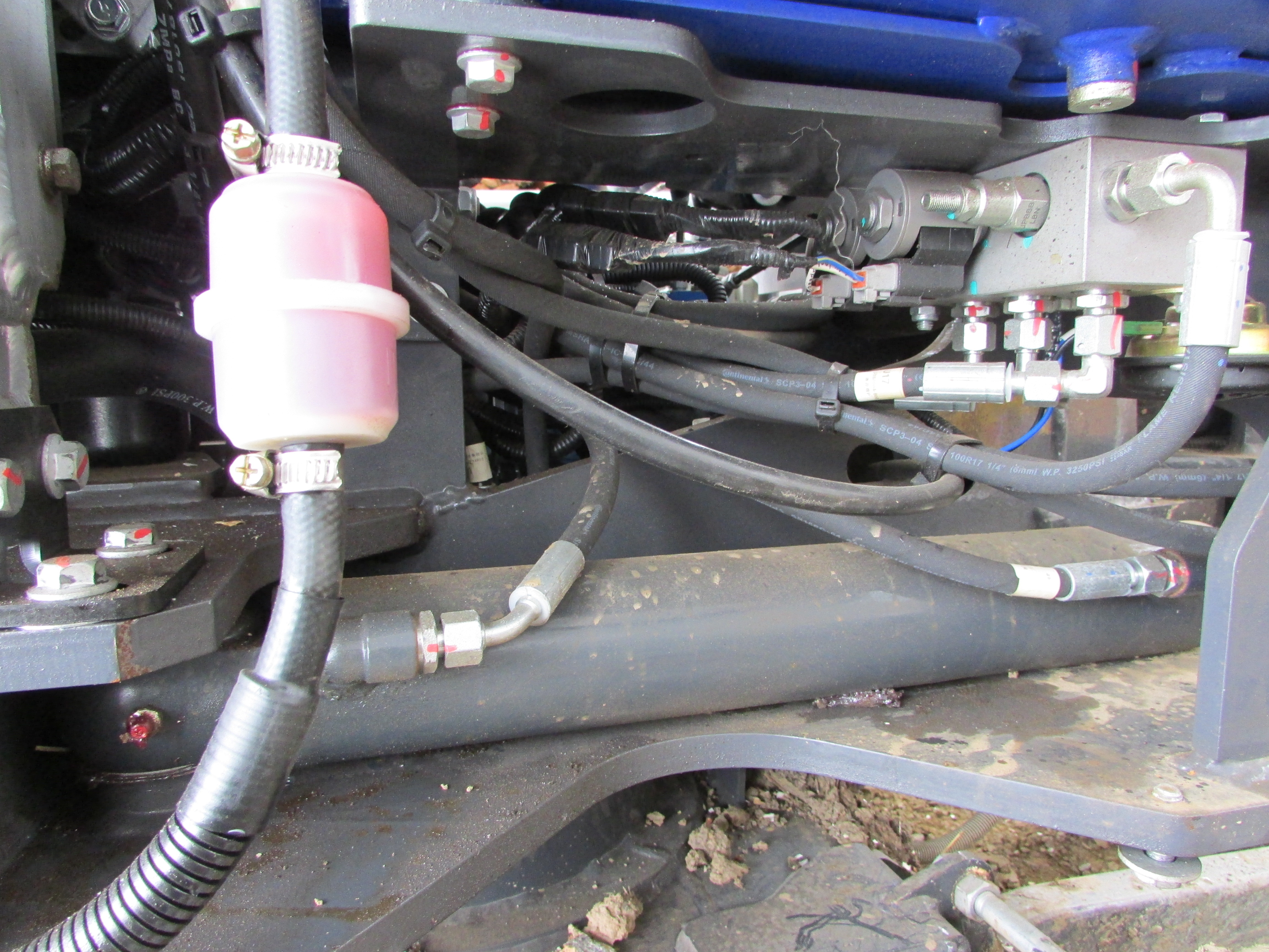

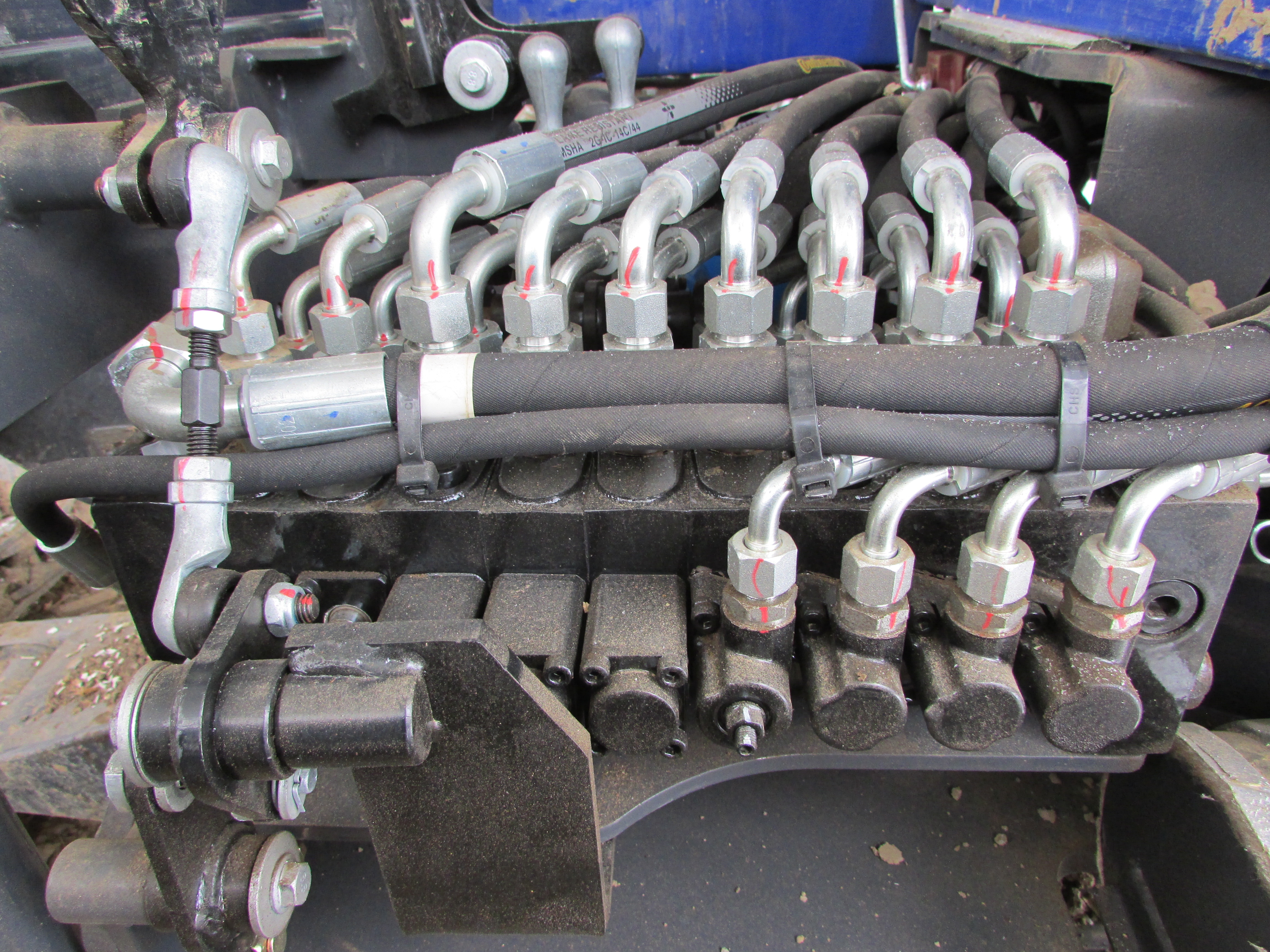

Here is some pictures of the inside of the Kymron ZX22

Nice clean routing of hoses and access to turnstile/slew motor, Also the "house" underneath the machine is totally enclosed with grease on the mating surfaces, The house is rotating on the base frame making it more durable along with the slew motor long term.
These are the things that make the machine cost more to build.

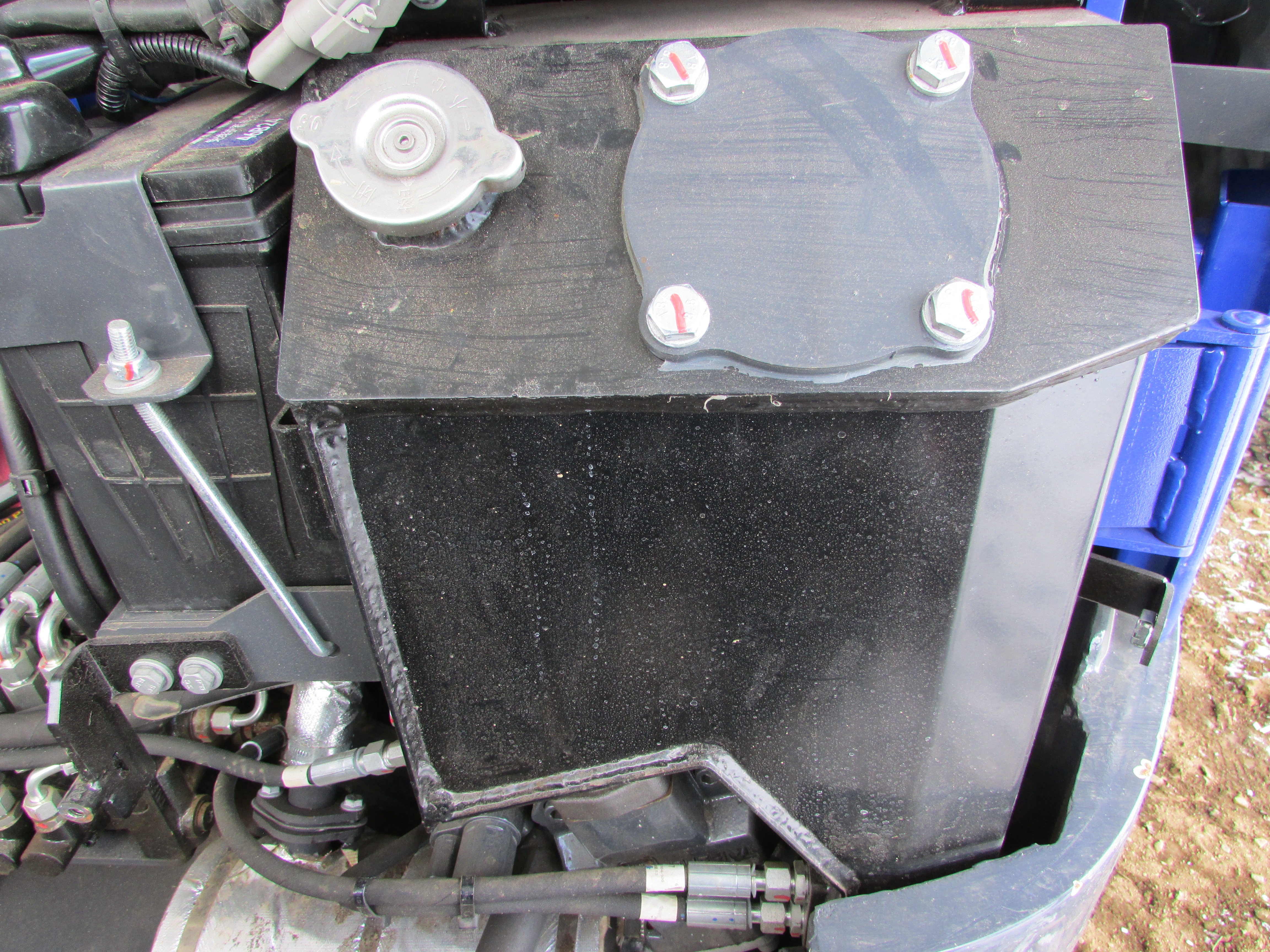

I know you asked about filters - didn't see any in the pics, but there should be at least two and hopefully three. 1- is inside the hyd oil tank, 2, should be one on the pilot controls (small 2"x7") and 3 on the return hyd oil back into the cooler then to the tank.
The in tank one is a coarse 80u intake filter for large particles , the more important one is the in line return oil filter which you should have I would hope on this "pro" version from Kymron.
   / Chinese digger recommendations #199

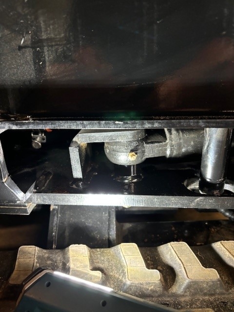

1. - I know that it has a filter inside of the hydraulic tank - It is under the plate on top of the tank.
2. Where would it be in the pilot controls you think? I have not located anything yet. Is the pilot controls the housing where all the lines come together in th picture?
3. How do I know which line is the return line? Looking at the two lines at the bottom of the tank - One goes to valve body(pilot control?), the other goes to the hydraulic pump housing next to the engine.
What would be the best way to go about adding an aftermarket filter in the return line? I thought maybe a filter could go under the cooler/radiator or under the valve body(pilot control?)
