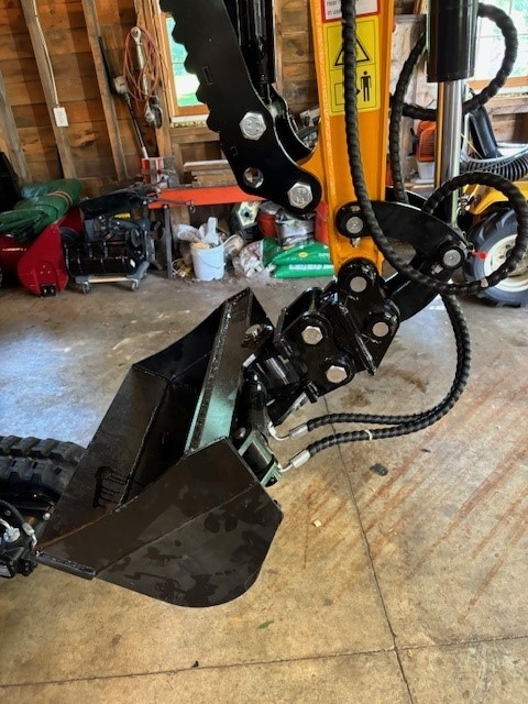

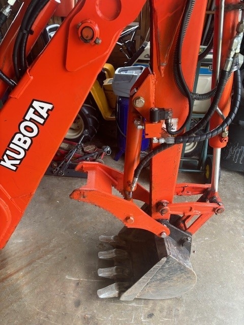

Dunno if you said earlier: have you tried to fit your B21 bucket on the mini-X? Pin sizes are also 25mm, as I recall. I don't recall the dipper stick width.
DF on the B21 its very close - 3.65" width vs 3.6" on the mini, but the pins are 6" on center vs 4" on center on the mini. I only have the 16" BH bucket and the ripper tooth for the B21. Then I installed the Hyd thumb last spring on the B21 making it more work to change.
But I plan to use the ripper tooth on the mini - just can't use the quick attach on the mini - need to pin it on as the 6" on center should be OK on the mini.
I see your thumb shares the bucket pin on the B21. That makes it tougher to change buckets.
For what it is worth, changing buckets or my ripper tooth on my XN08 is super-easy, even without a QA. Much easier than any of my many backhoe attachments. The ripper tooth is awesome.

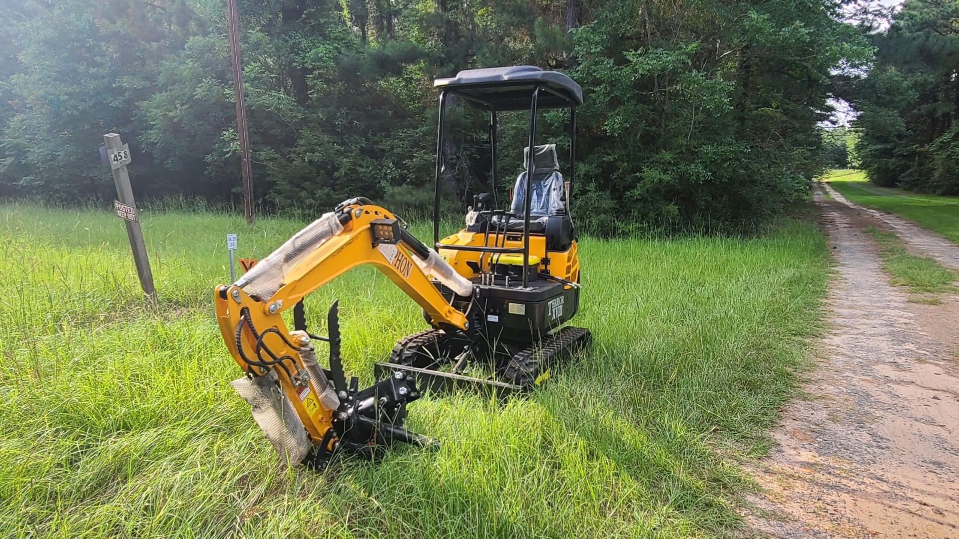

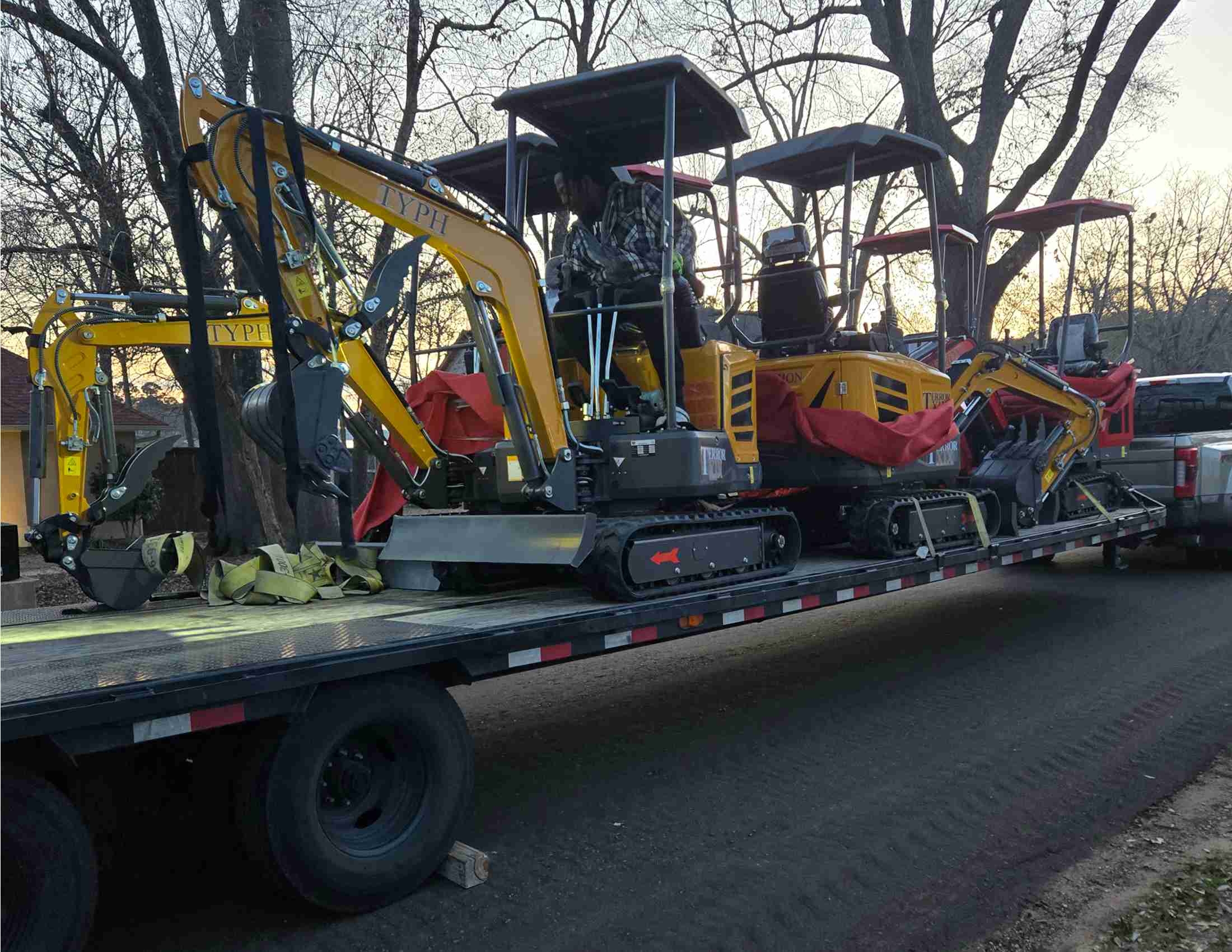

HaHa, well unfortunately life interceded and my plans changed unexpectedly. It was only very late this afternoon that I got a chance to start it up, move things around and loosen up the hydraulics a bit...and yes, it is still cold here, maybe not NH cold, but cold for us!
BTW, I had a really good delivery driver. He kept in contact with me, before he left Cali. with an ETA to my place, to his first deliveries in San Antonio, then letting me know he was delayed by weather, and finally when he was 10 minutes out. When he got here, he unloaded the machine and parked it for me (in the dark). He was a hotshot, and had a whole load of 1 ton and XIX Typhons. After he left my place, he was headed to Florida and ultimately Rhode Island to unload the rest.
Vaya con Dios, Phil!
More pictures to come!
