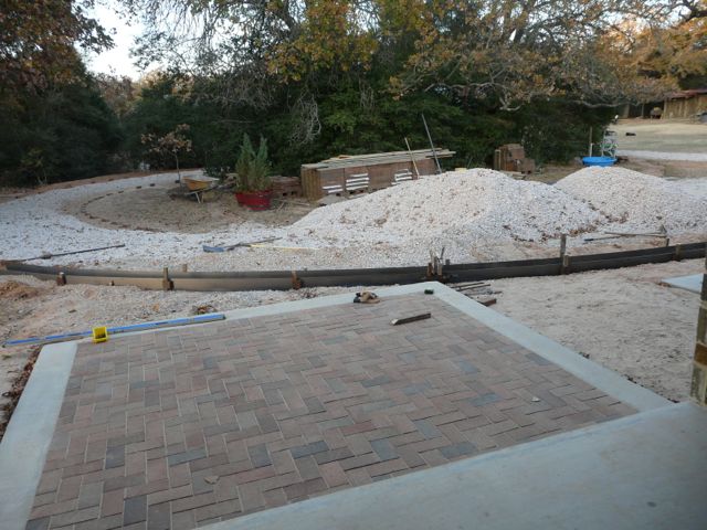

Today I go live on the building of a circular paver driveway in the front yard. The last 18 months I have made the curbings and brought in the gravel.
The pavers are acme brick pavers and are heavier and thicker than the pavers at the box stores.
I have done 2 practice porches using a basket weave design and I think I'm ready to start laying On hand I have 10,000 pavers.
I think I will just lay the pavers straight staggered on the drive, I'll see what it looks like after the fist few feet.
I have put in cross curbing to divide the drive into 1500 paver sections.
To tie the pavers together I will be using polymer sand.
I will try to lay 1000 pavers a week and hopefully be done in 10 weeks. This makes my wife laugh considering I'm already 18 months into this project.:D

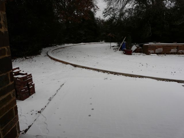

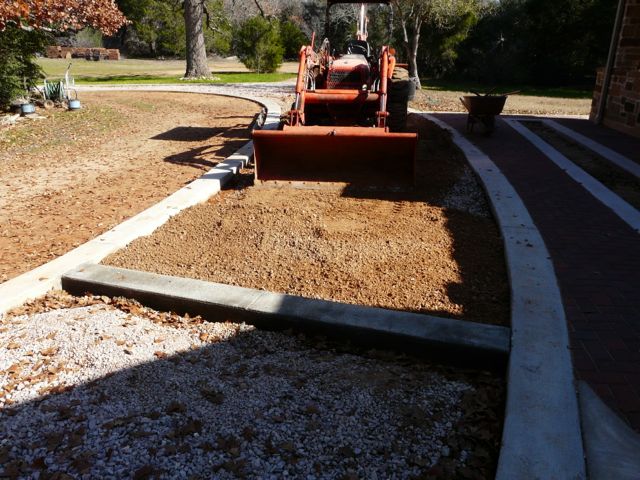

Here are a few pictures of the installation of the curbing.
(the snow is from last year)

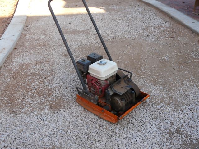

I have one more day of leveling and tamping the first section.
I got this little gem from craig's list.

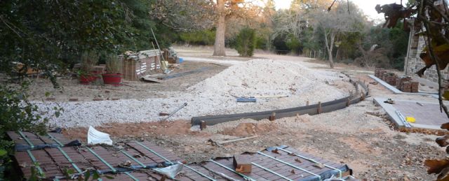

I added a thin layer of sand today to "section 1" and washed it into the gravel. I also finished up the second cross curb to enclose section 1. Tomorrow I will compact again and haul in the final layer of sand that the pavers will set on.
I will be using Paver Set - see photo - between the pavers. It has worked good on the porches, and still looks good after 2 years. It is keeping out the weeds and ants 98%.
The pavers you see on the right are the thinner Lowe's pavers for sidewalks. The Lowe's pavers are easier to lay because of the tapered top side and the protrusions that leave a space in-between the pavers. I swept in the Paver Set between the pavers on the sidewalk. That project was a mere 750 pavers. The driveway pavers are more of the brownish color and the sidewalk pavers are more of a reddish color. Hopefully the different colors, paver placement pattern, and the curbing will keep the vehicles directed on the drive.

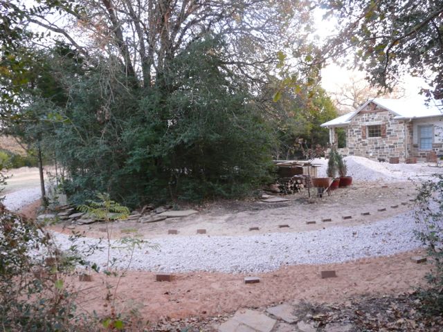

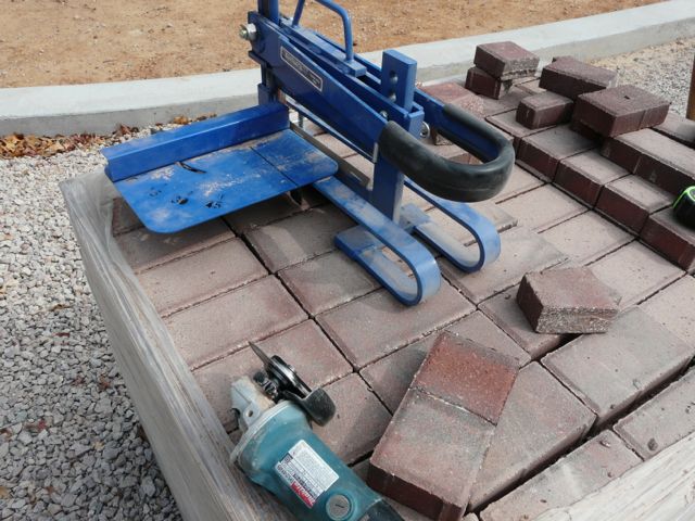

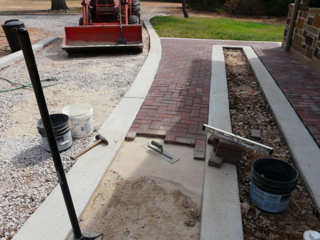

A couple of pics from the sidewalk lay.
The driveway pavers are on the porch at the bottom part of the last photo.

Since the drive-way pavers require a 1/4 inch space in-between each paver and because the curve is so long, I am hoping to lay the pavers longways and have very few cuts.....we will see together how that works out. If we decide to do a different lay all bets are off for the self imposed 10 weeks deadline (which by the way starts 1/1/12).
The basket-weave pattern I used on the sidewalk is not good for curves as I found out by all the cuts required on that one long curved side.

What we would do is layout everything that we could and then spend a day doing cuts on a large job. We would have one person marking, one person running the pieces over and one cutting, the person running would get a workout taking pieces back and forth. A wet stone saw is worth its weight in gold for a job like that. I cant wait to see the finished pics. good luck.
