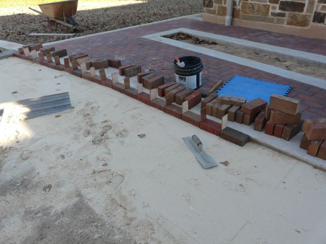

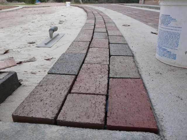

#43
And we're off.
First I smoothed out a layer of coarse sand on about 1/3 of the section.
The first row of paver ended up exactly at 49 pavers. I started the second row with a half paver and now I need more 1/4" spacers.
Section One will be 49 pavers by 29 pavers and I will only have to cut about 30 pavers.

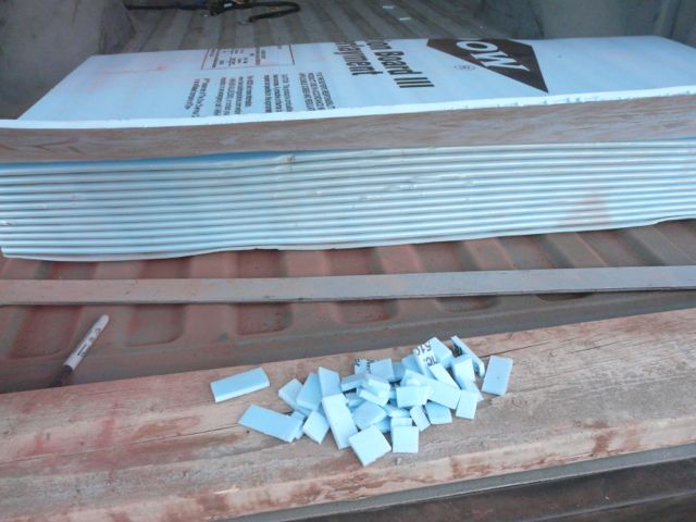

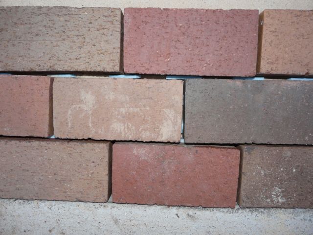

dstig1, the driveway goes around two large oak trees so it is oval. I drove my F150 around in a circle in the field to make sure I had enough room and then I made it a little larger. Since it's not a perfect circle do you want the smallest side's diameter/inside/outside?
I was not satisfies with the wood spacers so today was mostly a day spent at Lowe's looking for something that could be used as spacers. Everything in the tile section was "X" spacers, which will not work, and the "T" spacers were too small.
The perfect spacers are these and I will try to contact them when they are back from the Holidays tomorrow. I need 10 per sq foot, that would be about 22,222 spacers.
http://www.endicott.com/pdf/Endicott_PaverSpacers.pdf
I wanted to get going today so I did get a 1/4" foam board. It cut easy and fast and they seem to work OK, I just have to put 4 small squares down for each paver, kind of time consuming.
I think they are small enough, and I placed them so I can leave them and pour the polymer sand onto and around them.
I can get enough squares from the $42 foam board to complete the project.

/ Circular paver driveway #46
Do you really need to leave the spacers in permanently. I would think that you would just use them to lay out your bricks and then your sand would keep them spaced in the finished product. The man that did my bath tile used the x spacers stood up and pulled them out before he grouted the tile. Could you do the same thing since your sand is like grout. Then you could have spacers that you could reuse as each section is completed.
Rick
#48
Rick
Since the pavers are taller than tile it is almost impossible to remove the spacers unless they are higher than the pavers. When the spacers are higher than the pavers, like the wood was it is hard to check the level over a large lay. Kind of a catch 22. That is why I went with the inexpensive foam board I can cut the 40,000 little squares with a blade at night or when I need a break from kneeling. At 10 for a cent, the price is negligible.
The Endicott paver spacers would be hard to re-use also because they are lower than the top of the paver. The advantage would be speed using 1/3 as many but the price will be higher, I'll find out tomorrow how much higher.
Eddie I skreeded the gravel and now I'm just troweling the sand level and tapping the pavers with a rubber hammer level as I go. As I get father from the level curb I'll try using the PVC pipe as you suggest. I now remember seeing that done on TV, Thanks.

/ Circular paver driveway #50
Don
I vote with Ranger Rick.
If you get a bag of spacers for floor tile that make 0.25 space and use them vertically the height of the pavers is not a factor. The spacers are small enough that you can use 2 on each end and sides for second row and have plenty of space to lay your level between them. You can pull them out easily
and after a short time you will see how they even help you level the stones by seeing if they are cocked or level. I did large floor tile in our TV room, kitchen, and flower room that way 20 years ago and they worked great.
Attached a picture from the net of vertical spacer.
Ron

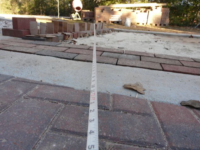

Looking at it again it's kind of like a "R". The "R" has short fat unequal legs and long top part with a slightly curved forward back. The legs are the entrance and exit points. I'll get the inside and outside measurement from the top part of the "R" tomorrow.
#52
The outside measurement of the circle (including curb) is 72' 10" and the inside is 48' 3".

/ Circular paver driveway #54
Thanks, Don. That seems like a good size. Our town requires a 90' dia turnaround for firetruck access, if your driveway is over 300' long. We're over 2x that, so we need the turnaround. I was just curious how it stacked up for size, even though I had a feeling it was large. Ayep, it is...
The other part of my curiosity was the inner dia, as I do not want to pave over a full 90' circle, but make it a ring like yours, so that's why I was looking for the I.D. It is good to get a sense for what the actual dimensions mean.
Thanks again!

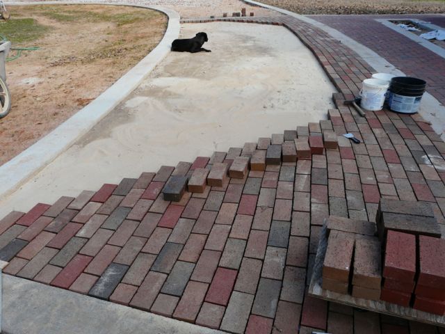

#57
Kyle, doing good, slow but good. I was going to take pictures when I poured the sand today but the sprinkle in the morning made the pavers wet. The pavers must be absolutely dry or the polymer sand will stick to the surface of the pavers making a big mess. By the time they did dry I was busy in the garden and I want a full day for this step, hopefully tomorrow section one, (of seven) consisting of 1300 pavers, will be complete only 10 days behind schedule.
Below is a picture of section one from last week when I was about 1/3 done.
I found about 6 different colors of the clay pavers in the stacks.
