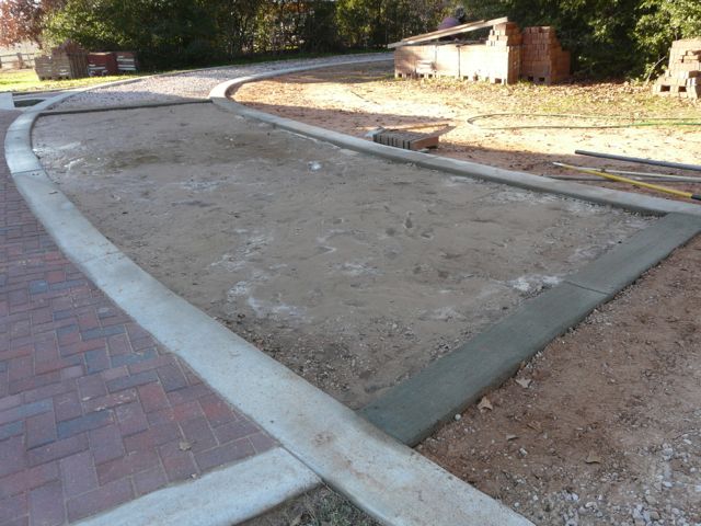

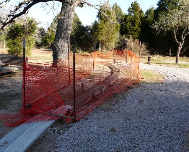

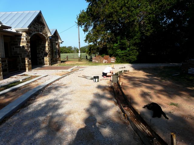

Eddie, the bendable metal frame for the curbing was 40'X6" ( and 8-16" wide). It took a pallet (42 bags) for each section. I used many pallets, I lost count, the curbing took 1 bag per foot. I mixed two bags at a time in my mixer and the 40 foot pour takes 2 hours. The set up, measuring/framing/leveling, took several days for each 40'.
Kyle, The dog did not behave. I had to put up a temporary fence after each pour. On the last pour she jumped the fence, after I had gone in for the night, and it has about 20 permanent dog paws indentions.

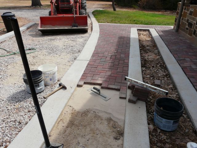

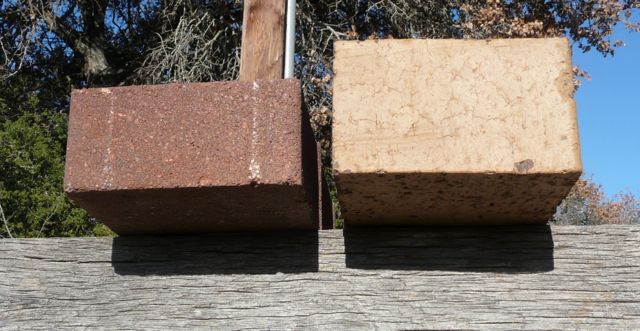

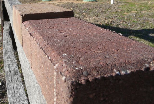

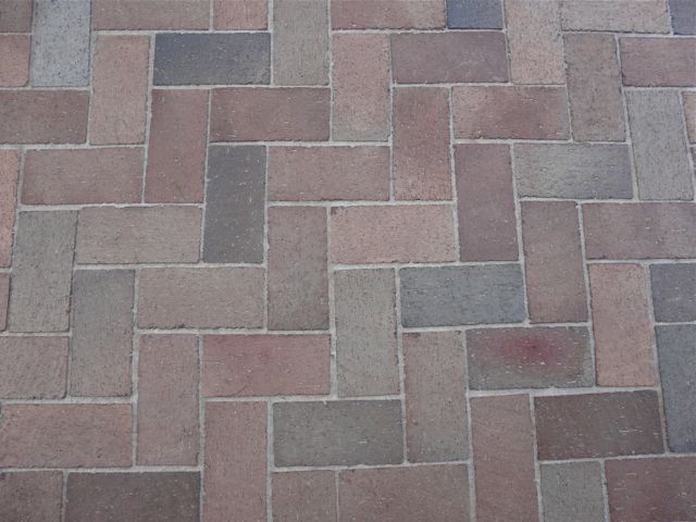

Here are some pics that show the difference between my drive way pavers (thicker) that require 1/4" spacing and Lowe's sidewalk pavers (thinner) that have side protrusions and the a beveled top that require no spacing.
The last picture is the front porch with the 1/4" spacing driveway pavers filled with polymer sand that has solidified.
She just wanted to leave her mark "In Stone" for all that snake protecting she's been doing.:laughing:

I see the paver difference now, Don. Still not quite sure why the ones you're using couldn't be jammed tight against each - Would the corners break? Sand wouldn't fill in between them?
Uneducated comment, It appears that one is cement and one is clay?

GT2, I believe that is a correct observation! The Driveway (Acme) pavers are clay based.
Beepington - That is exactly right, the edges would break, or cause a tripping hazard if not perfectly aligned and there would be no space for sand when they fit that tight. The 1/4" sand space becomes the bevel.

Don, I see you have rebar in your curb. Do you have some verticals in the pour every once in a while that go down into your sandy ground or are you
depending on the weight of the concrete to control lateral shifting and or frost heave?
A vehicle's weight operating in that tight curve will create a lot of force toward the outside. Your doing a great job and the design goes very well with your house.
