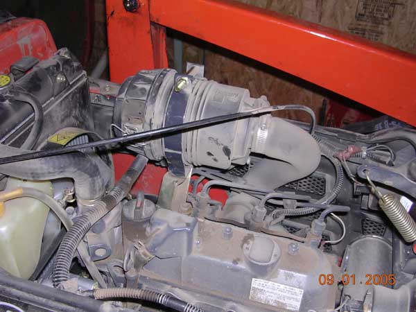

Were the original air cleaner brackets plastic? My BX is a year old and the bracket is metal, and looks pretty sturdy. The attached pic shows it. Gotta run, I see there is something that needs tightening. /forums/images/graemlins/smirk.gif

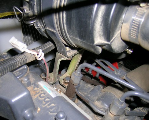

My 2003 BX-22 also has a pretty thick gauge of steel holding
on the air filter. If it did crack, it would easily be welded.

The air cleaner brackets on your tractor and the previous poster's both look the same as mine - and mine cracked. The place where it cracked is just around where the bend in the bracket is at the bottom ( where the flat mounting surface is that goes against the engine the bracket then angles up.)
Frankly I think the broken bracket is something you might easily miss. I noticed my tractor making some funny noises one day and because of the stuff I had seen here on TBN I started looking under the engine compartment - and saw the broken bracket. Since it doesnt really affect the functionalit of the air cleaner I just kep using it like that for 100 + hours.
