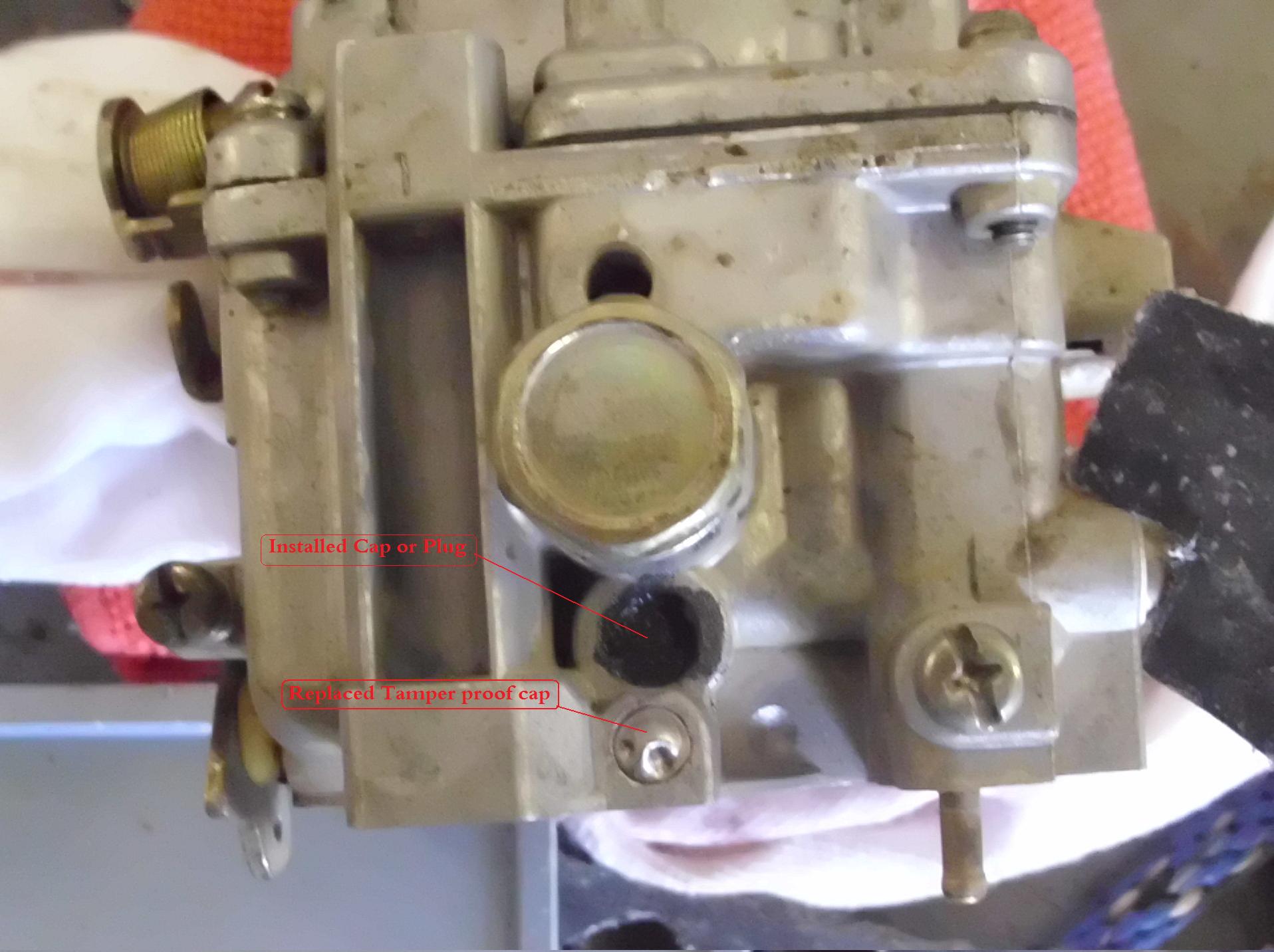

Why replace the tamper cap? Now you cannot adjust it. I did not know of this cap when I cleaned mine. I guess I missed something.
To keep me from tampering with it again. LOL

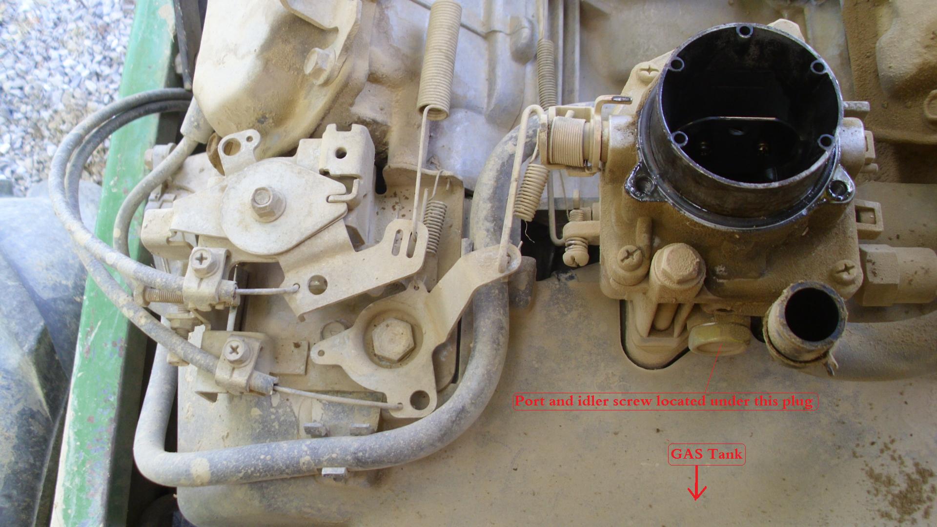

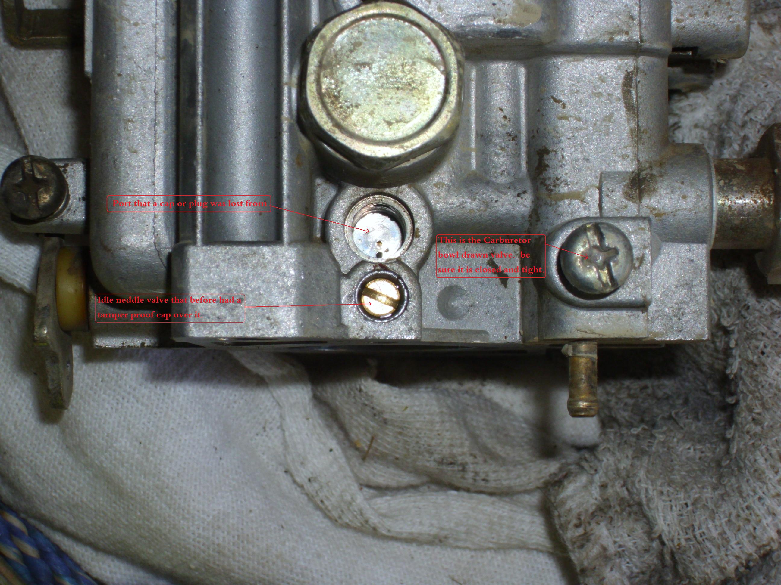

My PT 422 2003 model Robin engine started loping. Pretty bad this time. Any way to make a long story short I found that a plug or cap must had fallen or come out. I had cleaned and took apart and blew out but nothing helped. And then I noticed a port that look cleaner than it should be especially when it was below and outside the air filter. With the engine running and it loping as it was I reached in and put my finger over that exposed port. Low and behold the engine smoothed out and ran like new. Here are some pics to help explain.
Ya it is. On top of some old asbestos gasket material.
