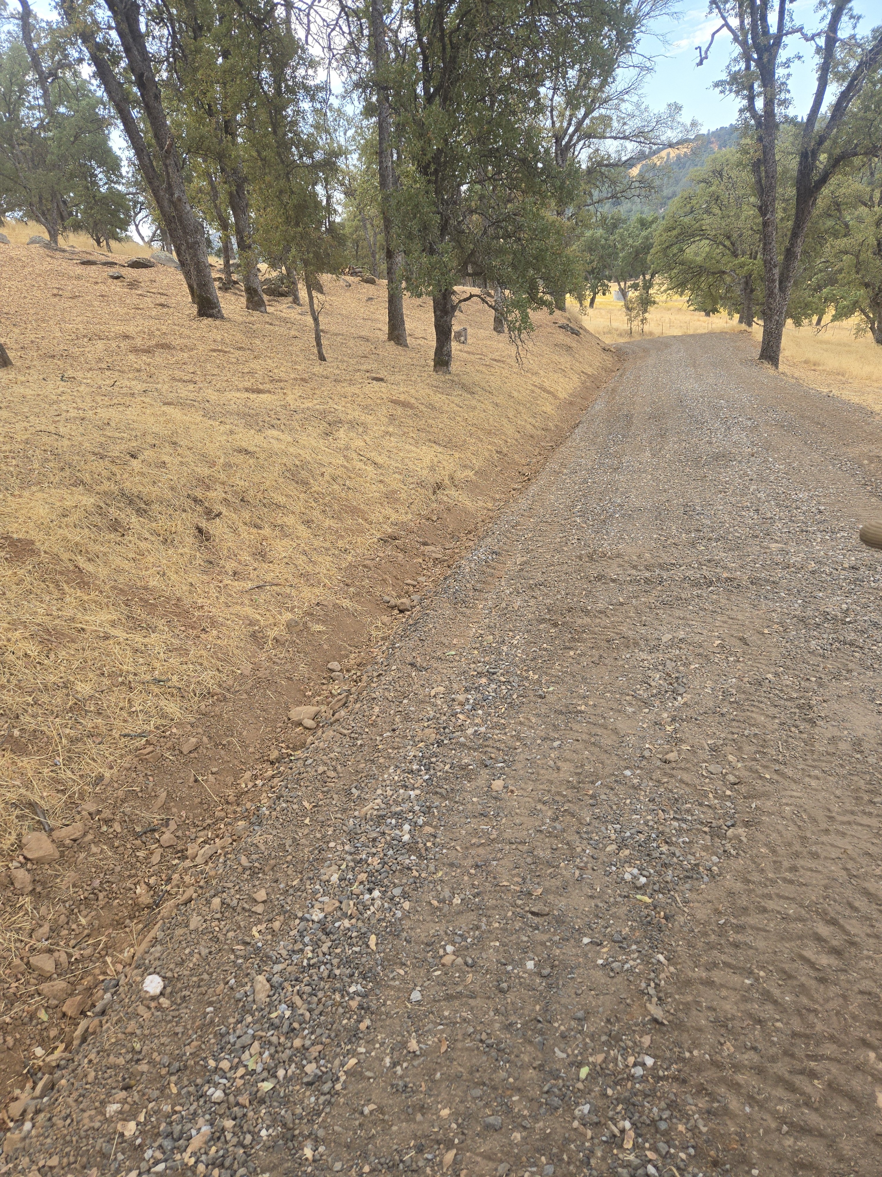

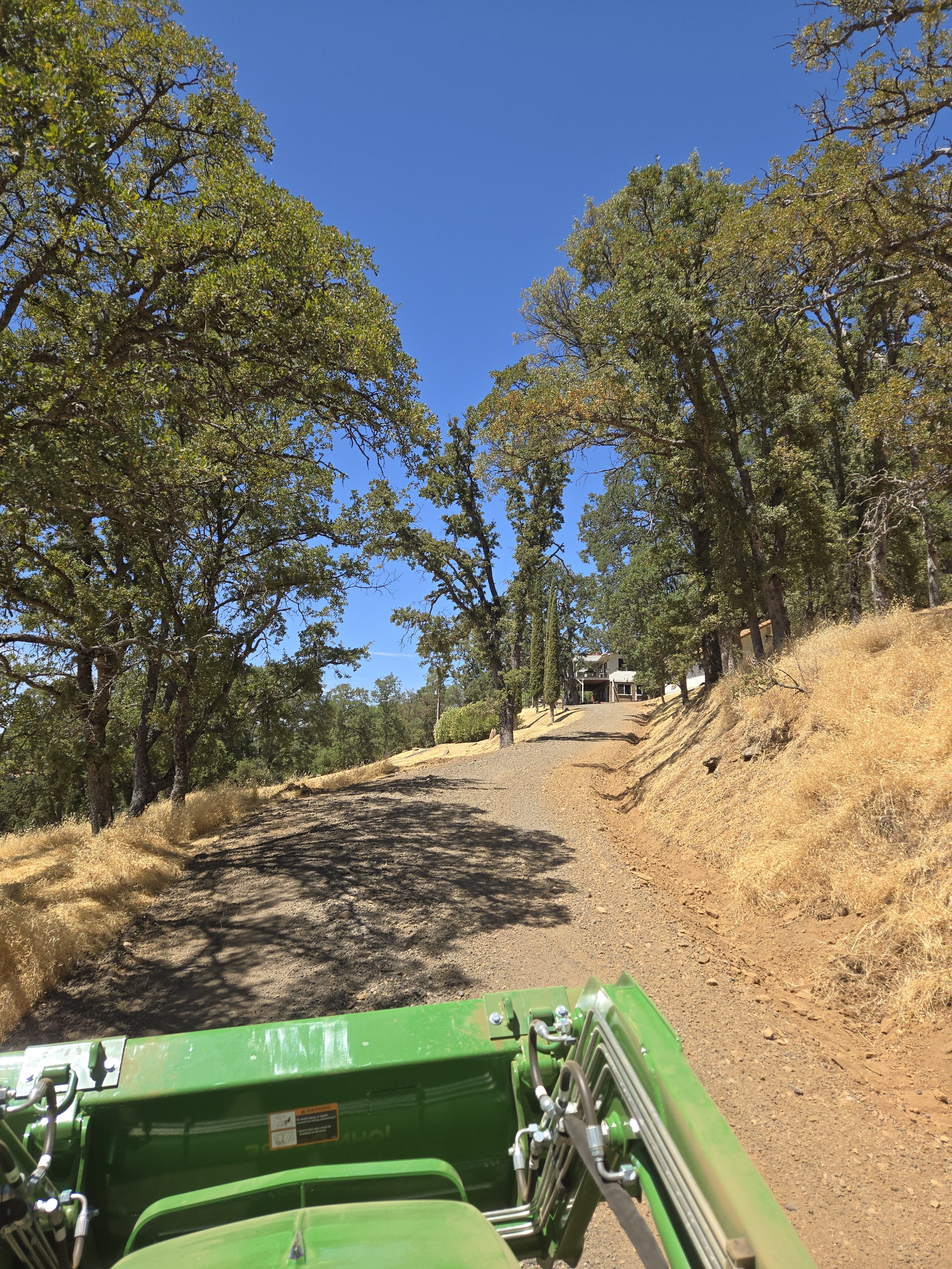

I'm a newbie, but my first project for my new tractor was the same, but maybe 1/8th mile. I used my 5' box blade, tilted all of the way to the left side down. Also dropped the left scarifier all of the way down. Then used my new JD 3038e to clean, deepen and widen the ditch. It took several passes going downhill and I took out a couple of bucketfuls of rocks, but came out nice. I had to put both left tires into the ditch, but that worked OK too and probably helped with compaction.
Not bad for my first project, right?
