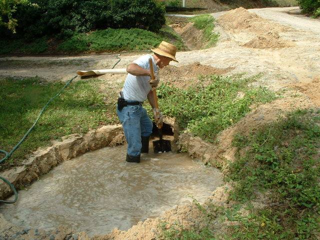

I have a similar problem with the culverts at the end of my driveways. The county's sand wants to always fill them when we get a hard rain. If I dig out enough of a ditch to let the sand flow it ends up in my woods. Or my neighbor's woods. He doesn't want it, either.
I have to have a sump on the downstream side. If I keep it dug out the culverts stay clear but one hard (2 inches in an afternoon) rain and they're plugged. Even then if I get the hole dug out that day there's enough water in the sand to make it flow. Let it go any longer and, well, I'll show you a picture...

Looks like you need a larger culvert, at a steeper angle and rip-rap the inlet like I explained above.
