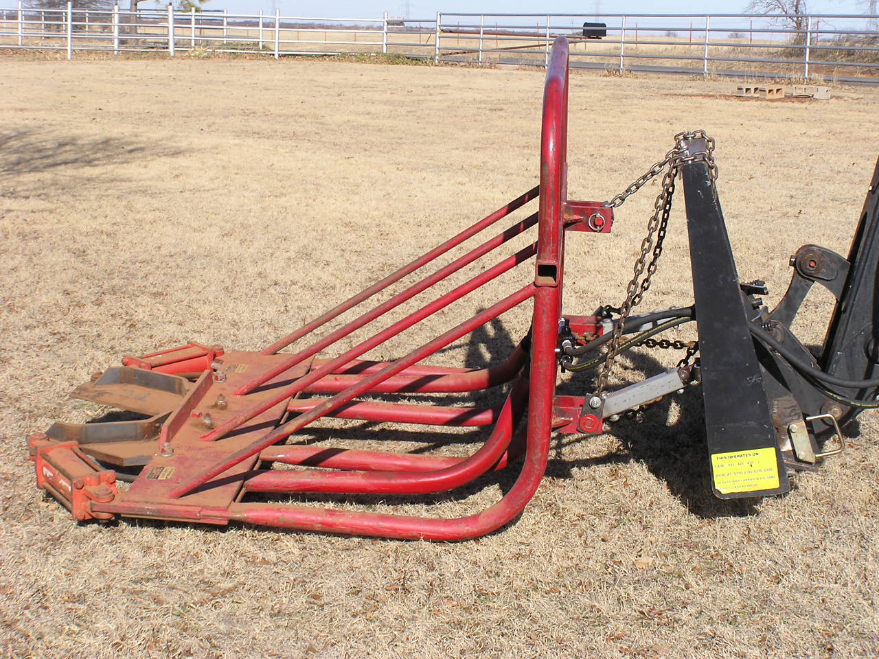

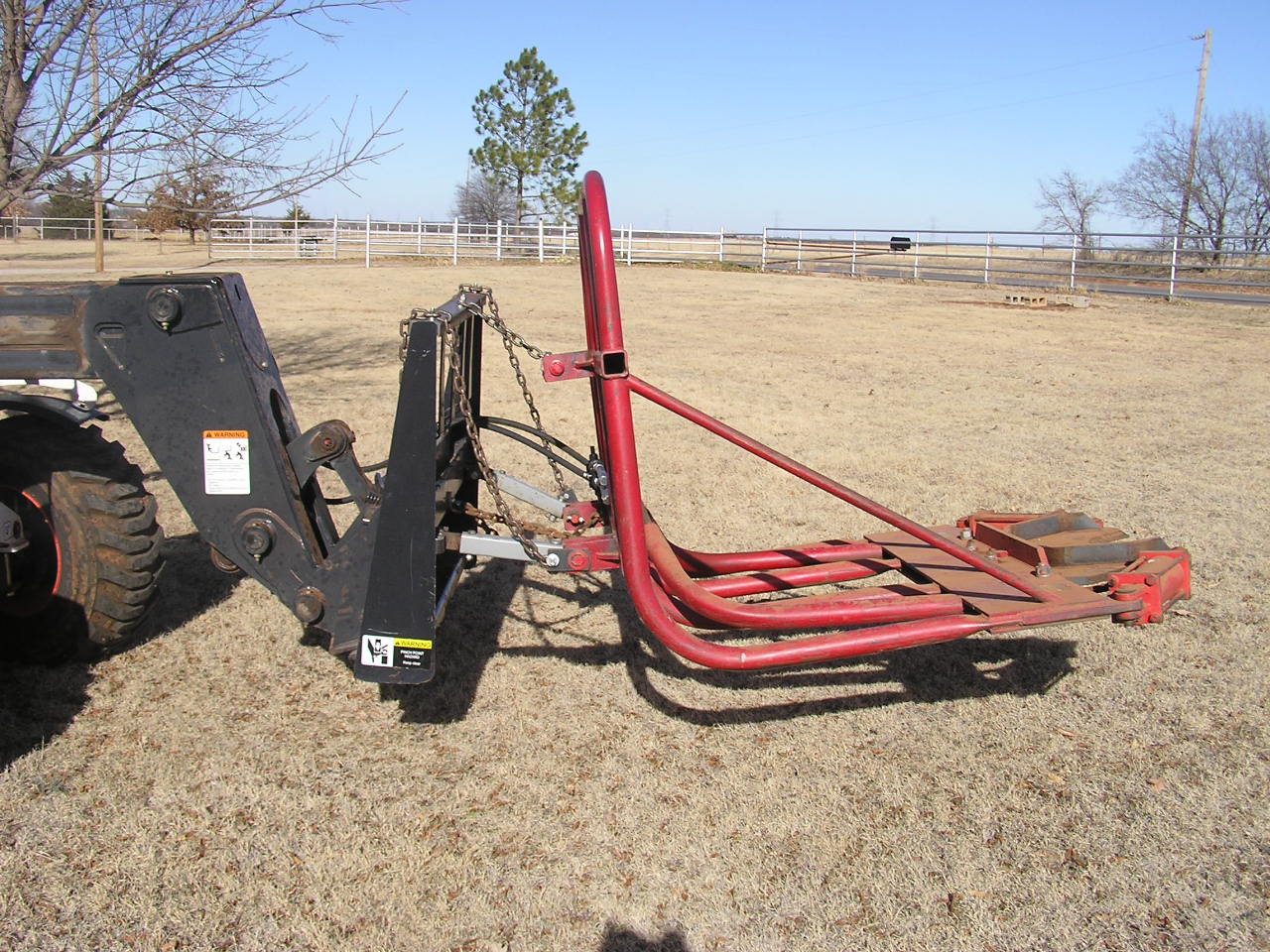

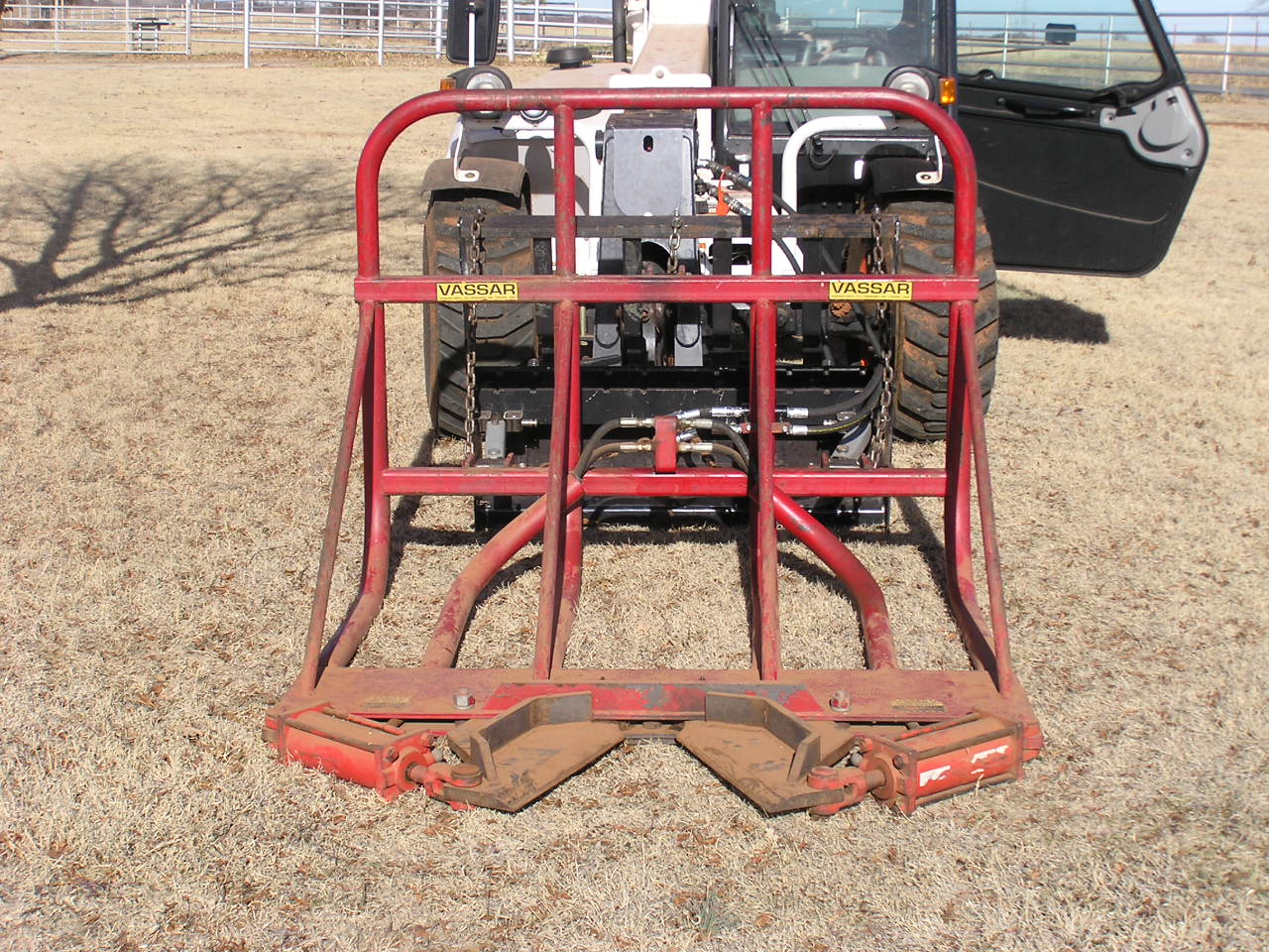

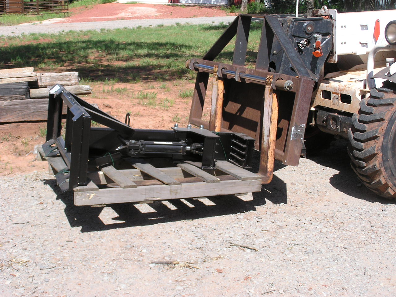

Here in central Oklahoma, many years ago, I started cutting them with a 3 point cedar tree cutter on my tractor. Notice how it is made to reach under the low branches and cut the trunk at ground level. After I sold the tractor 4 years ago, I made an adapter, and put the cutter on the Versahandler. So much better out front.
Cedar Tree Cutter 1-7-2011.JPG Cedar Tree Cutter (2).JPG Cedar Tree Cutter (6).JPG

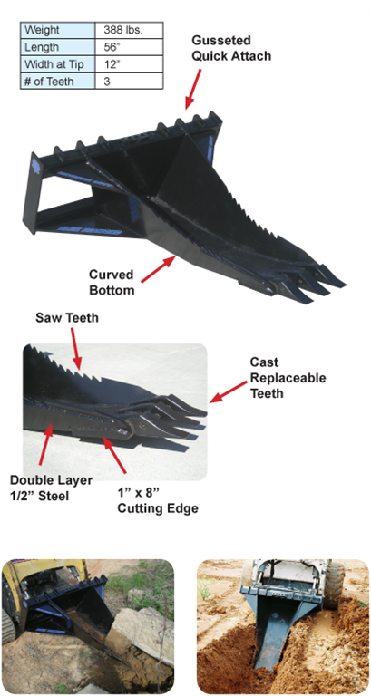

Another useful tool is the long narrow stump bucket.
Pops them out quickly

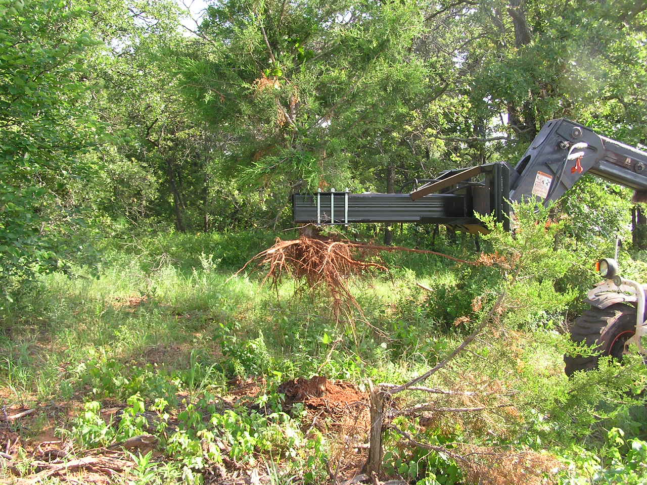

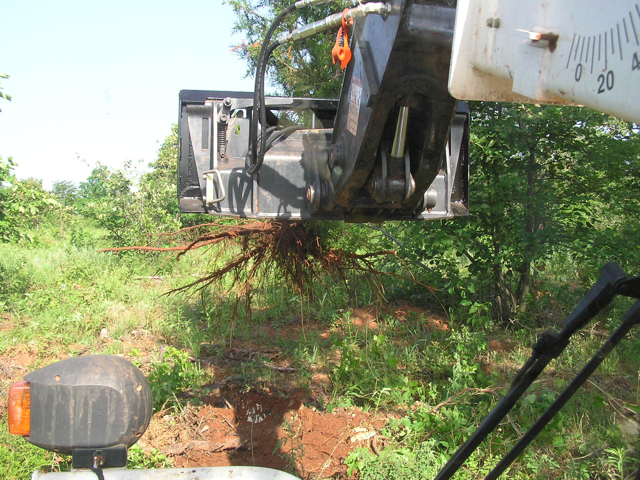

My favorite tool for trees up to 4 inches is the Buckthorn Long Arm Tree Puller.

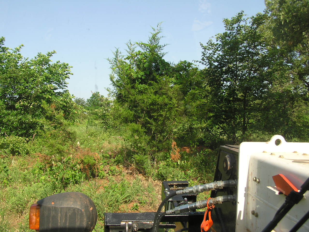

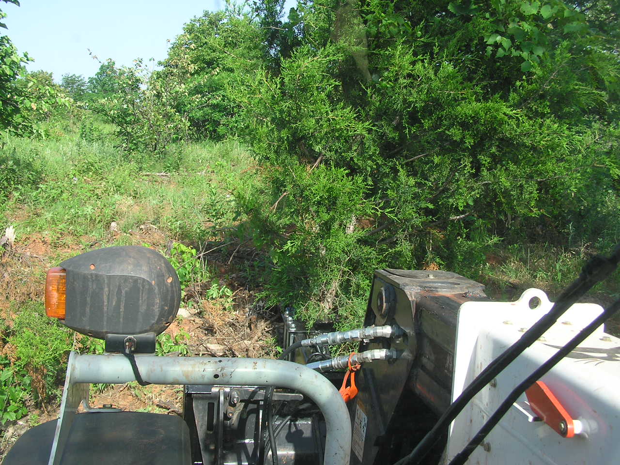

The view from the seat.
The big cedar: http://www.tractorbynet.com/forums/attachments/277824-tree-puller.html#post3444397
