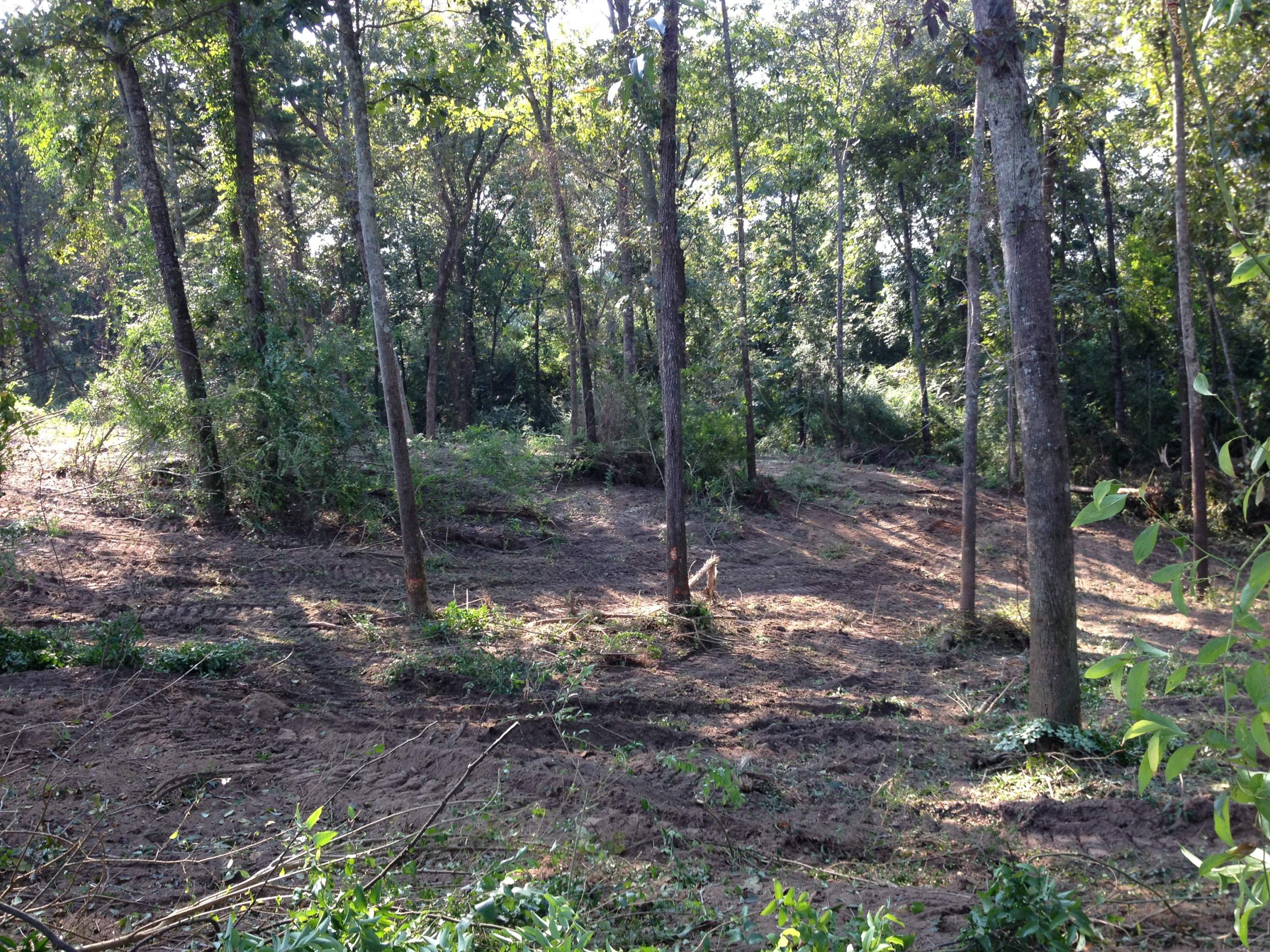

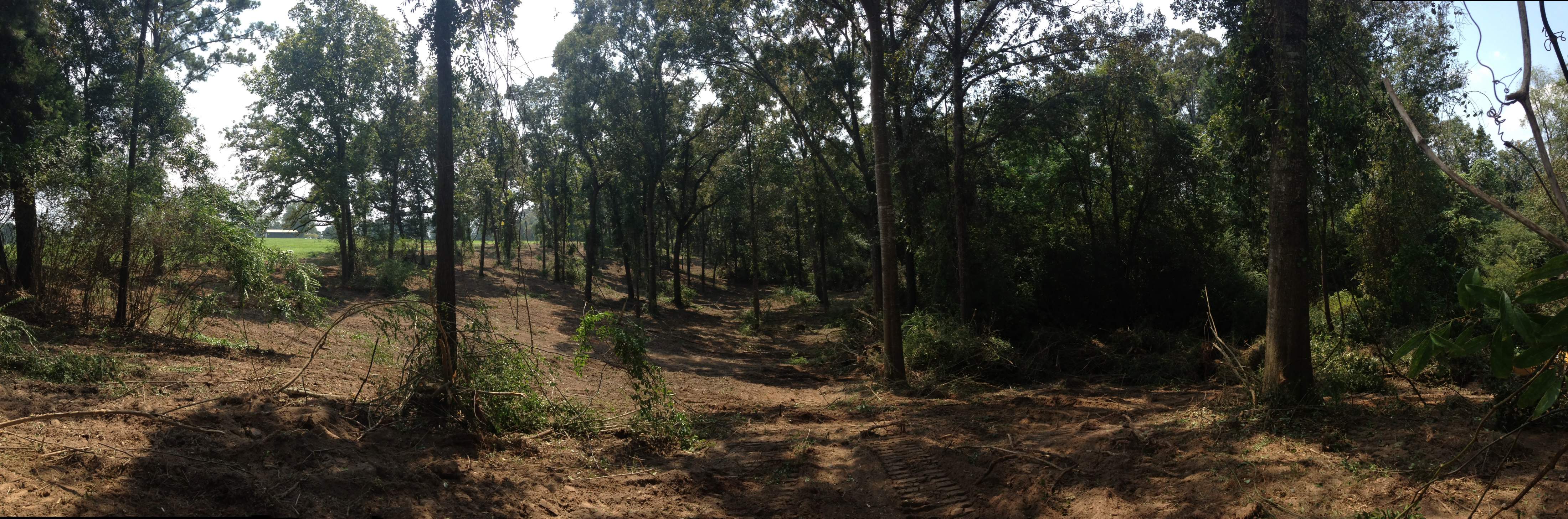

I think I did pretty good, job totaled 3 acres and I had it done in a day and a half

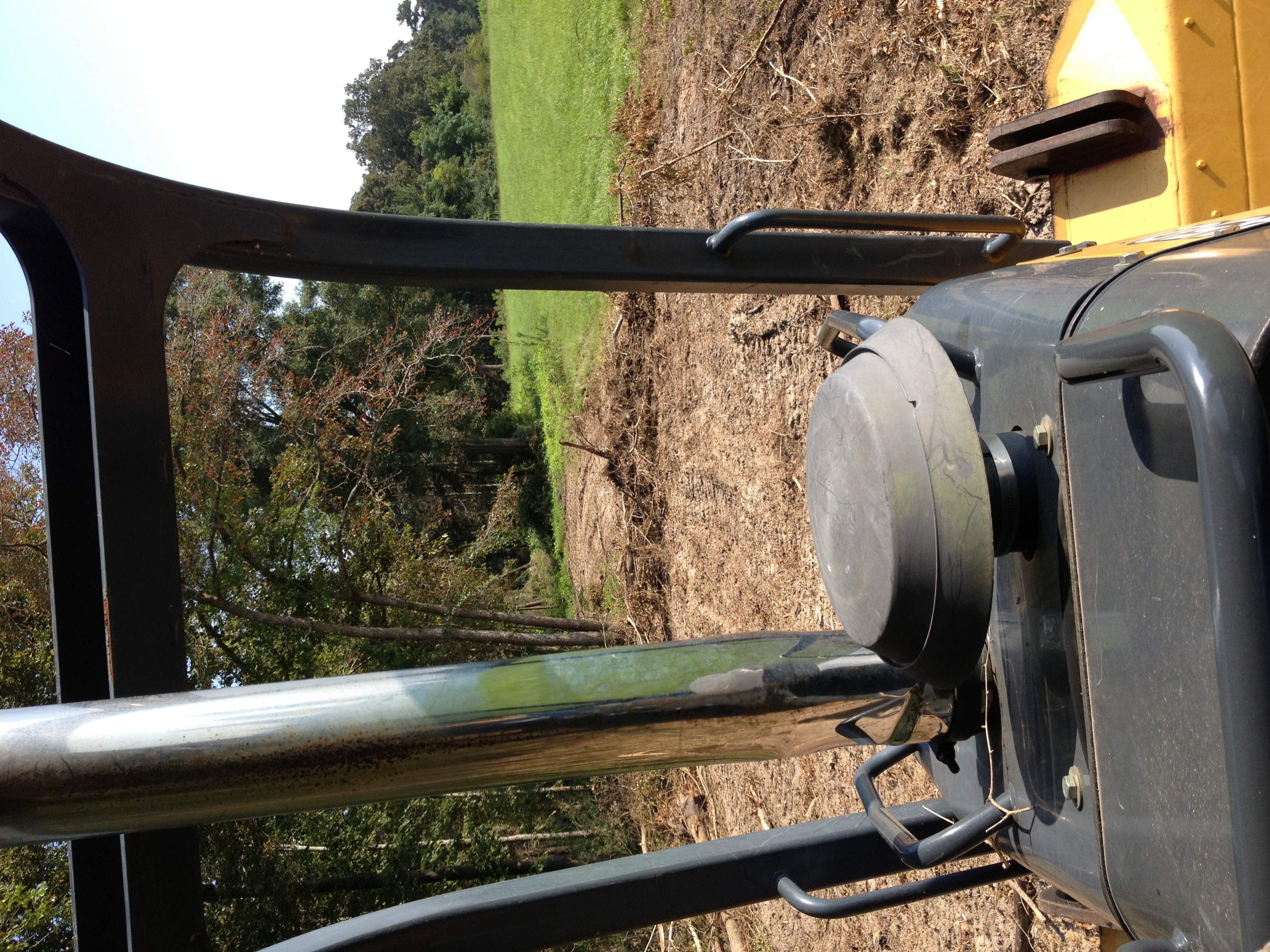

Have you ever come across a good precleaner for a deere. The case's have a great one and keep the air filter cleaner longer. I'm having to clean out the filter 1-2 times a day on the 450j. Granted it is terribly dry and dusty but its rediculous.
Brett
Donolson Power Cores are pretty impressive filter set ups if you wanna change up your factory design. I swear ive knocked over 5lbs of dust out of one before that was still not pulling a filter minder closed.
   / clearing land #26
Is that the one that has the clear bowl and you just knock the dust out if it every so often? Those work great and keep the filters cleaner alot longer..
Brett
