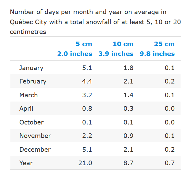

What part of Quebec?
Here are snowfall amounts in Quebec City.
   / Clearing snow (3 kilometer long wood trail) #4
How often do you get 1 foot plus snowfalls?
Not very often, from my perspective, a one foot plus snowfall is a lot. The snow falls we get are more like 3-4 inches maybe 5-6 times a month. And then maybe 2-3 times a year a bigger one that would get closer to the one footer.
