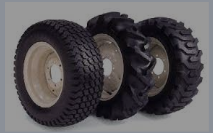

I've had R1s, R4s and Turf tires. The turf tires did better in the snow than I expected. The R4s turned into racing slicks in greasy snow. The R1s were bt far and away the best in all types of snow.
