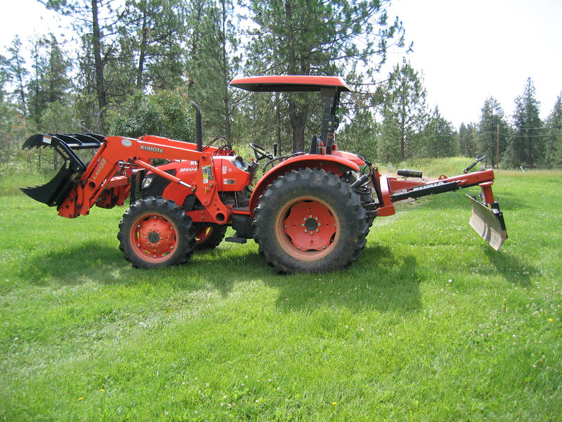

I have a mile long gravel driveway plus mailbox area and yard. For 27 years I used a blower on my 3-point. It worked very nicely. At the end of the 27 years - I was older and all the "driving/blowing" in reverse got real old. Shoulder/neck pain. The blower was on a Ford 1700 4WD.
I got a very HD rear blade on my new Kubota M6040. I can keep the driveway open with this unit. With my M6040 set up as it now is - I can straddle any berm and move it even further off to the side.
If you get any type of blower - a trip down your wood trail BEFORE snow fall really helps. Clear out all foreign objects(FOD). This saves time replacing shear pins.
My Kubota weighs - 10,100#. FEL with grapple, RimGuard loaded rear tires, HD Rhino rear blade.

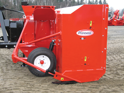

That Pronovost logo is too close to the same as my Agro-Trend also made in Quebec. I've had mine for probably 25 years. Pronovost must be a successor to Agro-Trend ?
