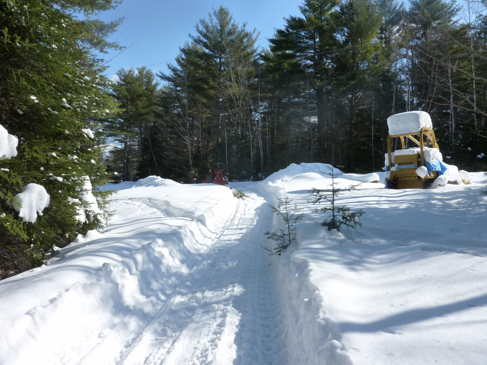

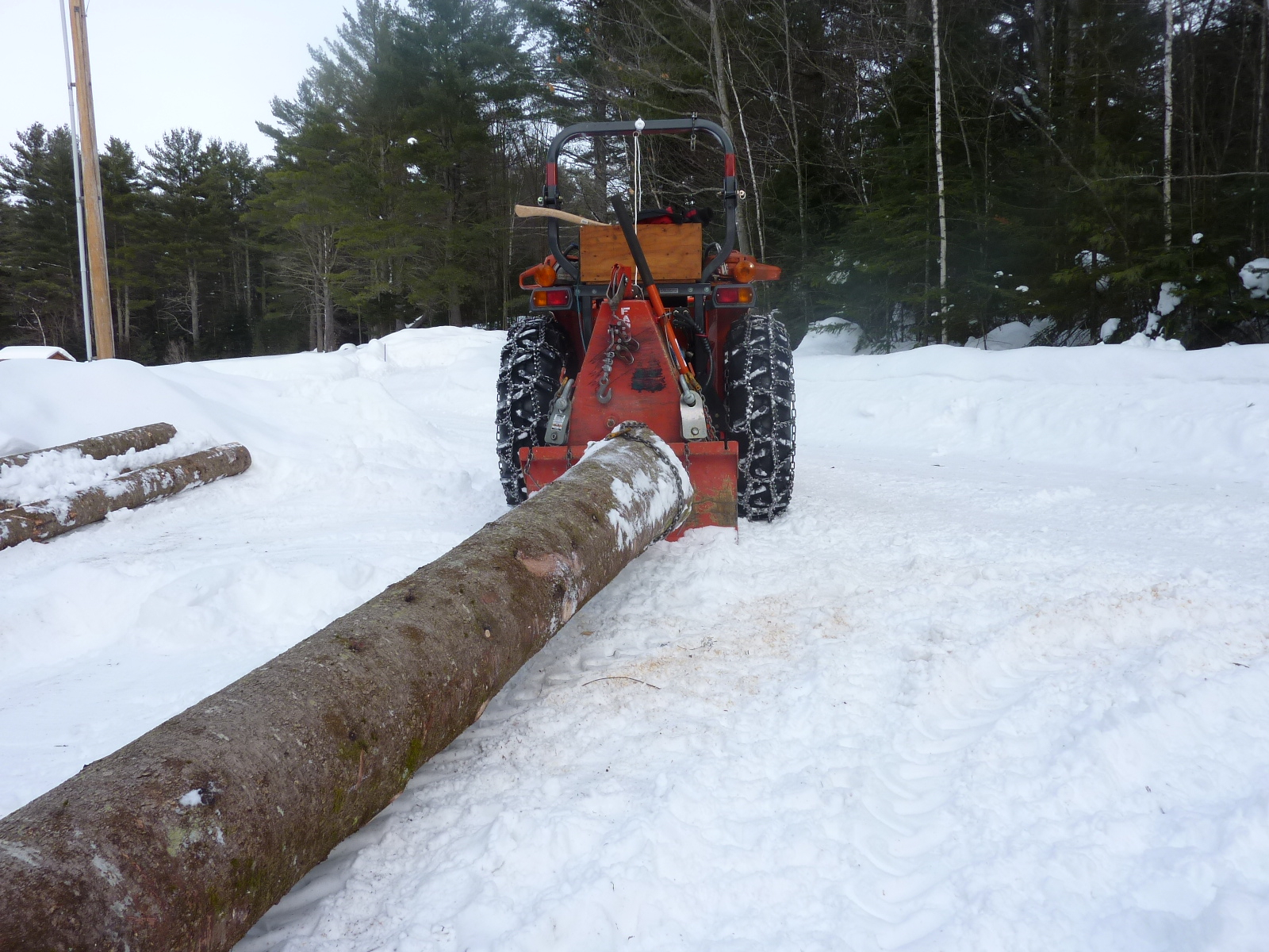

If you get 120" of snow a plow will only work until the banks get get up to the top of the blade and that will be pretty quick because you won't be able to get up enough speed to throw the snow. It will just push up into a berm along the edge of the trail. If you can plow it wide you can use it longer, until the banks pinch in narrower than you plow. I think you are better off just using your bucket. Just keep the trail packed, which is easy to do with little storms but takes time especially for 2 miles worth. Pack it by driving on it and dragging wood or tops over it. I pack them 1-1/2 to 2 tractors wide. That way your tires can hit all the way across and do the heavy packing. And you have some steering leeway. If you get off the packed part your all done. If a storm is to big to pack use your bucket to push it out and back drag with the buck to even it out. Here is one of my packed trails from a couple winters ago. I was running a 30 hp Kubota L3010 on it. And BTW you will need chains.

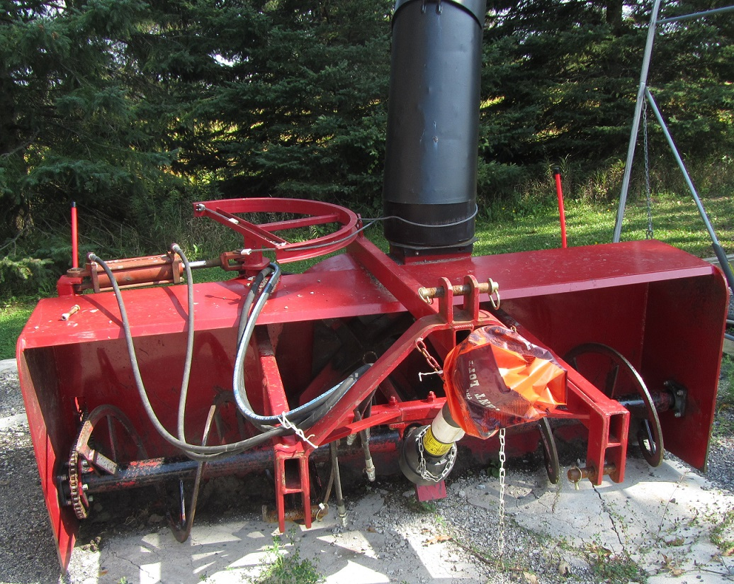

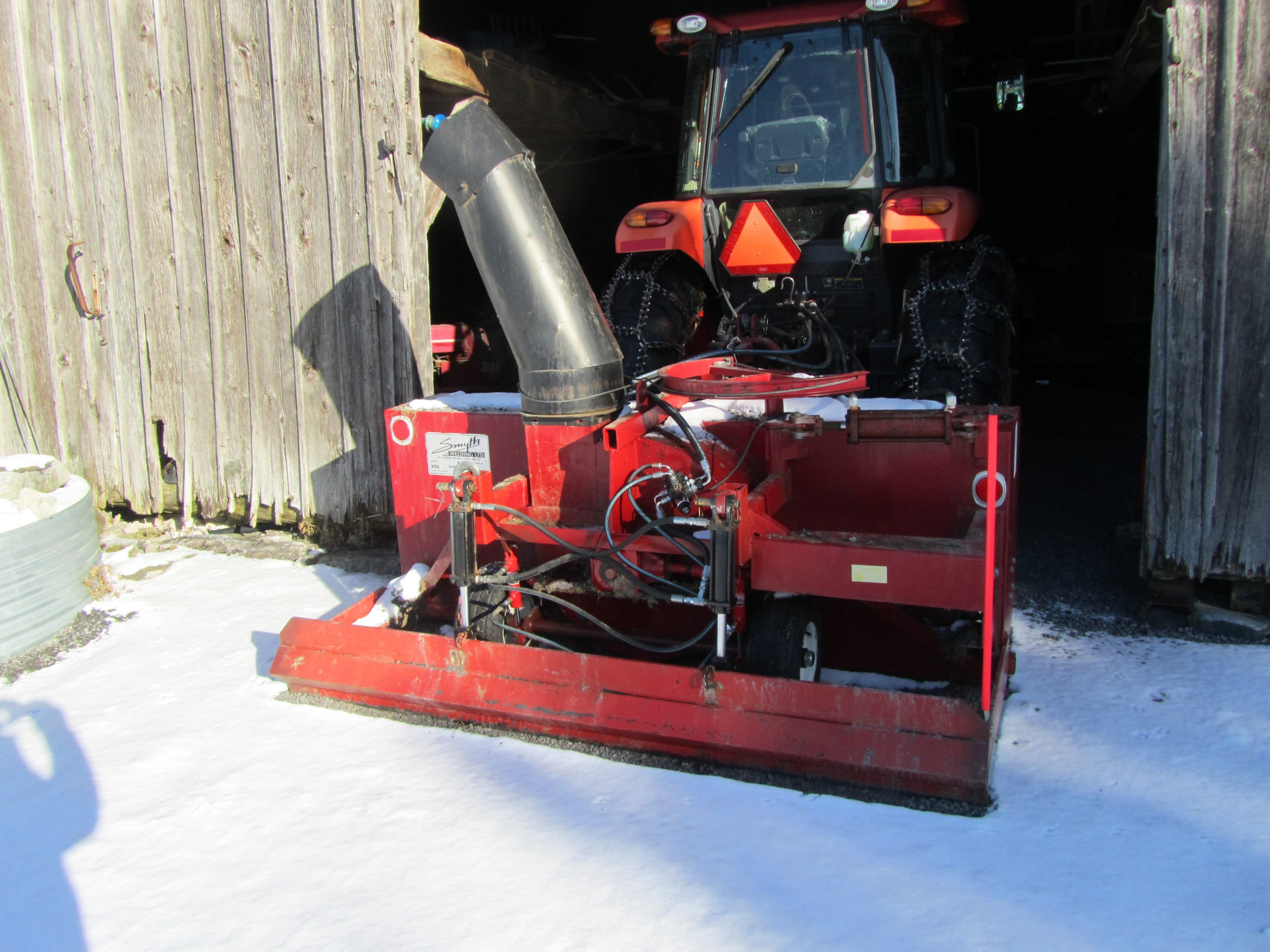

I live north of the St Lawrence river and maintain trails on the farms of my brother and myself. I like an inverted blower. When snow is not too heavy I can motor along at pretty good speed. A much higher speed than you could do with a conventional 3 pt blower. Greatly reduces the time to open up the trails if the snow is not too heavy.

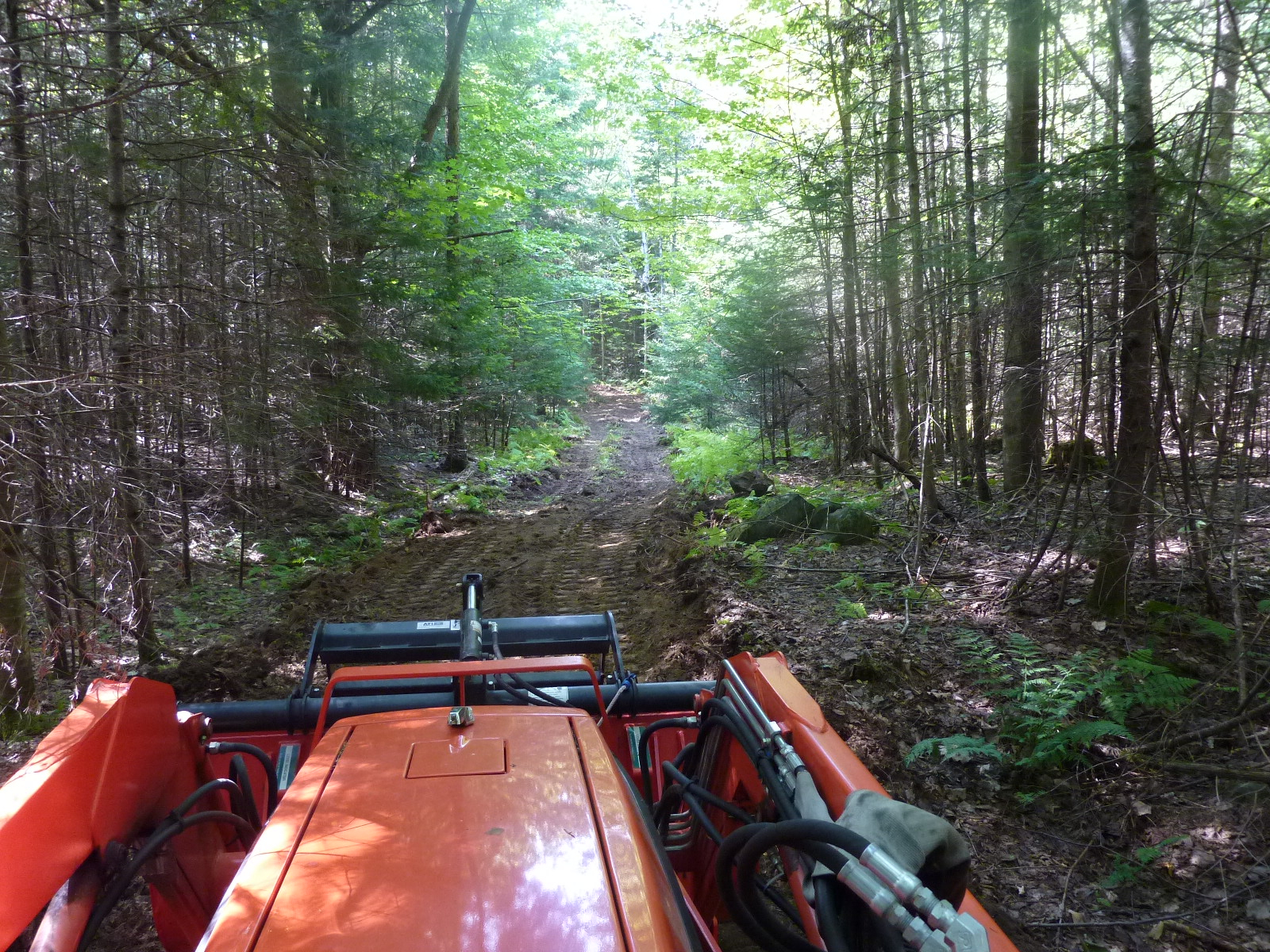

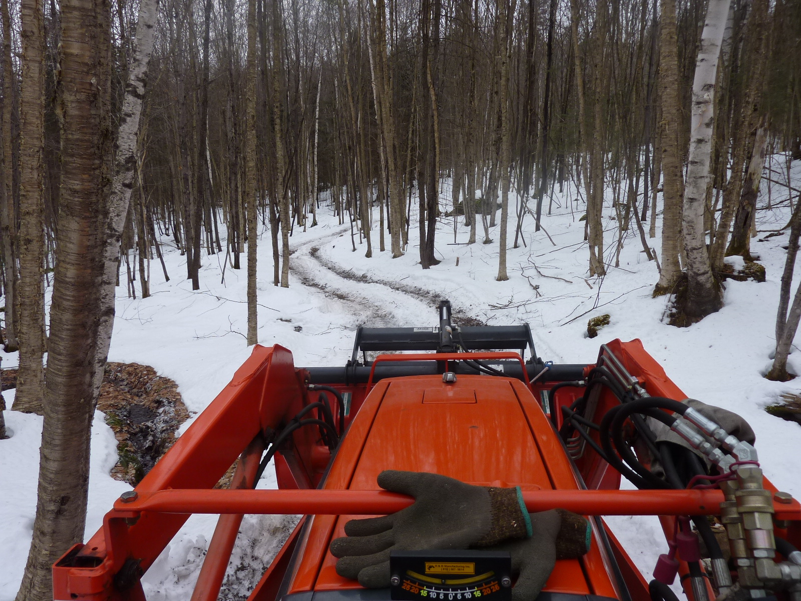

   / Clearing snow (3 kilometer long wood trail) #16
Every one has a different idea of what you mean when you say woods trail. These are what my trails look like just so you know how to gauge where I am working compared to what you have.

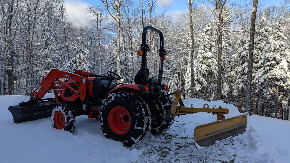

I use a 7' manual articulating rear blade to clear 500' rock driveway. Most snows vary from 2" to 10". I have a 25 HP Kioti that makes quick work of it. If 5"or more, I need to takes multiple passes. I have euro chains, couldn't do it without them. The blade is Everything Attachments deluxe 6-way blade.
