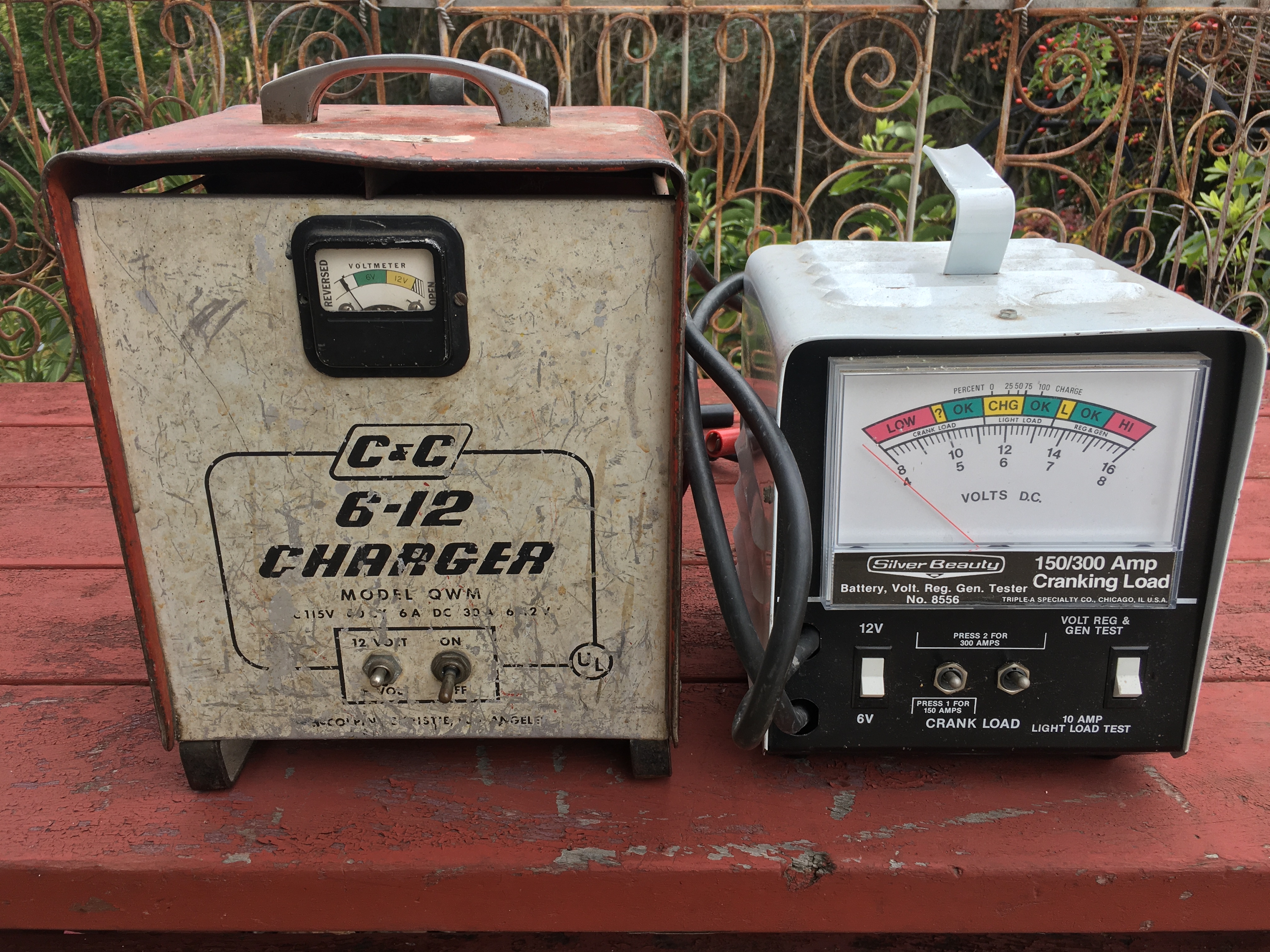

My go to pair…
The 30 amp battery charger grandpa bought when cars switched to 12 volt back in the 50’s and my load tester I bought in the 70’s
The 30 amp charger has brought many batteries back from the dead that modern chargers couldn’t do.
