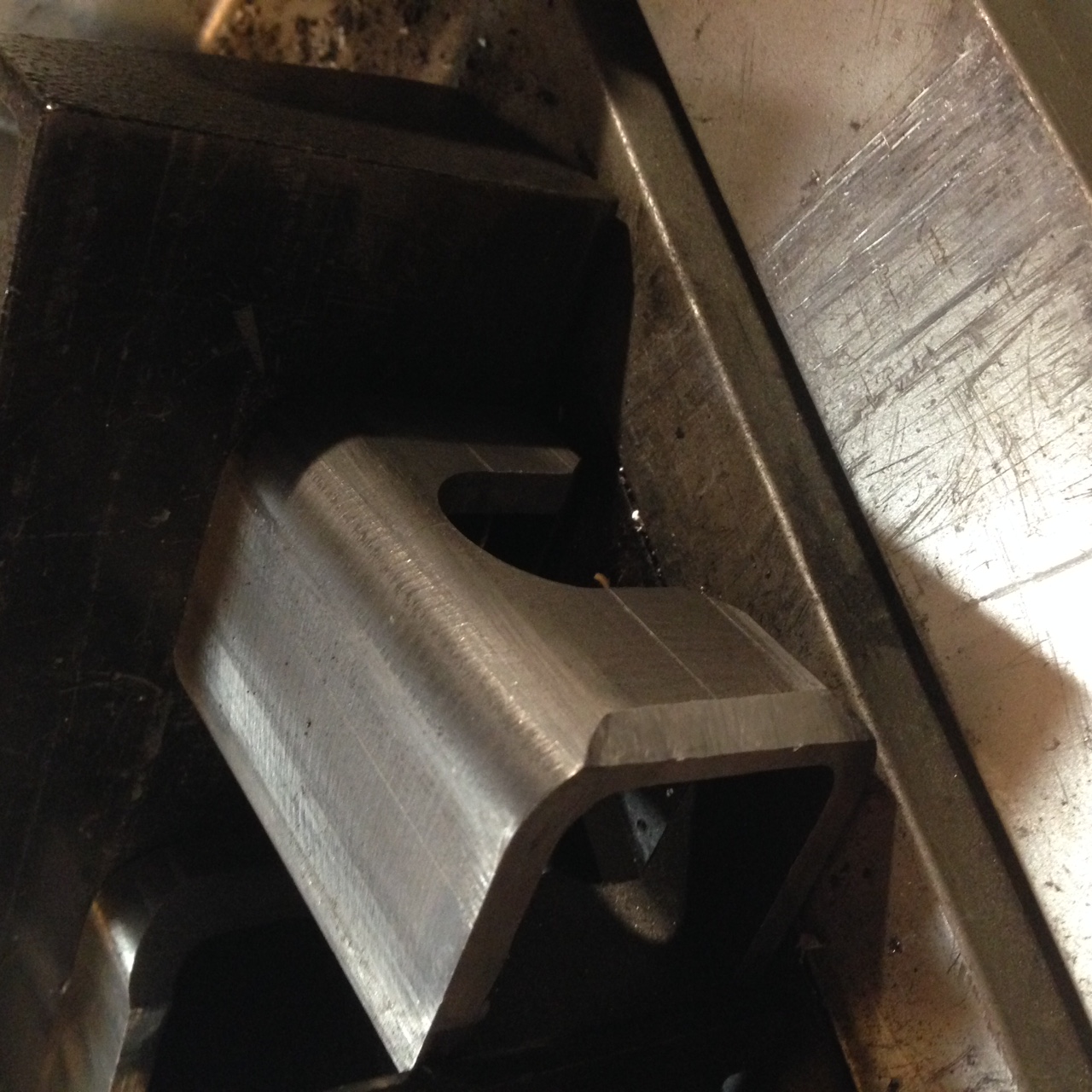

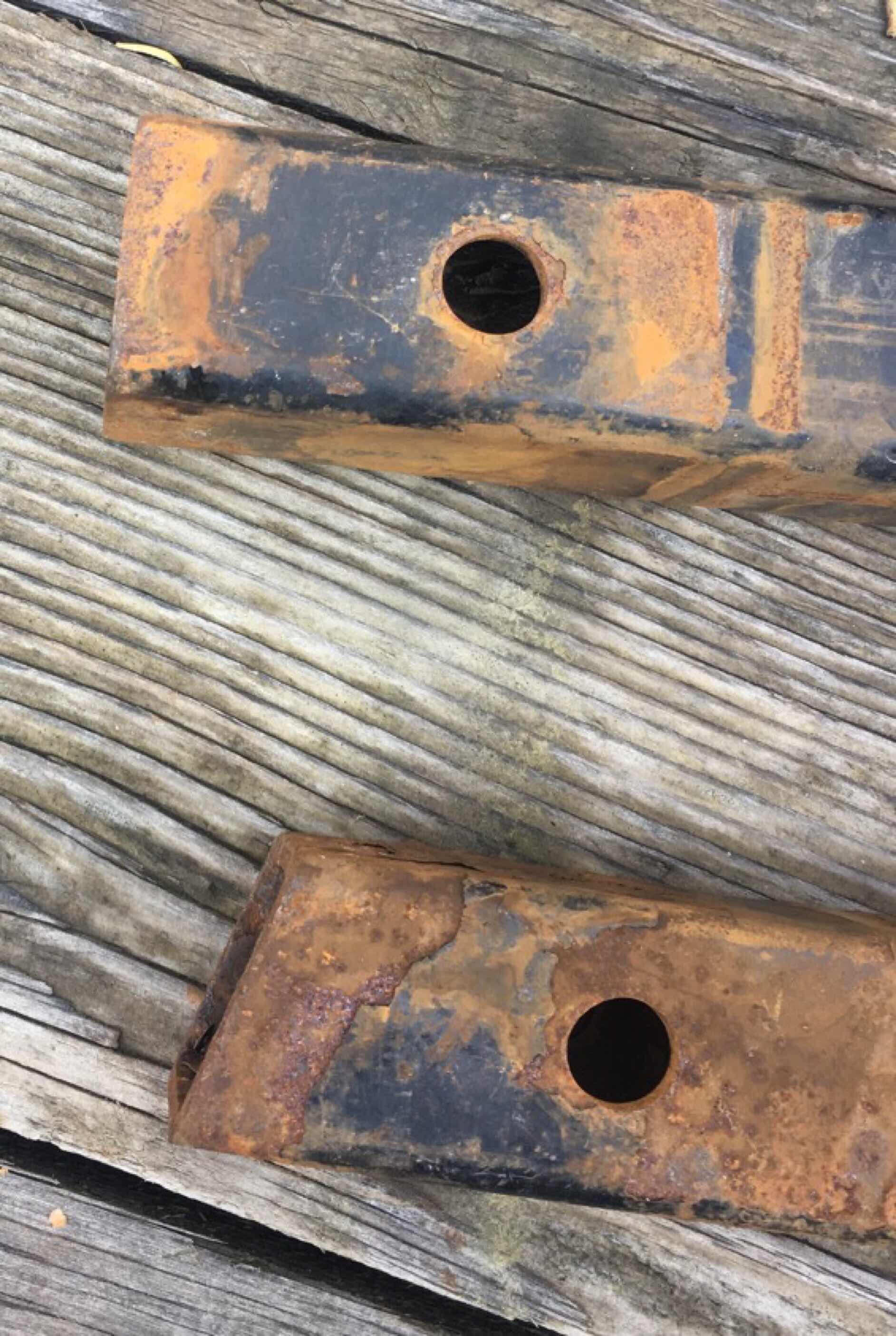

Heres a job for your new cold cut saw. Cut an angle on the end of your hitch. Is like sharpening the end, much easier to find the hole. Its almost as good as Steves method but You don't have to cut the receiver hole out.
Measure 3/4" off a corner & cut. I don't know the angle. Might be a little puzzle to get it clamped. I know most of you fellers only use pintle hitches with a solid 2" bar but was posting this On the off-chance anothe member still uses square-tube receivers. Maybe I'm the only one with this small-time homeowner eqpt. :D :D :D :D :D :D
504012d1490896078-cold-cut-saw-tempimage-jpg
Also can be done with an abrasive, sawzall, hacksaw, smoke wrench, angle grinder. You'll thank yourself every time.

Or, you could just BUY one from the auto parts store :D I needed a second 1-1/4" hitch for the second small car (Subaru Outback) - picked one up at the auto parts, Reese IIRC, and it was ALREADY cut at an angle like that - seems like it works as well as mine, and you're right - it's easier to fab... Steve

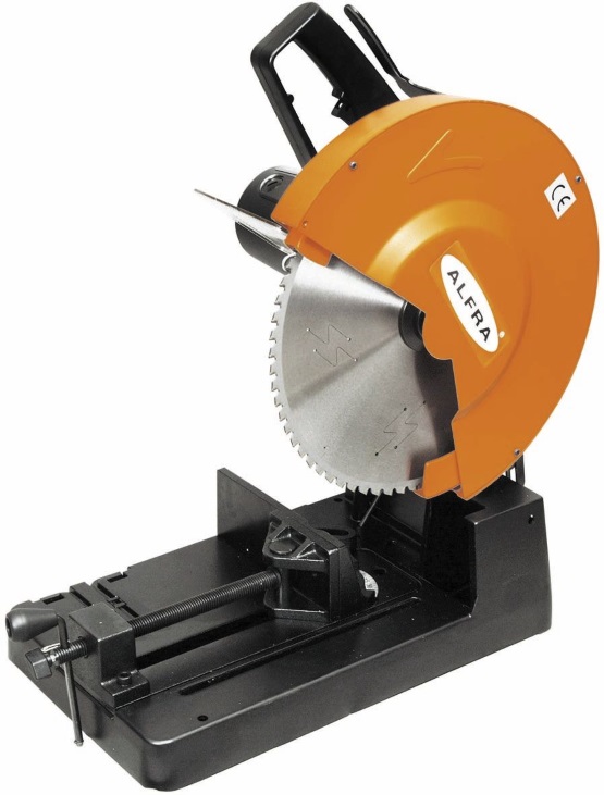

What RPM do the cold cut blades want?
Could a guy mount a cold cut blade on his abrasive cut off saw?
My 14" dry cut saw is 1600 RPM.

A true cold saw, with the coolant bath, runs 150-300 rpm.
