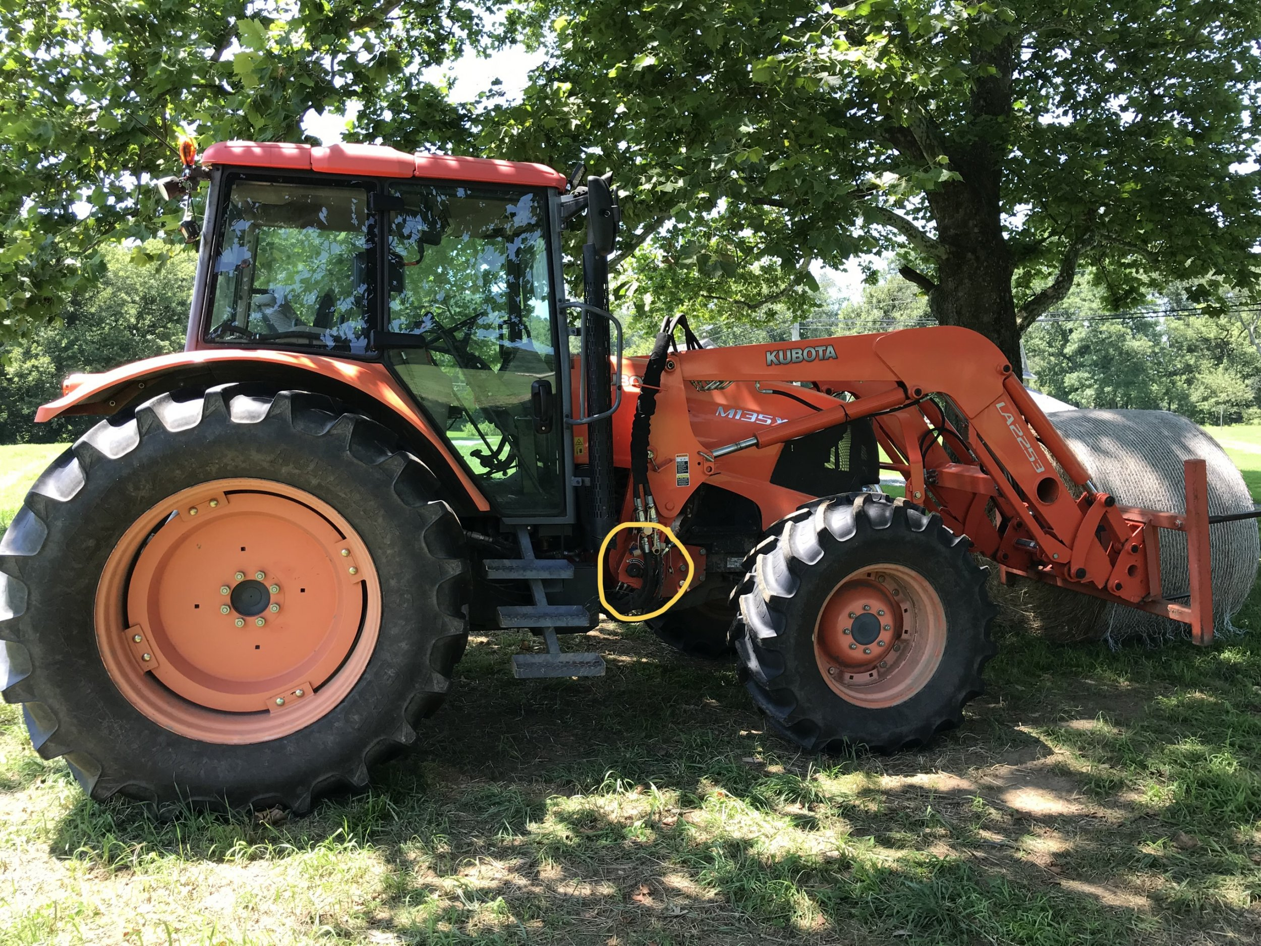

I have em on both my Kubotas and they make a difference. The accumulators on one of mine musta blown a seal. Not working as well as the other.
Best friend you could have for carrying heavy hay bales across fields.
Black knob in the yellow circle is “on/off” knob.
Cab mounted, like I have for the front suspension would be much better.
