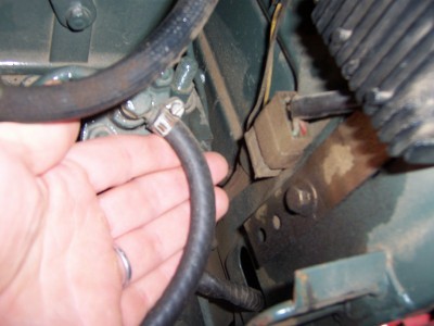

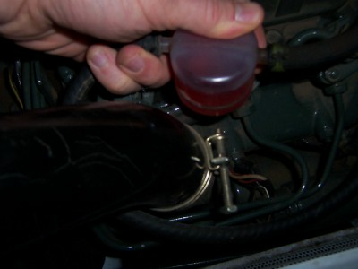

Hey Bruce,
The thermostart plug will screw into the intake manifold. There should be a fuel line which extends from the thermostart plug (it's like a cig lighter coil) to a smallish fuel tank that is attached to a framework on the cylinder head. From there, there should be a line connected to a high-plug on your fuel tank and a another connecting to in-line injectors on the top of the cylinder. I'll try and take pictures of what htis looks like on my 1601. I had to reconstruct the whole setup on my 1601 since it didn't come with it, some may laff, but it is doing the job...
Will you have problems starting? I've spent sometime in both WA and OR and I'd say that your temperatures and humidity are similar to what I have in MA. So, with that said, without aid, you'll have trouble. From about Nov 'til April we have either raw damp cold weather to freezing very cold weather. Without thermostart, my tractor won't start, sometimes even after heating under a tarp with an electric or oil heater. This maybe a symptom of the refurb units we have since others have less problems...
I'm going to go and take some pics, should be back shortly with more detail... -Art
   / Comments/Questions following purchase of 2310D #38
...........I'm back... here are some pics... There are several, so bear with me. I feel obligated to perform the description since I tortured all about this topic a year ago!!! /forums/images/graemlins/grin.gif
Shown here is the thermostart fuel bottle, a must for this system!

line coming outta fuel tank, again on a 1601d model, might vary a bit..

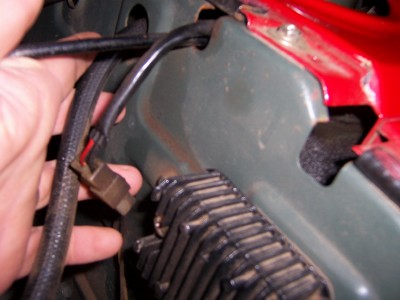

   / Comments/Questions following purchase of 2310D #40
in my case, what's coming / going into inject line...
