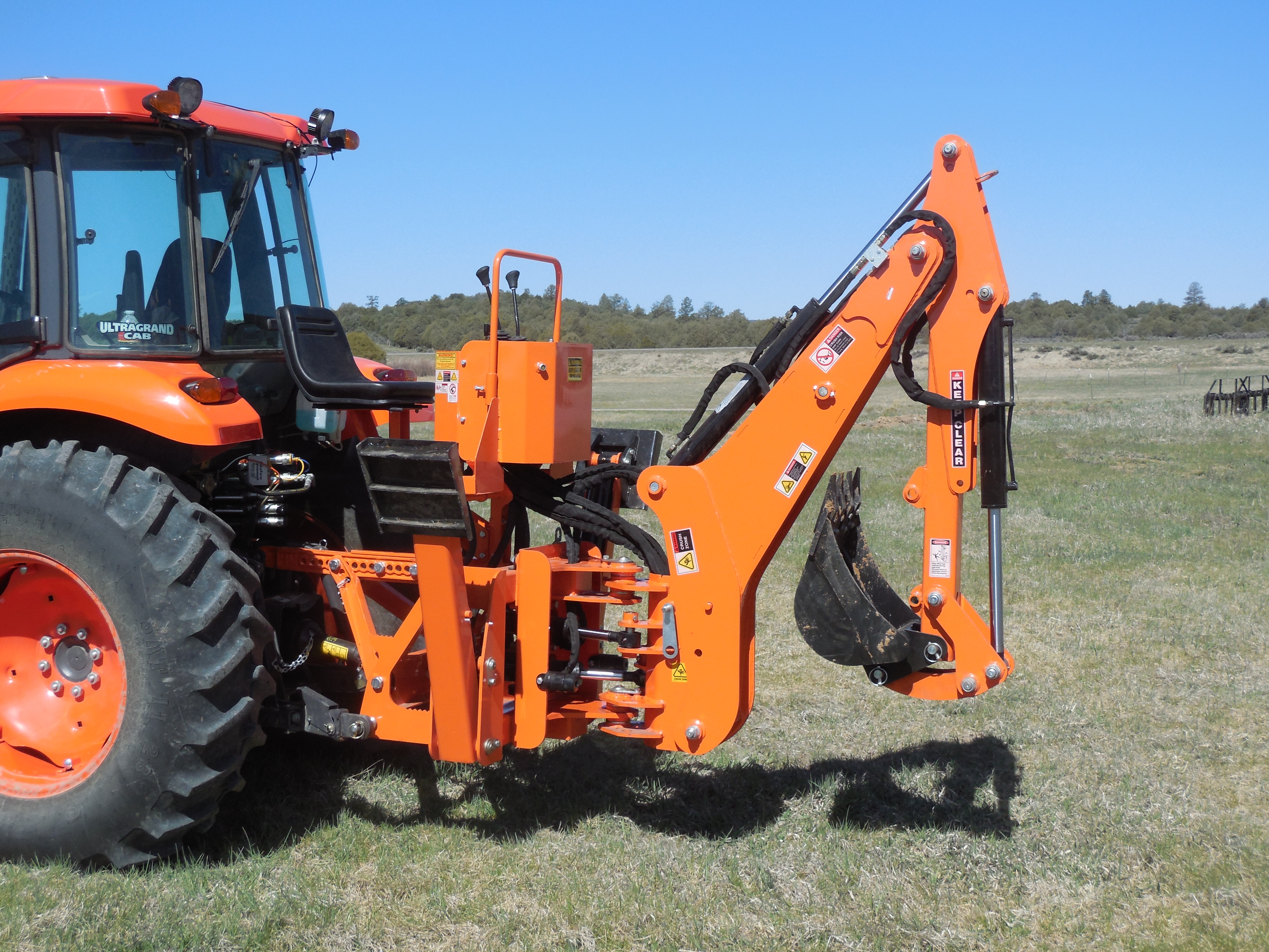

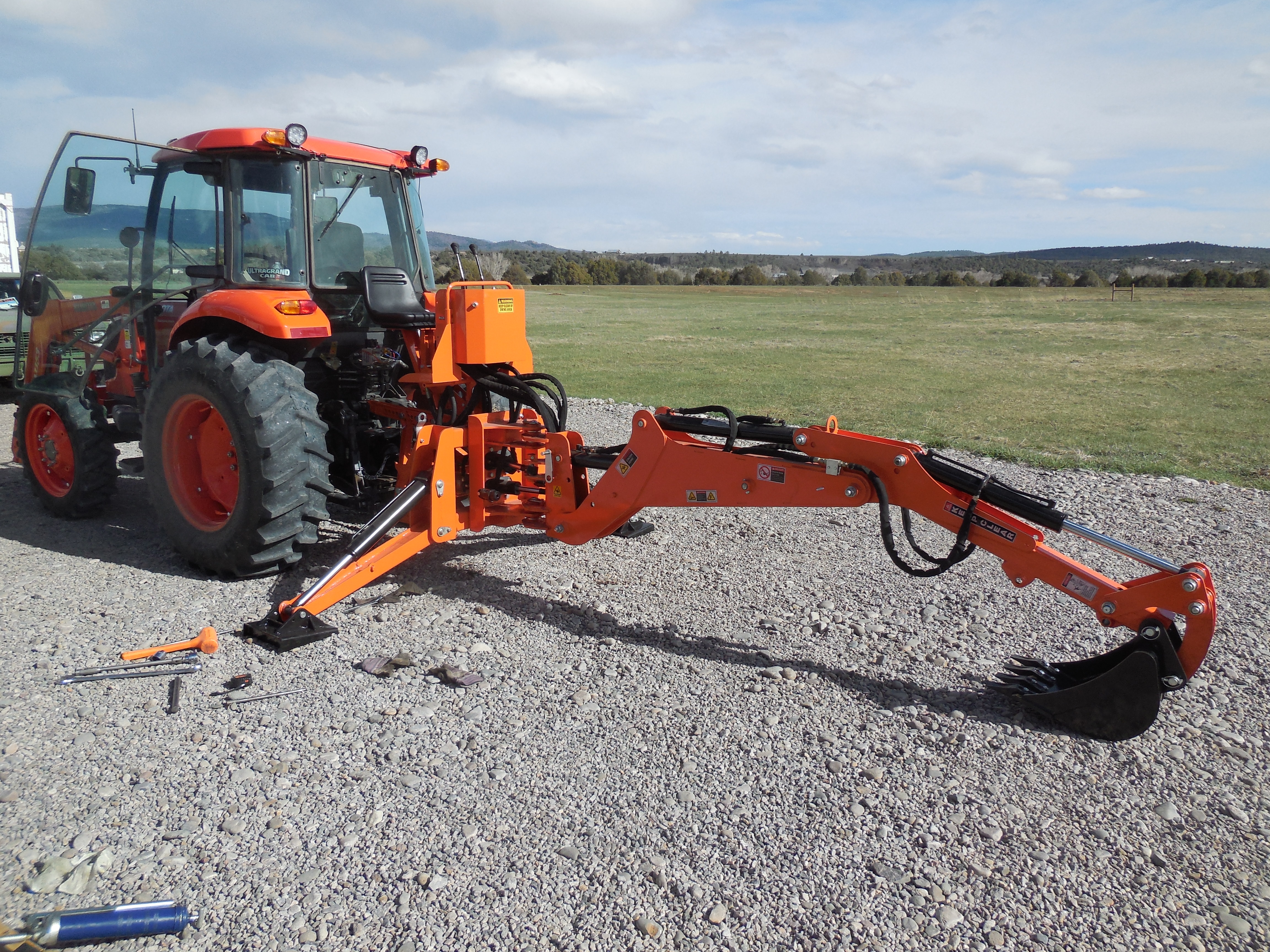

My aftermarket 3-point backhoe was a complete pain to install, not even counting having to mess with the PTO driven pump.
Meanwhile, the ones powered by the tractors' hydraulics are easy to deal with. Especially the one on the BX25D since it's so tiny and light.

My aftermarket 3-point backhoe was a complete pain to install, not even counting having to mess with the PTO driven pump.View attachment 3516822View attachment 3516823
lol the easiest thing for me to hook up on mine was the PTO powered pump. Several times I hooked pump up first and tried to use bh hydraulics to finish attaching it. Still royal pia for me doing it alone.
