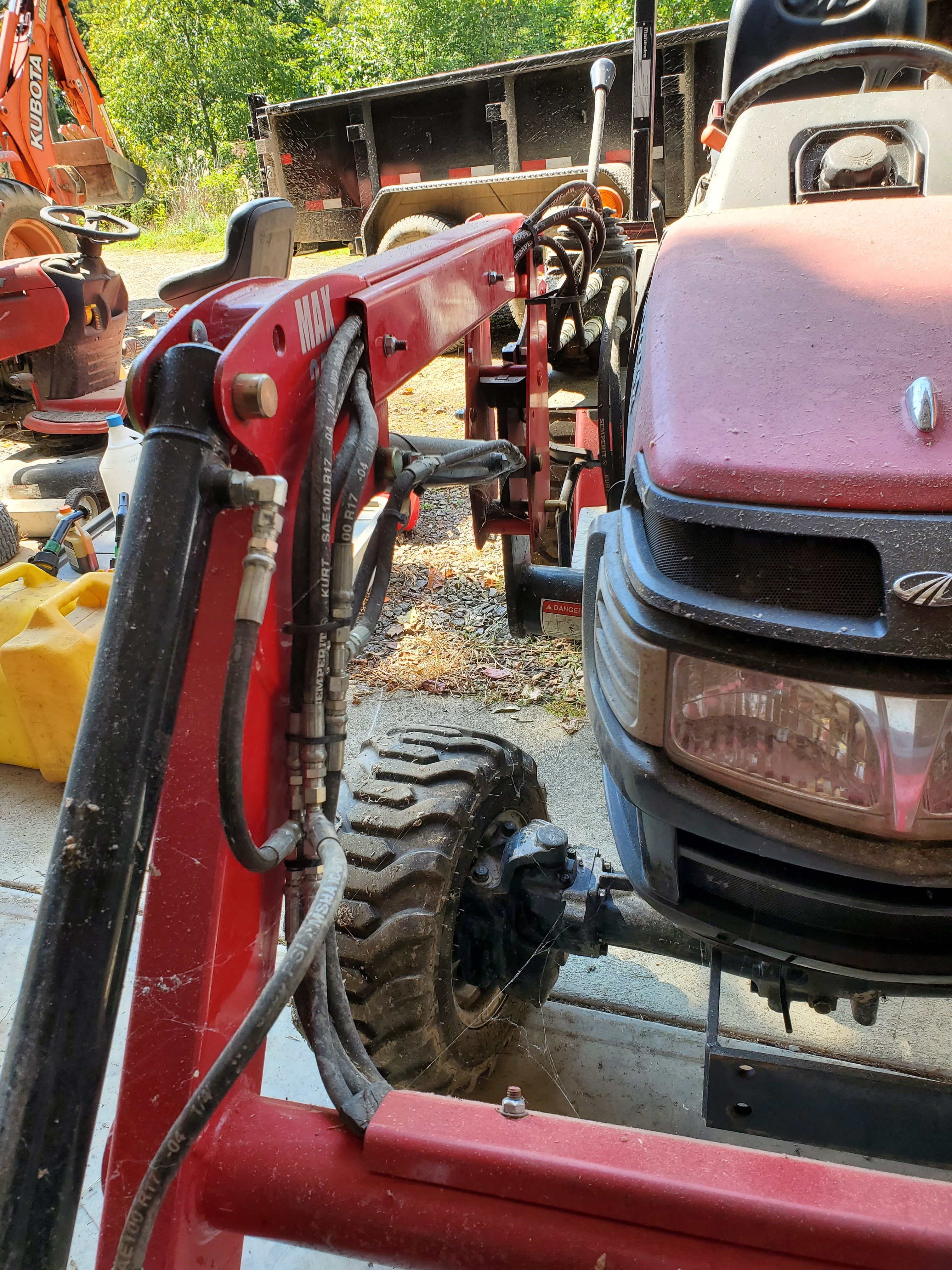

Orahov,
Impressive. So your either a financials guy or an engineer. Both love building spreadsheets to get the hard facts into one place.
However, I would provide the following cautions and comments as a owner of both several Kubotas and one Mahindra. Your spreadsheet does not capture manufacturer's attention to detail, ease of use, functionality, and quality control which are all very much part of the user selection criteria. Some machines have impressive specs but poor attention to detail. My Mahindra is clearly a price point machine with some real clear issues with quality and attention to detail with sticky hydraulic valves on both loader and bachoe. All the mahindra hydraulic lines are hose instead of metal lines and hose where flexed on the Kubotas. Hydraulic hose is easily damaged if not protected. The Mahindra excavator valving allows only one axis of control at a time whereas the Mahindra allows all axis of control simutaneously. I can leave the Kubota's FEL or backhoe or excavator's boom lifted, while machines are off and very little droop occurs after days but the Mahindra droops to ground after a few hours. Bottom line is I will not be buying another Mahindra and Kubota is clearly a contender for future purchases.
I suggest you add a model year to your spreadsheet in the event someone, in future, wants to review your info.

/ Compact Tractor-Loader Specs Comparison #12
My owners manual list the required balance for mine. It’s near the maximum of what my 3 point will lift. I’m probably a couple hundred pounds less than that.
/ Compact Tractor-Loader Specs Comparison #13
Meanwhile, the outriggers especially and the bucket on our BX25D drop somewhat quickly, while the Kioti CX2610's bucket stays put for months. On the Kioti there are locks for the outriggers so I don't know if those would leak down, too.
Also, the loader on our L3800 starts lowering itself noticeably with maybe 100 lbs. in the bucket, while the M6040 seems to stay "forever" even with well over a 1,000 lb. load.
In my experience it's not a Kubota, but which Kubota.
