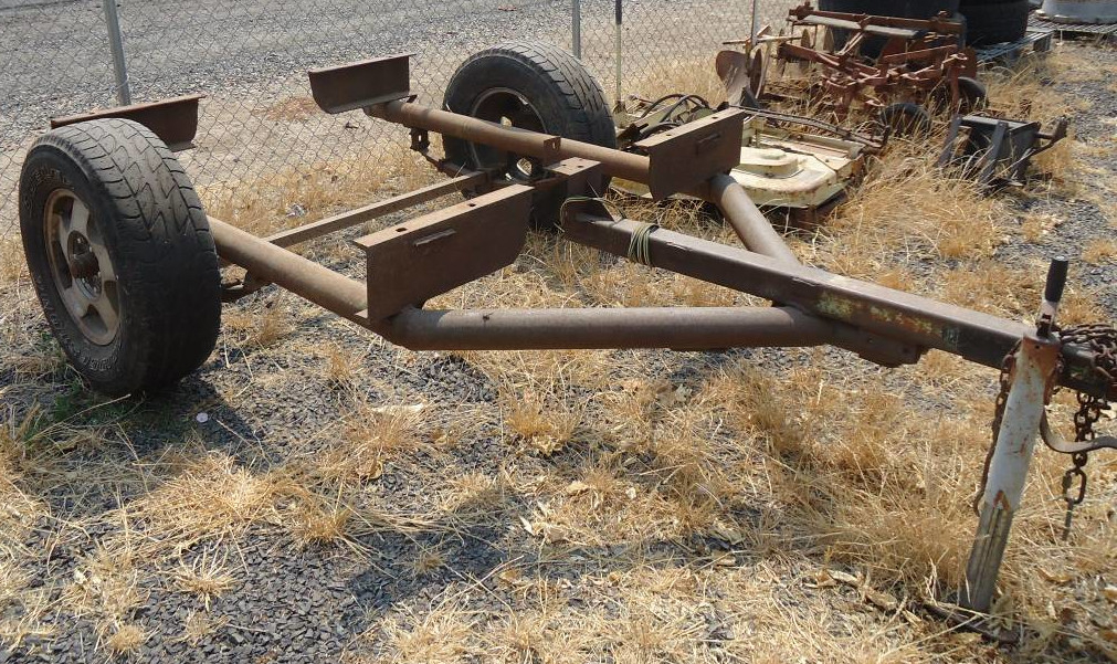

I've been thinking of building a fire tank/pump/hose trailer for firefighting for a while and I just ran across this trailer for sale somewhat locally.
The question is, how to determine a likely capacity of this trailer's axles? I see 6 lugs, but from the pic (the ad says nothing) I can't see much more - the brake drums look pretty small. 3500 pound capacity axle?
My thought is probably cut off the risers that held the pickup bed and weld some cross members directly to the round tube such that the flatbed is as low as can be (probably limited to the height of the tongue tube, unless we cut that back a foot and tie it to a new crossmember there). I'm able to do some welding (up to 3/16" mild steel with the current mig rig, but I'm willing to upgrade to weld heavier stuff if I find the appropriate project that requires it (oh no! don't make me buy a better welder!)).
Given that my use would be entirely low speed and very local (ie, pulled my tractor or my truck on my land or immediately adjacent), how tight would you stick to the capacity?

IMHO, that trailer is scary. I doubt if it's even legal. Just WALK or RUN away.
   / considering this trailer... #4
Homemade, probably has no actual specs for weight/etc.

I would get rid of the springs and weld a saddle for a 3.5" trailer house axle and use load range "G" tires. That stuff could be found cheap. Shoud be good for any load you are going to pull on it.
   / considering this trailer... #10
tongue bar looks attached to nothing on the deck side.
I'd be looking much bigger - car hauler size, for that water purpose
at best, this one is a tow behind yard trailer only ... no papers, insurance required for that, so if cheap enough buy it for that
   / considering this trailer... #11
I would look for a different trailer. Like others have said there does not appear to be an axle to carry the weight to the tires. We use 10#/gallon for the water and tank weight for our FD trucks. Adding the trailer weight, pump, hose, and misc equipment I don't think you can get more than 100 gallons on it and that may be generous.

Thanks for the feedback, even those who questioned the junk trailer's legality (I don't care if it's legal).

About the junk trailer referenced above - while I think tying the main tubes together with cross-braces that would be necessary for carrying a tank would provide the main frame with sufficient strength (as mentioned in the original post), I think that the sketchy "axle" makes this trailer worth scrap; the frame itself is worth something but it probably needs an axle found. They're asking $200 on CL, so it may almost be worth that, but looking further afield I see some military M200 trailers at auction that would probably fit the bill really nicely:

I'm thinking that small box axle is light. I understand you just want it for on property use but not sure that axle is capable for slow bouncing across a field with water.

I would suggest the hubs on that trailer are good for 5000 lbs (6 lug), but the axle is not.
I've used a couple of different configurations, and I'd have to second the need for tandem axles. Given your low speed need, one of those military trailers with tandem axles would give you a lot of flexibility. You could keep stacking up IBC totes until you felt it was too much. Down here they are under $50 each.
One other note I'd add - 5000 lbs or more on an unbraked trailer is asking for trouble, especially on a small tractor. I had a "moment" a few years ago while filling up a water trailer on a very slight incline. I guess I didn't have the brakes on good enough, and as the weight the increased, the trailer pulled the truck backwards down the slope - guess who was standing near the back with a hose :/
