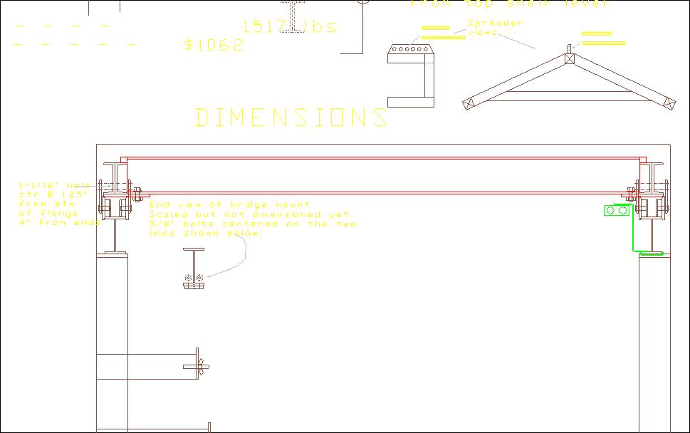

Sooo, I'm documenting the "small footprint" welding cart that will then be used to do the "Crane-Tainer" project.

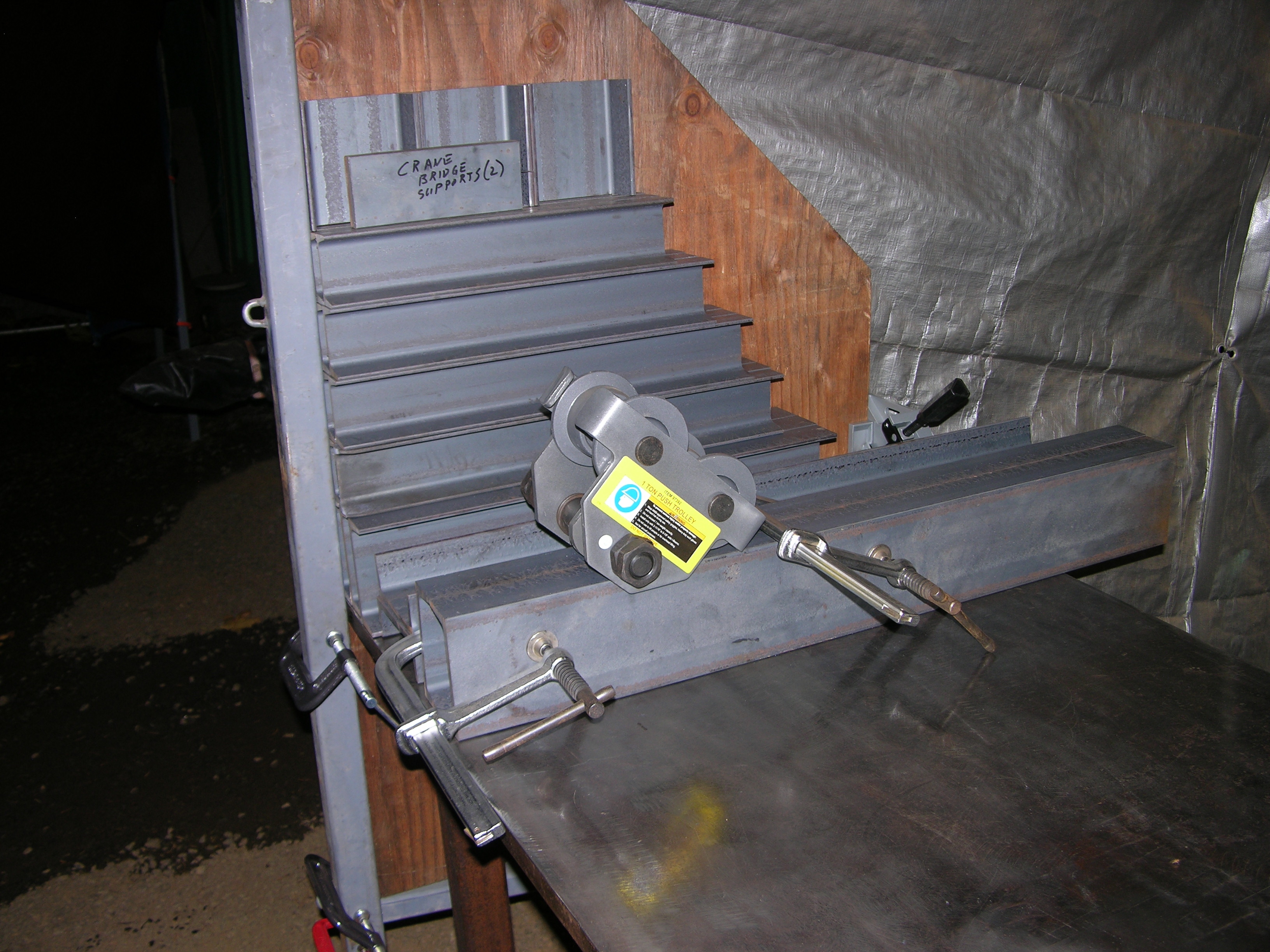

I DID manage to get a few pieces cut, then did the math and decided that welding subassemblies in ONE location and then moving them (painfully) to another location wasn't too bright, considering that several of them would weigh more than 100 pounds and my back's ALREADY callin' me names -
The shorter pieces of 3" and 5" channel in the stack are 3 sets of "shelves" for an integral steel rack on the 3 crane rail supports on the left side of the container, getting shorter by 2" on each successive shelf - then the 4 pieces of LONGER channel leaning against the siding will get welded together back to back in pairs, making 2 "heavy-web I-beams" that will be combined with 2 1-ton trolleys for each end of the bridge beam.
supports for the side rails will be 3 pieces of 5" channel 75" long, with bottom shelf also acting as a weight spreading "foot" - uprights will be 7-1/2 feet apart; one centered on its 20' I-beam, and the other two 2-1/2 feet in from the ends. Each upright will get welded to the wall in several places, plus each upright will get a 45* gusset (2" square tube) from 25" above floor to the steel rim at floor's edge, and a second one from 50" up going up to the crane rail. These will be mirrored for the center upright, and just OUTBOARD on each outer upright.

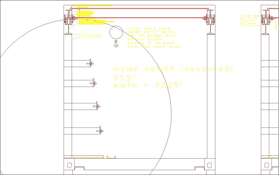

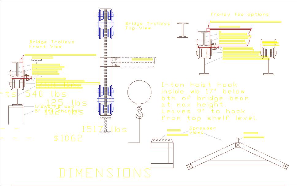

All spans calculate out to right at 2 tons, and the hoist trolley will be 2 ton rated; but in real life it should never see more than ONE ton. No motorized lift or traverse, so there should be no problems with racking whatever.
Best I can do right now for drawings is a couple jpg's that start out as DOS files from my ancient CAD program, which then gets converted to equally ancient DXF from that program, then imported into a (barely) Windows home cad program that can still READ old DXF's, and can "save as" a jpg. Still a work in progress as far as clarity's concerned, but it's what I got and I'm gettin' too old to wanna learn how to draw all over again in a newer prog... Steve

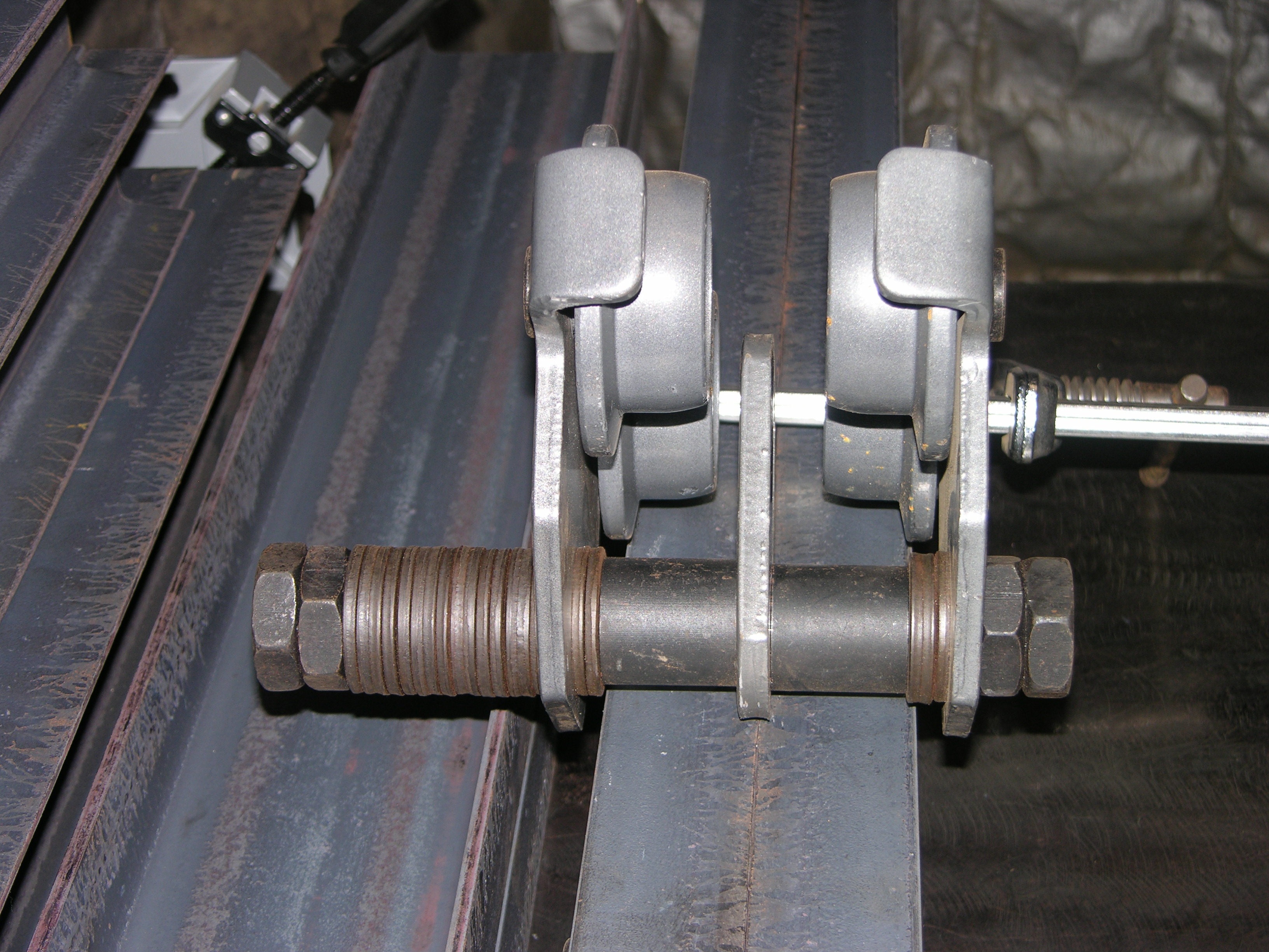

Oh, the end trolleys are 4 HF 1-ton trolleys, used upside down - couldn't find crane wheels that small and it woulda been a pita to do on a mill, plus I couldn't buy the BEARINGS for what those trolleys cost on a coupon...

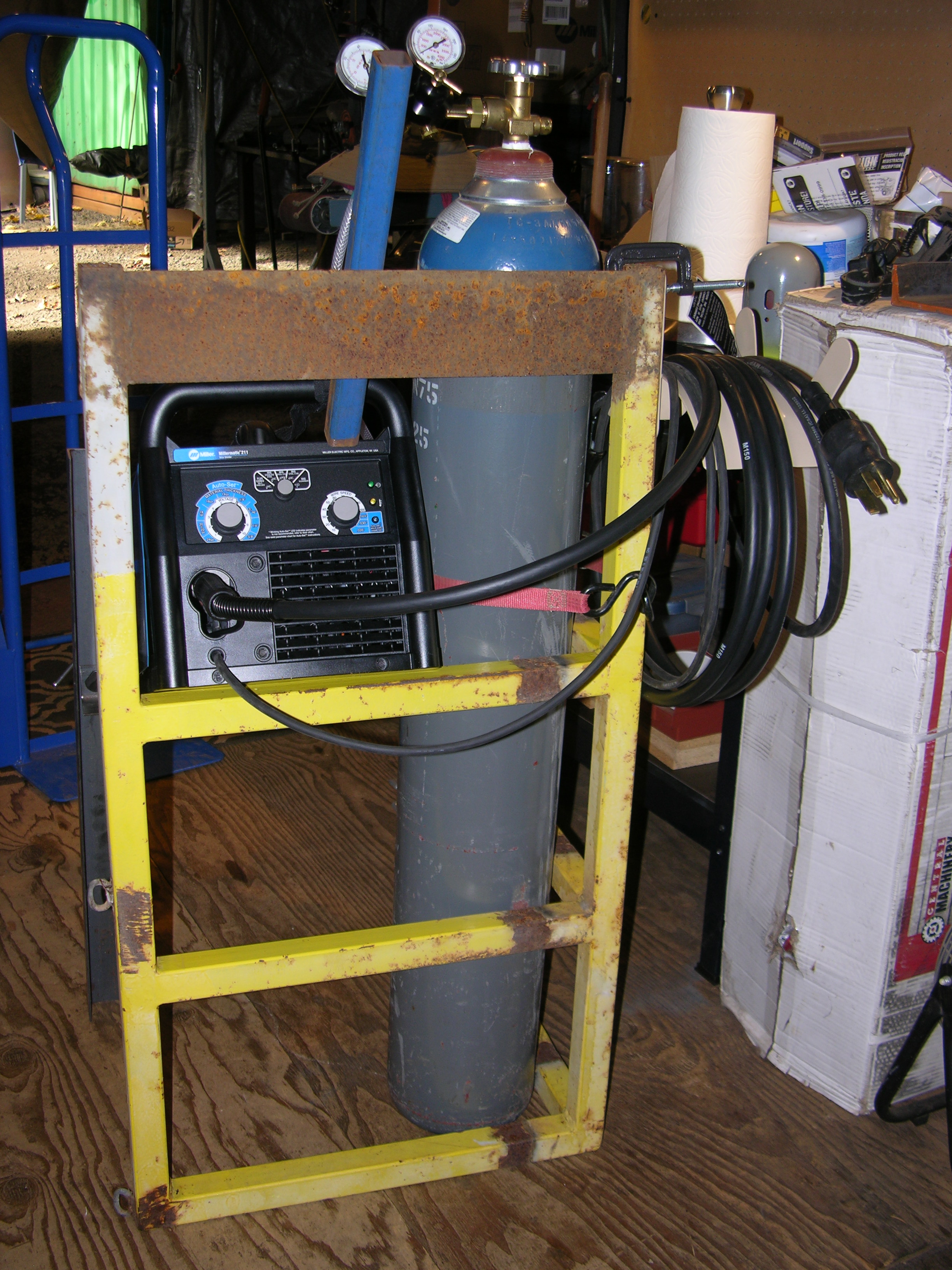

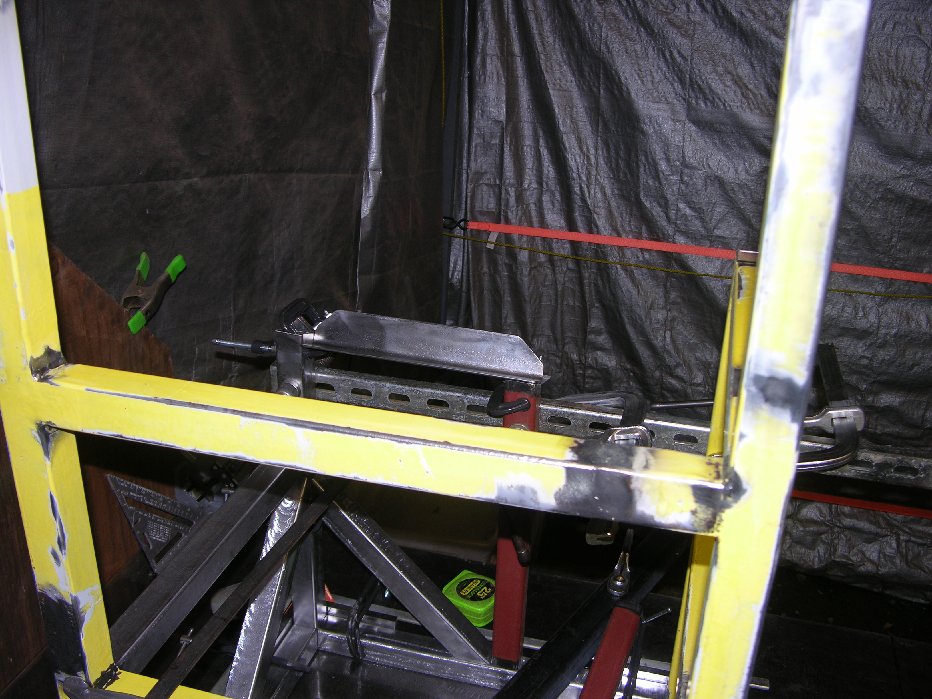

Got a little more done on the weld cart tonight, it's mocked up enough so I can see where I need to clean for welds - I'll also need to clean up those rust spots and give a good coat of rusty metal primer.
Once it's all together EXCEPT for wheels, I'll put the bottle and welder on it and figure out where the balance point is; then some 13" wheels will go toward the FRONT from that, the taller 2 uprights will get a tall handle that'll make it into a hand truck when tipped back, and a pair of double locking casters will go on the 2 rear corners. Add a lead hanger and maybe a torch holster and it should be good to go... Steve
(Oh, and some purtier paint :D )

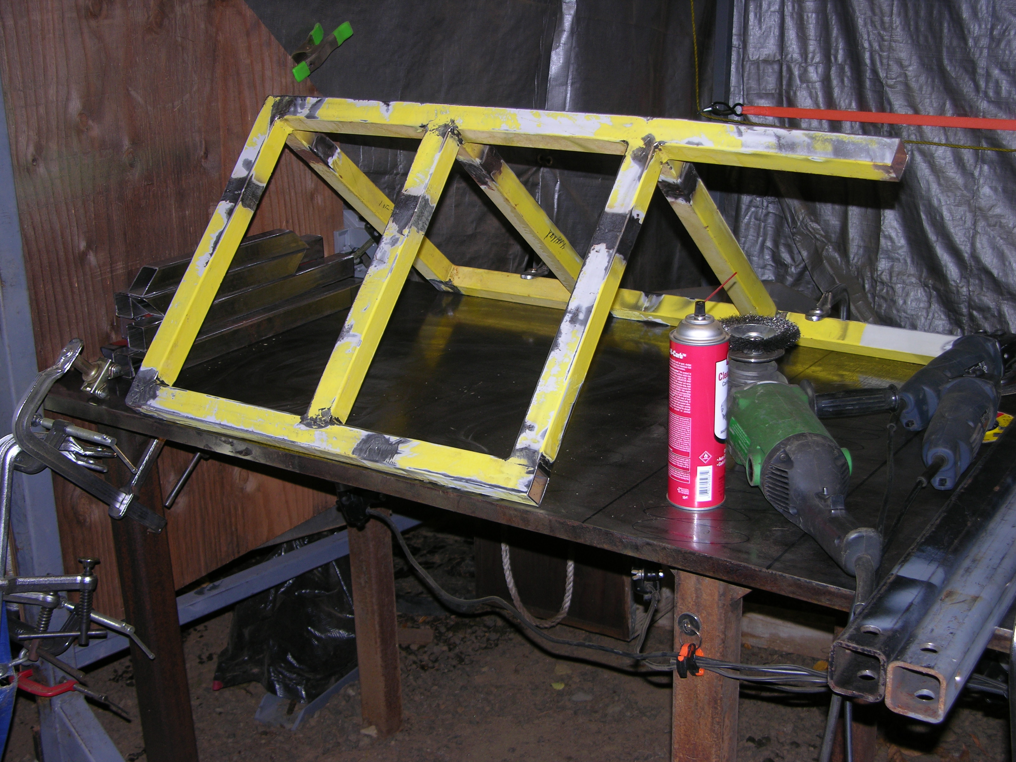

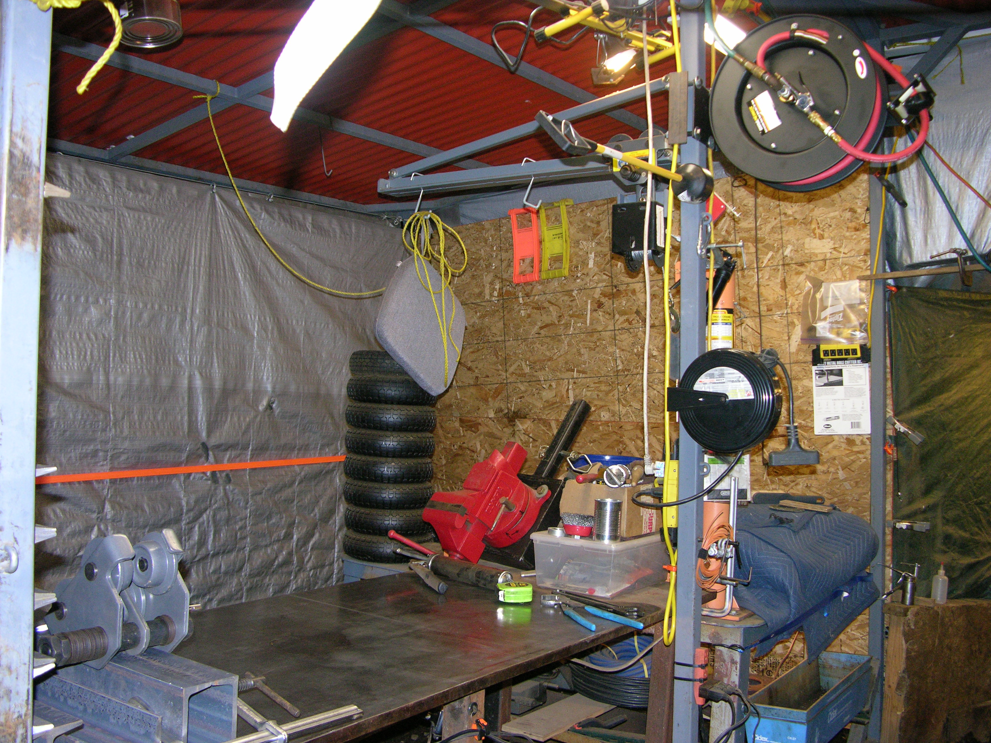

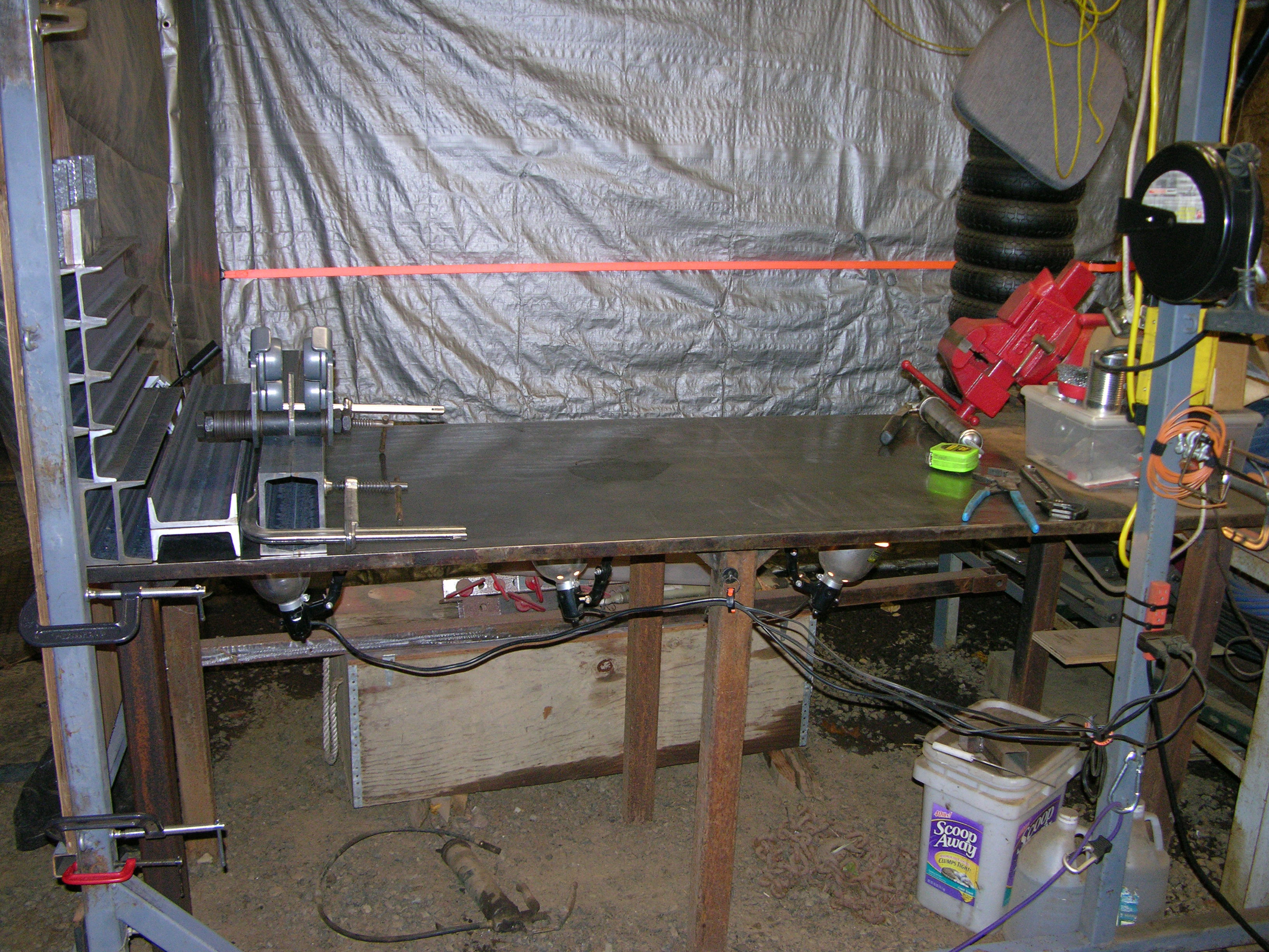

Finally found time to get my weld table cleared/cleaned off, and got all the pieces for the steel rack (doubling as one of the two wall supports for the bridge crane) cut, except for the 3 legs for each side - working on a stronger design for those legs so won't cut pieces til I'm happy with it...
Each end of the bridge beam will rest on a box beam (the two pieces of channel with weld clamps on them will be ONE side of the bridge) consisting of two 36" pieces of heavy 5" channel - each end of each box beam will get drilled to 1-1/16" to fit the thru-bolt on HF 1-ton trolleys, used upside down to support the trolley - so each end of the bridge will have TWO 1-ton 4-wheel trolleys, with the bridge beam centered between them.
The actual hoist trolley is a 2-ton rated unit, and the I-beam itself will support nearly that - but the crane will never see a full ton.
All the pieces of 3" channel are for 3 sets of tiers (5 levels, counting the 5" channel on the FLOOR which also doubles as a "spreader" for the uprights, with 20' rails on top - rails AND bridge beam are 6" x 12.5# I-beam.
I still need to spend some time on the CAD drawings to get cleaner conversions; 'nuther day... Steve

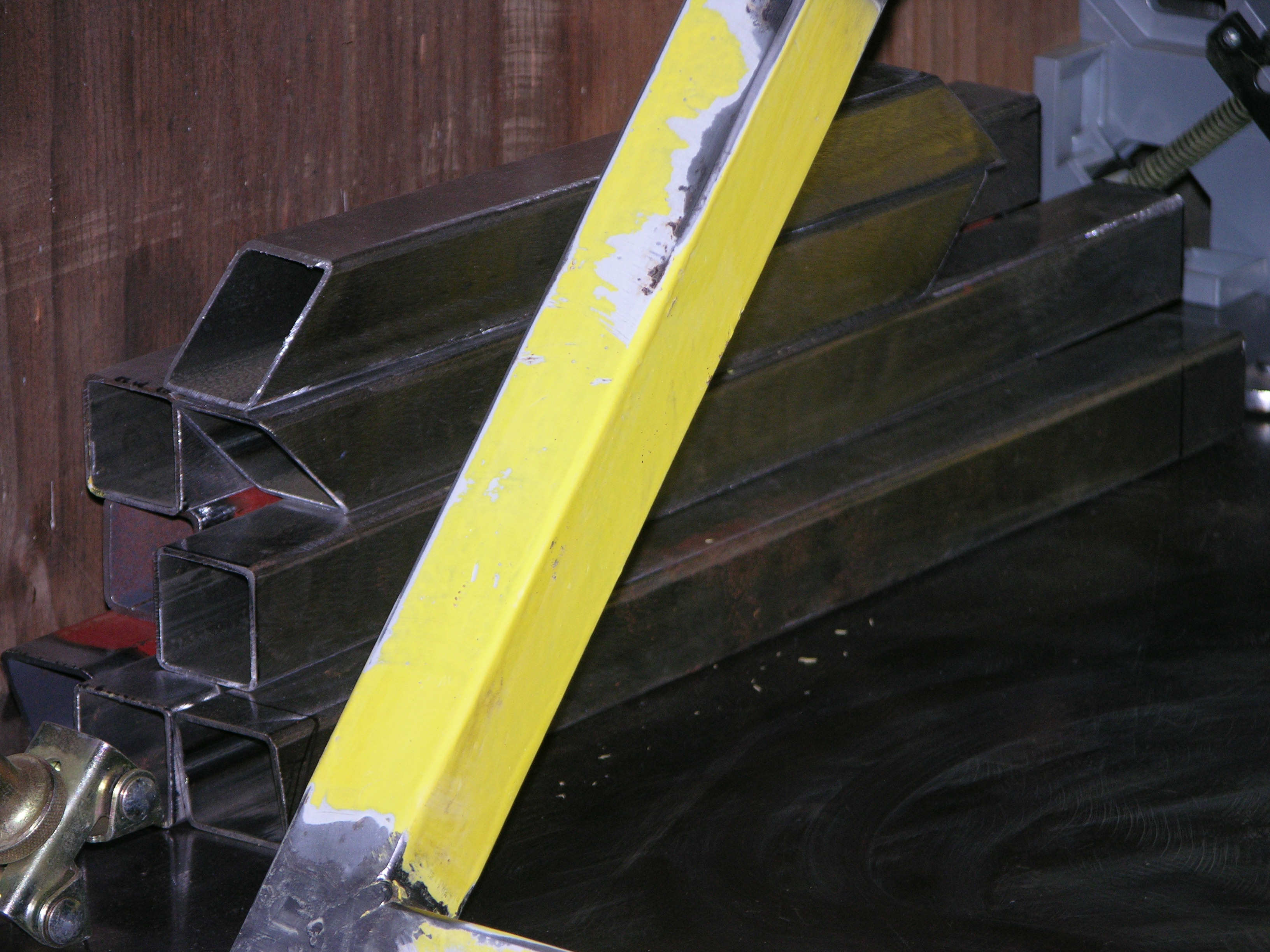

Well, too many things goin' on today for MUCH progress, did manage to get the prospective donor for the MM211 cart clamped down hard and ready to shine up areas to be welded - tomorrow should get me about ready to tack things up - once it's welded out I'll clean up more of the old stuff, add the tall handle, mount the welder and bottle and figure out where the balance point will be for the 13" hand truck tires and casters... Steve

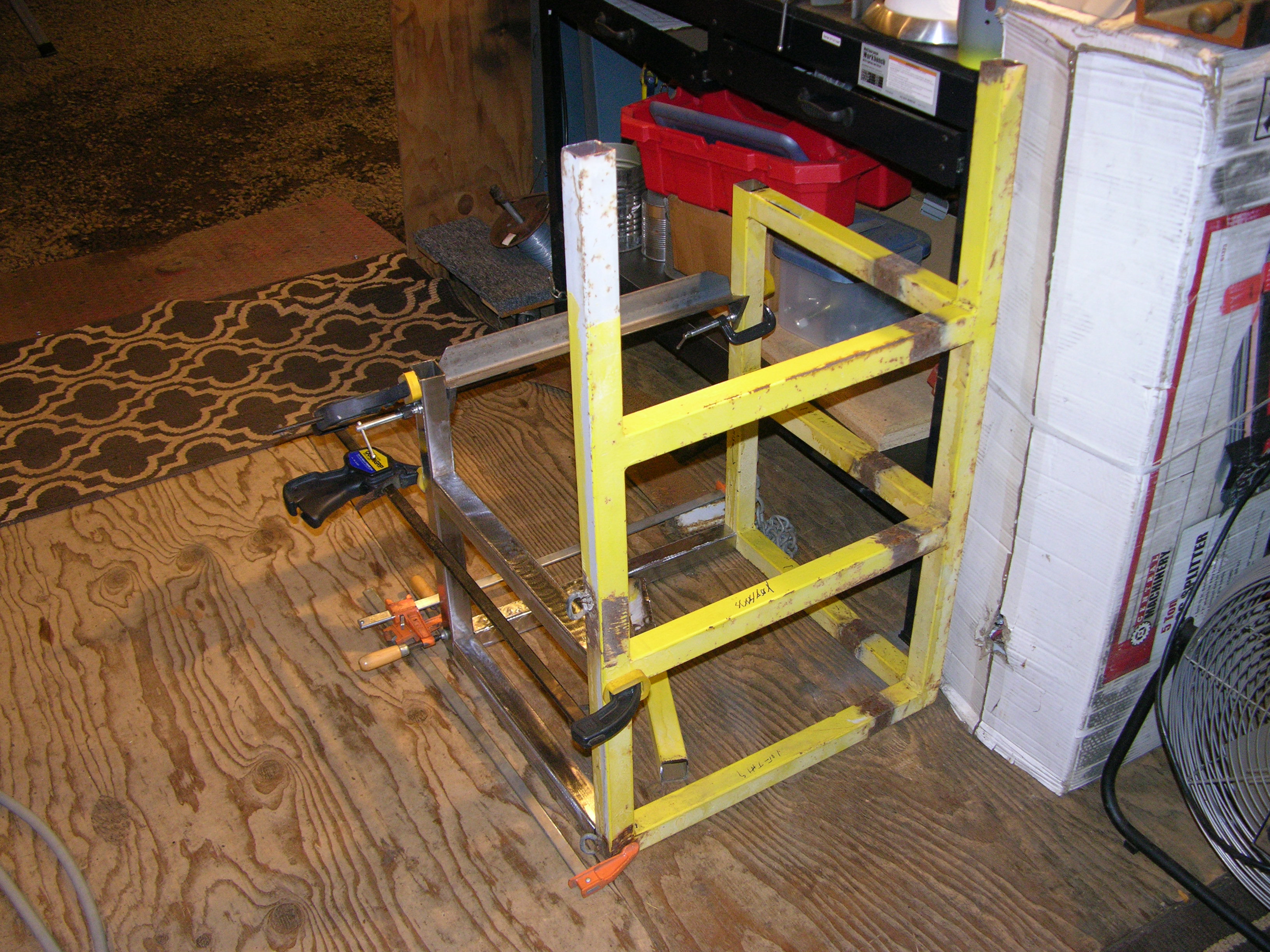

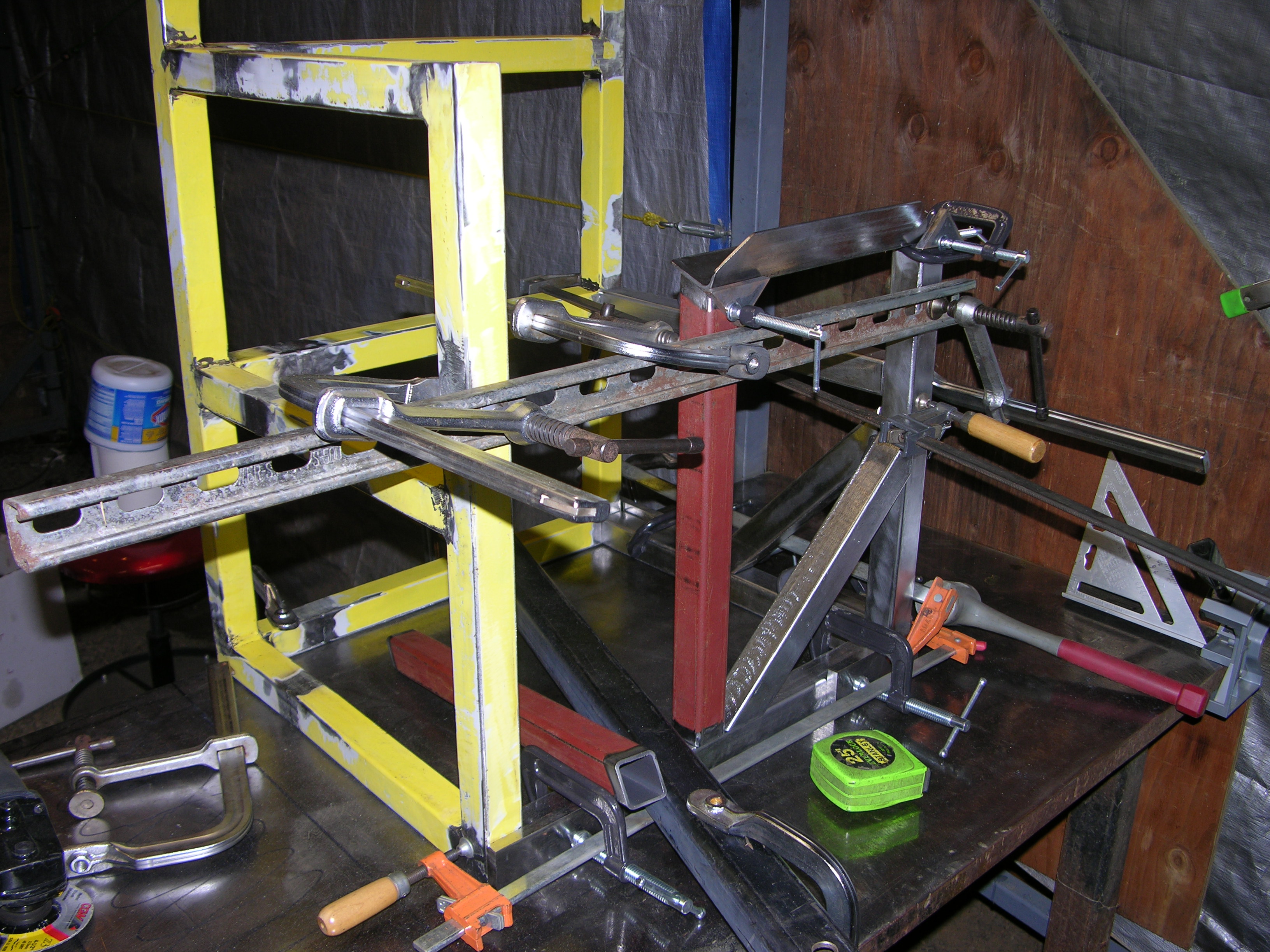

Got a little more done on the weld cart today; nothing tacked yet, it's taken a little more cleanup on the "donor" than I'd realized. Probably shoulda just started from scratch - oh well...
Did get the rest of the "add-on" pieces cut out/deburred/ready to weld, so when I get done de-rusting the donor manana it might be soon enough to burn some wire - I decided that as much fun as it is to lift 80 pound cylinders OVER 2-3 foot high obstacles, I should forego THAT particular pleasure - so now, instead of the back angle iron "shelf" going all the way across the back I shortened it to be just long enough for the welder - that way I can slip the bottle in and out from the rear and only need to lift it an inch and a half. Should be a little less irritating when the bottle needs refilled...
Anyway, here's a couple pics of what passed for progress today... Steve

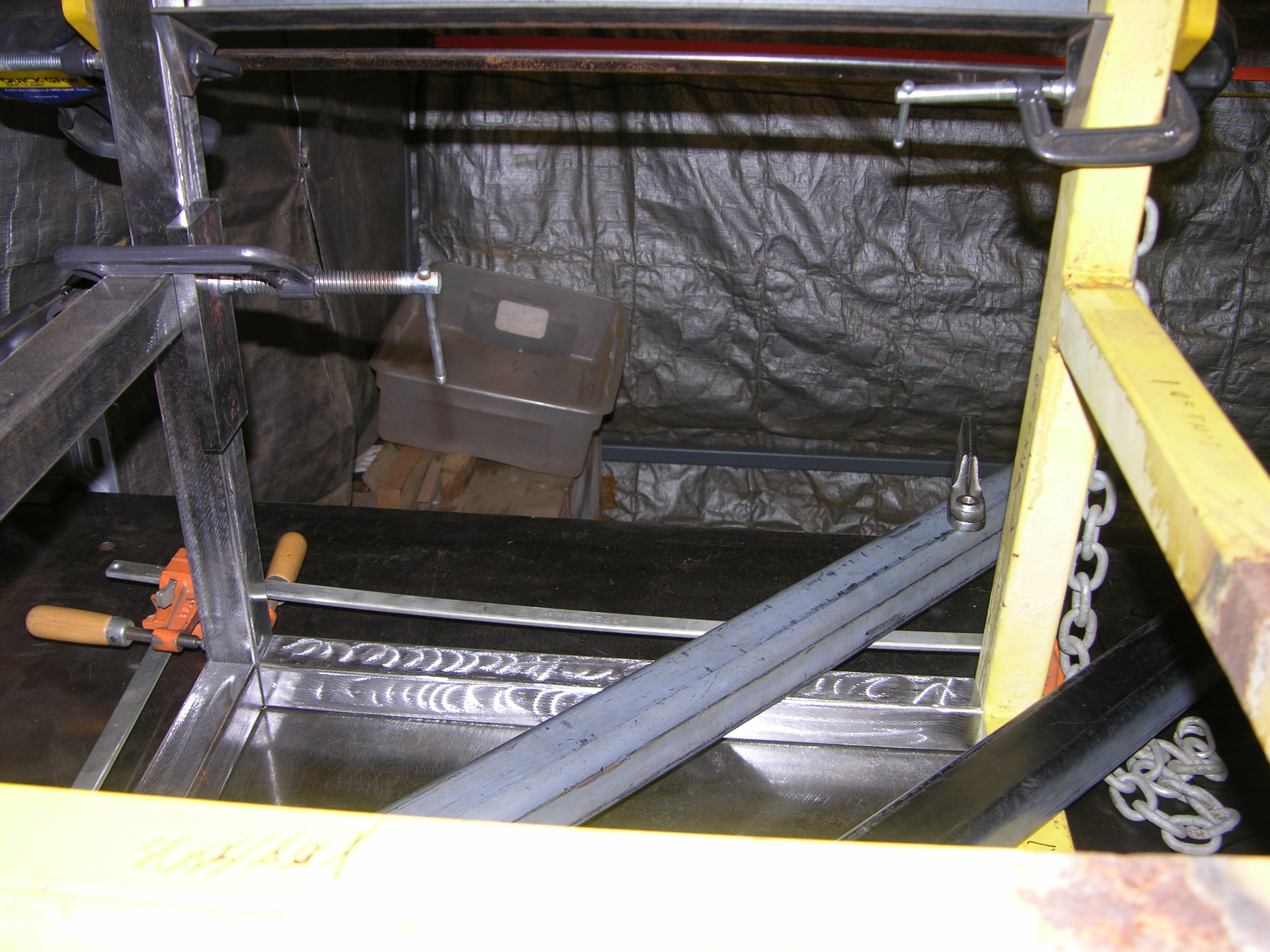

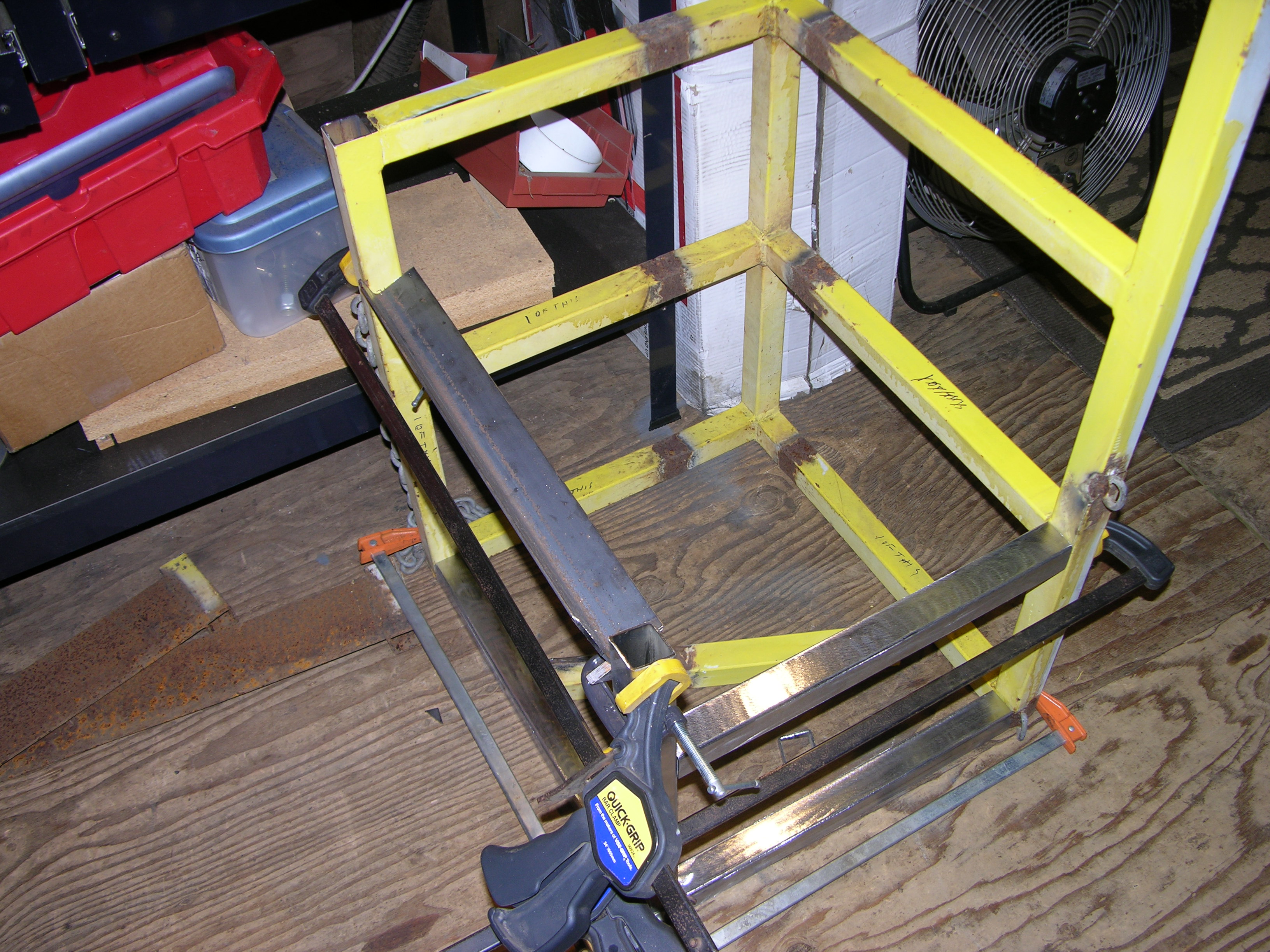

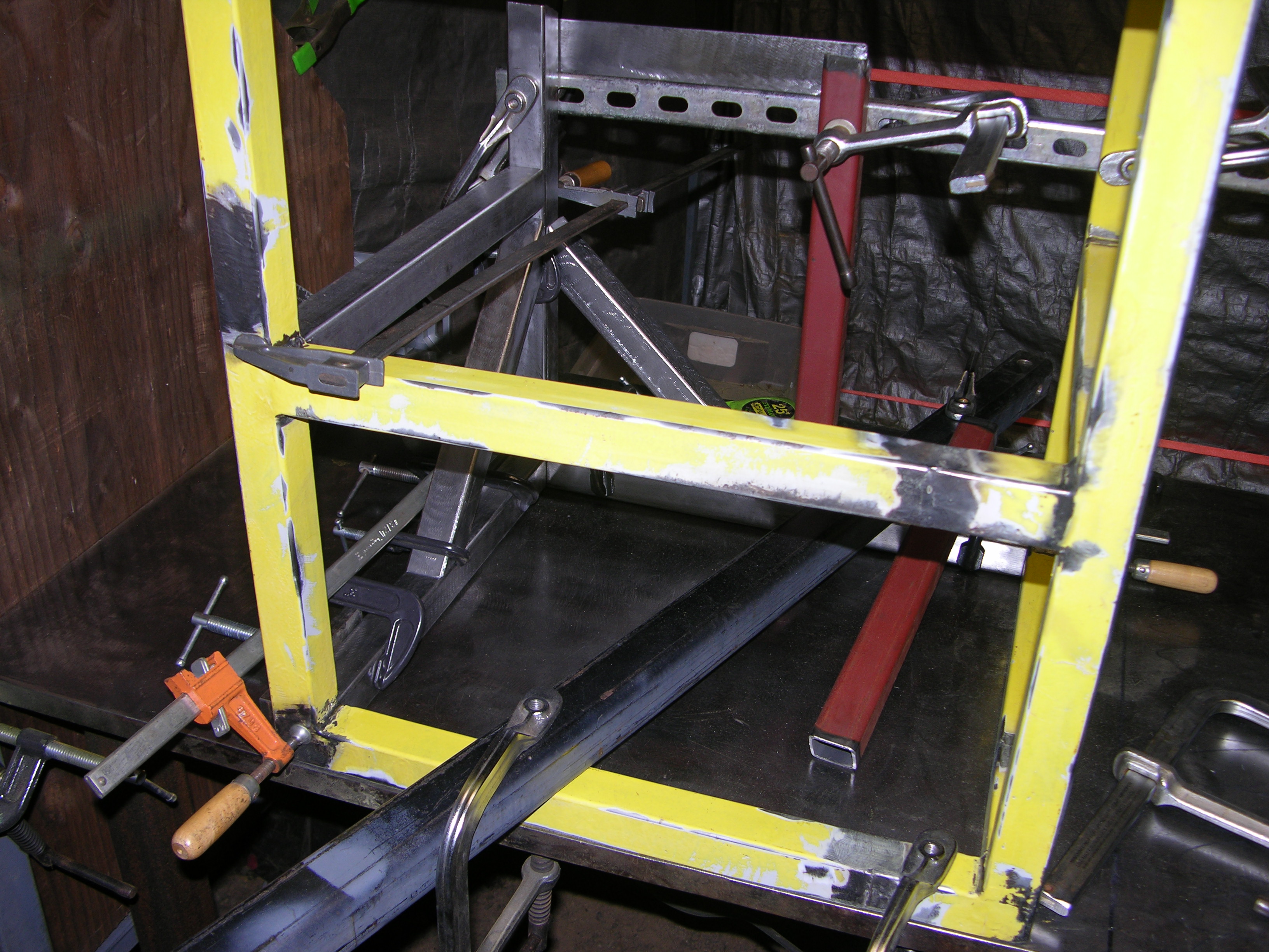

Speaking of which, got just about ready to tack pieces together for the cart - right now everything's clamped down to the 1" thick table and will only get UN-clamped when it's stone cold - when it's done, the 211 will sit on neoprene pads and be strapped in place, the 150 CF bottle will get locked into the corner beside the welder, and the two tallest uprights will get 1-1/4" tube inserts and a cross bar that's about 2" taller than the top of the gauges - it'll act as both a "roll bar" and a "hand truck handle", wheels will be 2 13" tires (offroad use, sorta) and 2 locking urethane wheeled casters for when it's upright.
I should get most, if not all, the welds done manana (doesn't mean I WILL :laughing: ) Anyway, here's today's doodles... Steve
(Oh, the unistrut is NOT part of the design, it's just holding the spacing between the rear uprights til it's welded out)
