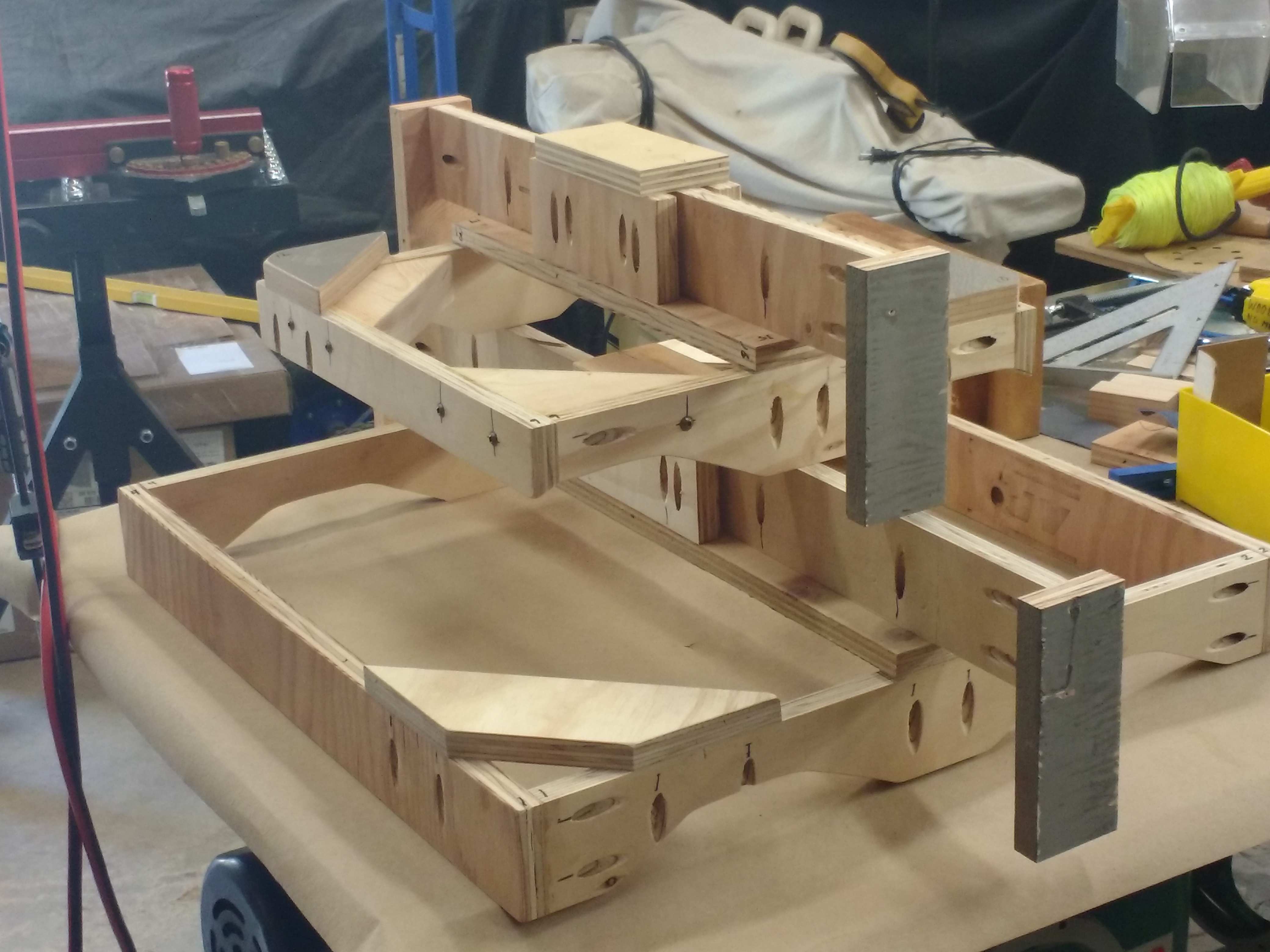

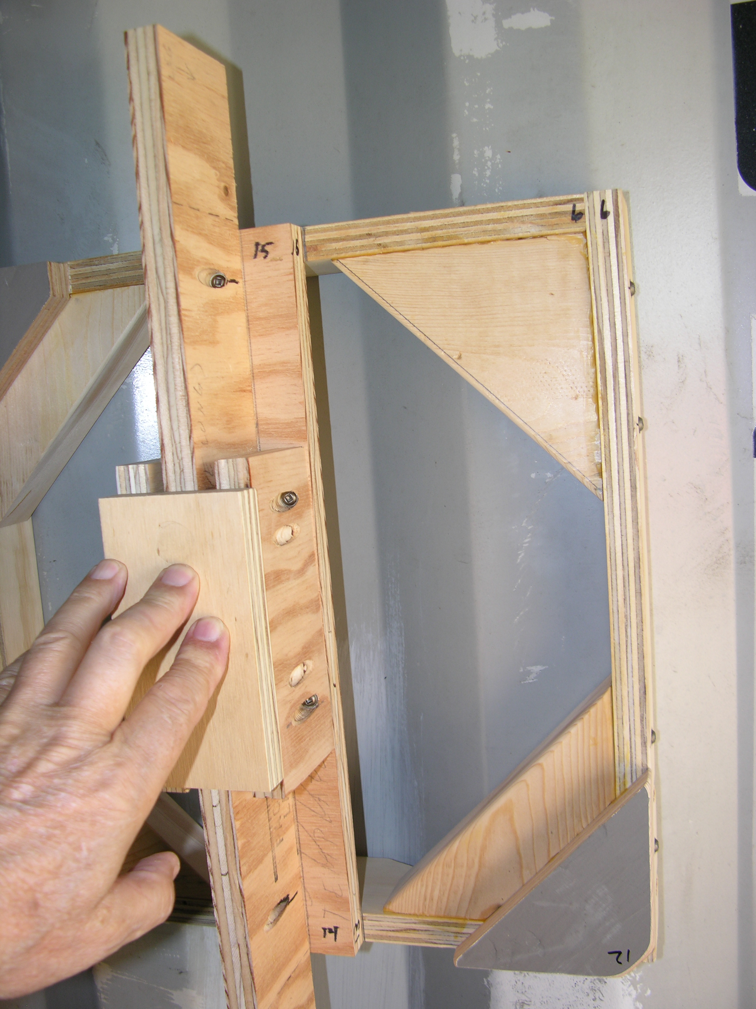

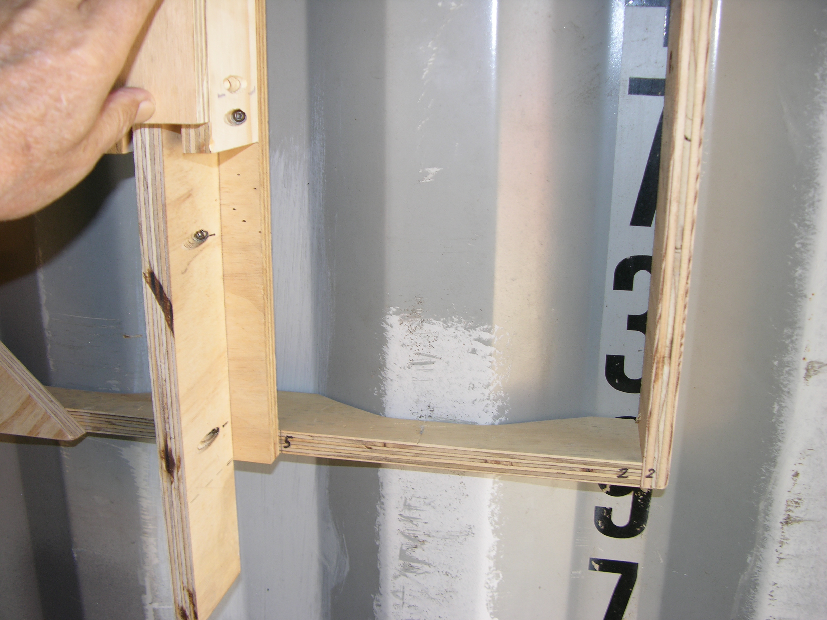

As usual, the weather man LIED - it was 93 in the shop when I quit, woulda gave up sooner if it wasn't for a healthy dose of bull-headedness and a 30" pedestal fan on high, aimed right at my head :laughing:

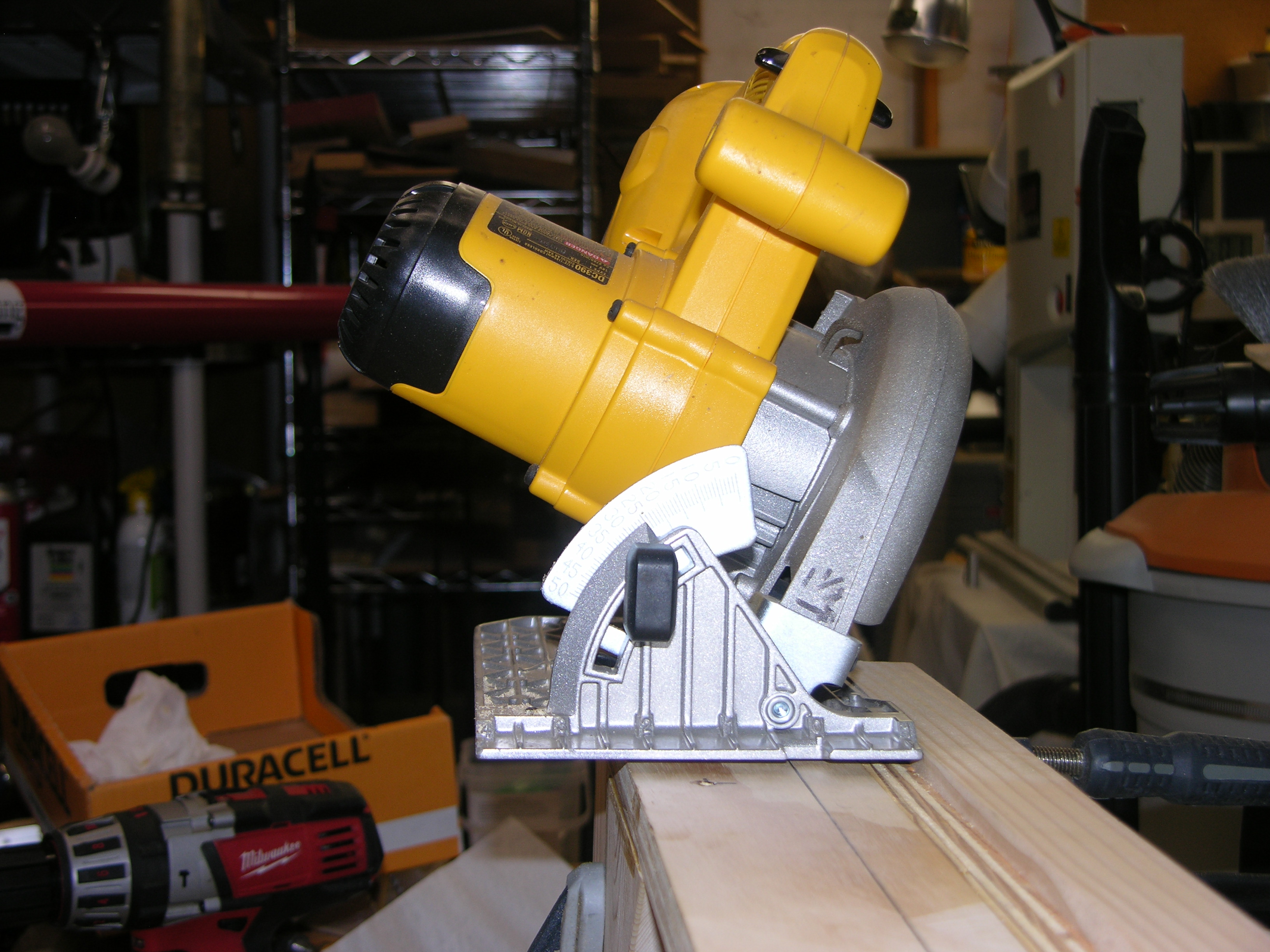

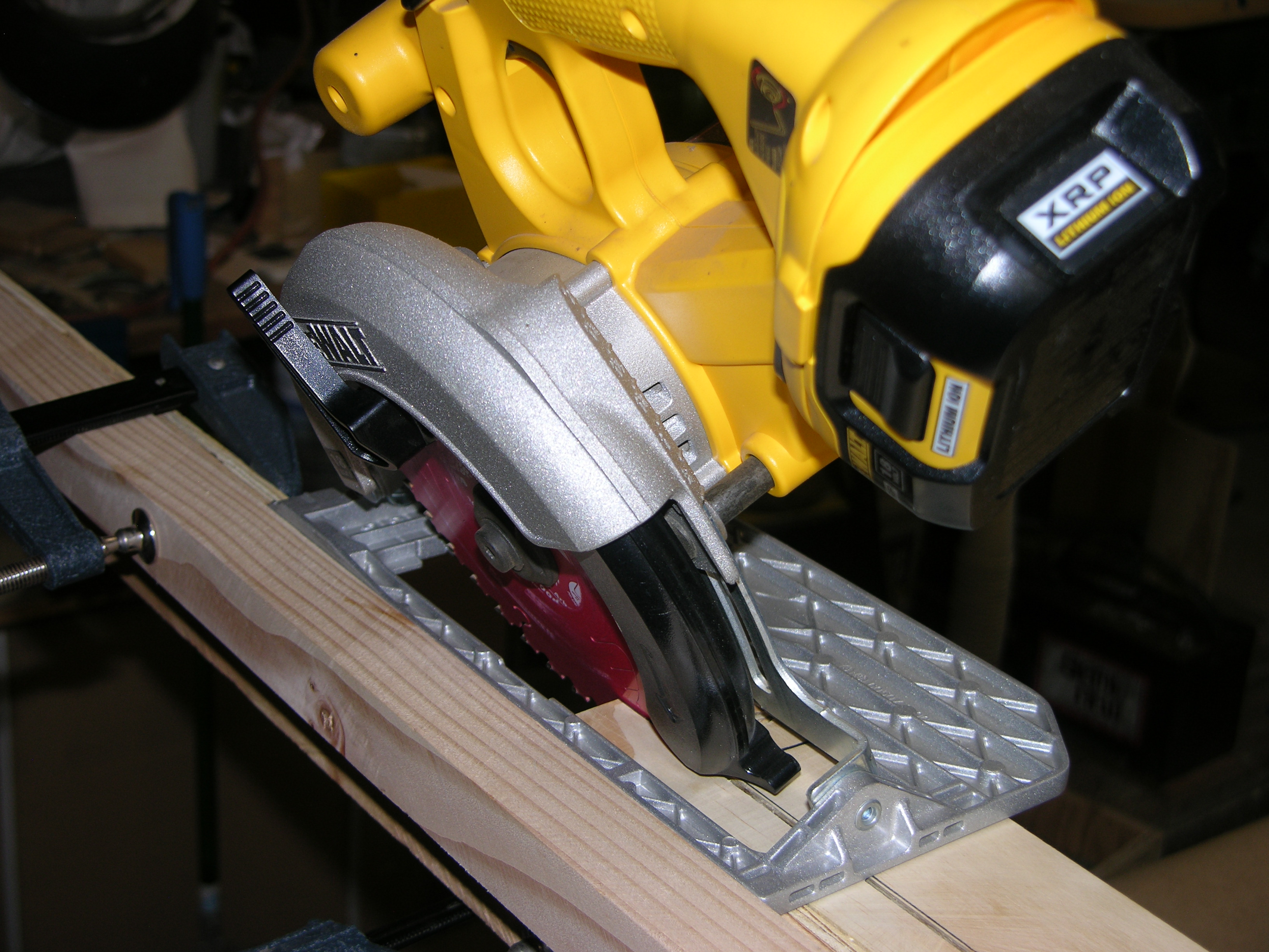

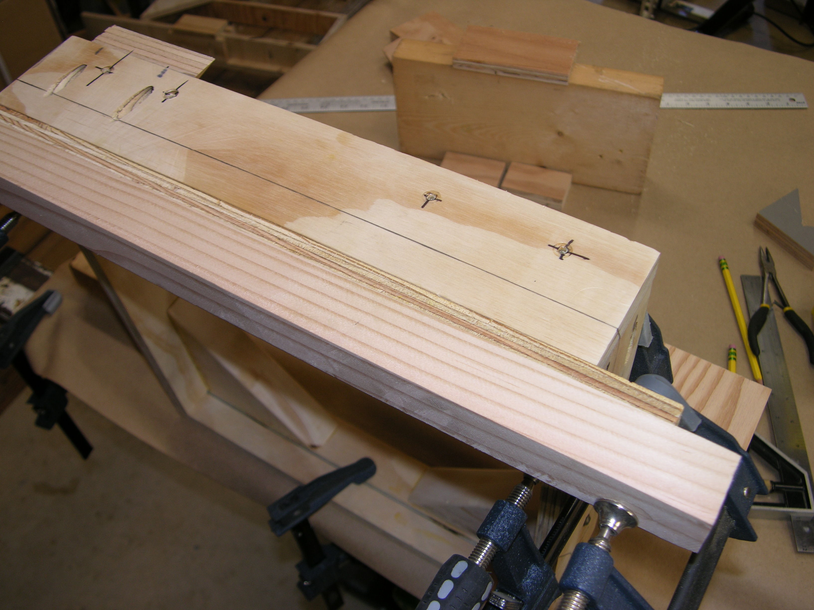

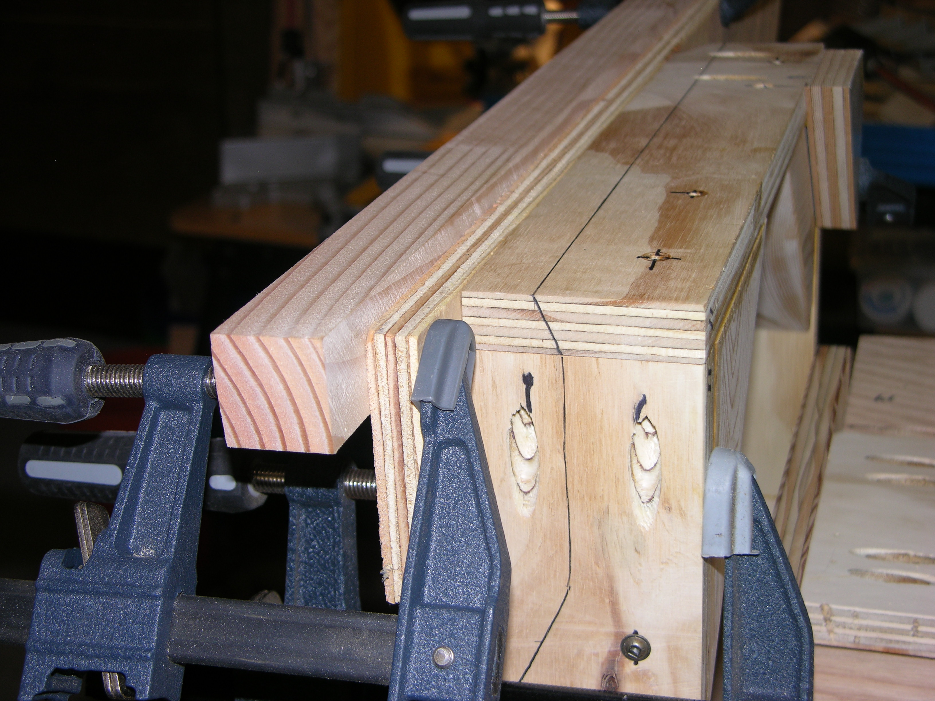

Here's the results of my stubbornness; these pics should help clarify what I tried to explain in the previous post - if not, I'll explain later when I'm not drug backward thru a knothole :thumbdown: ...Steve
OK, fine; the SHORT version - imagine one of these
Amazon.com: Stoneman Sports QSP-36 Sparehand Steel Adjustable Cargo Bar for Trucks Vans and SUVs, Red Finish: Sports & Outdoors
in place of my hand in the bottom pics - then picture a plasma torch being drug around the outside of the wood frame til a piece of the wall falls out (this will be done from the INSIDE) -
Now, if that happens BEFORE I do one final step, the template would fall out along with the piece of corrugated wall - NOT good, so there will be 2 more "spider legs" screwed to the protruding ends of those long boards across the center of each template; those will ALSO touch the wall - that way, when the cut is finished those "spider legs" will hold the template where it is, and only the cut out piece will fall (I hope) :D

I looked at 4-5 vids on scribing, you're right - it's pretty easy to explain scribing to somebody who ALREADY KNOWS about it and how to DO it :rolleyes: - I never did find one that wasn't a complete waste of time...
So I just ordered some accessories that'll let me set my phone up on a tripod (I have those for previous video productions I used to do for industrial safety vids) - the stuff I ordered includes a wireless remote for controlling the phone as a video recorder, plus I ordered a tripod adapter for my 7" tablet too (easier to see what you're doing on the bigger screen) - That stuff should be here in about a week, then I'll see if I can make a vid that's worth watching (got a couple awards on my safety vids, so there's hope :laughing:)

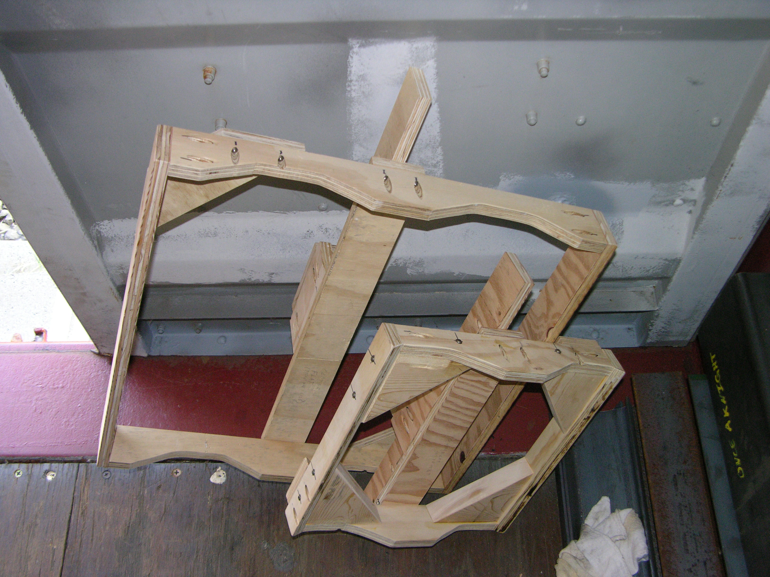

In the meantime, do yourself a favor - FORGET the dang "high dollar compass", just look at the bottom 3 pics - they were actually shot INSIDE the container, and show how the pattern will sit against the corrugated walls. There's enough in those pics to get an idea how my pattern will work, and we can go back to the "scribing of the squiggles" fiasco AFTER I figger out how to make vids with a phone instead of a few thou of REAL gear :rolleyes:

Got a chance to grab a pic of the 2 patterns, complete with "spidey legs" (the ugly gray add-ons) - Patterns4Vents.jpg
Manana's 'sposed to be cool again, I'll probably take advantage of that and re-do my two grab hook inserts - they were startin' to get a little rusty anyway, good excuse to shoot 'em with more of that UGLY gray paint :D ...Steve

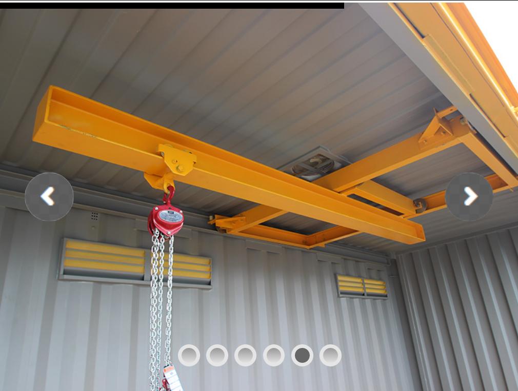

Got my hair whacked this morning, then found this pic
On this site
Dangerous Goods Container with Gantry System
I'd been thinking of a way to extend the container crane OUTSIDE the box a bit to make it easier to transfer things in/out of the container, looks like a few mods to my design could pull this off. Good thing I'm nowhere near actually BUILDING the thing yet :laughing: ... Steve

Some people consider themselves lucky to have enough hair to whack.....I'd want that crane to swing out to the side also, if the side was open, if not that looks like a good way to bring stuff in and out of the container, atleast from one end anyways.

Got a chance to grab a pic of the 2 patterns, complete with "spidey legs" (the ugly gray add-ons) - View attachment 566394
I'm still not getting the the need for two different size wooden box patterns with all the pocket hole screws, except for wanting to use a pocket socket jig. To me one pattern one fan.
