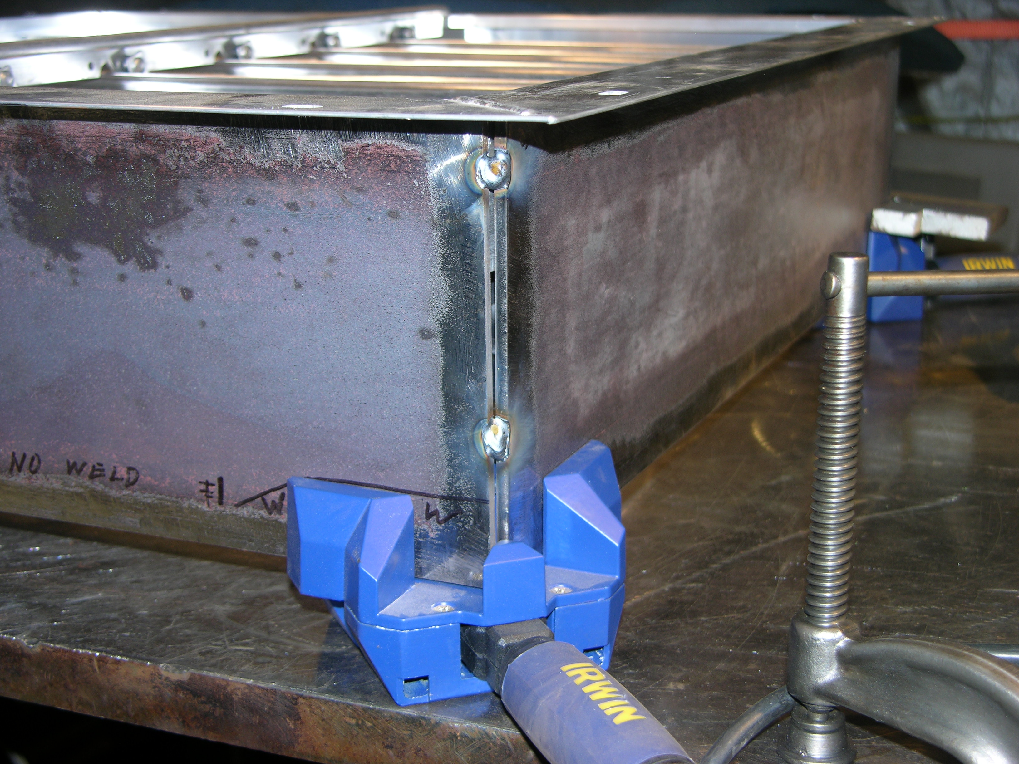

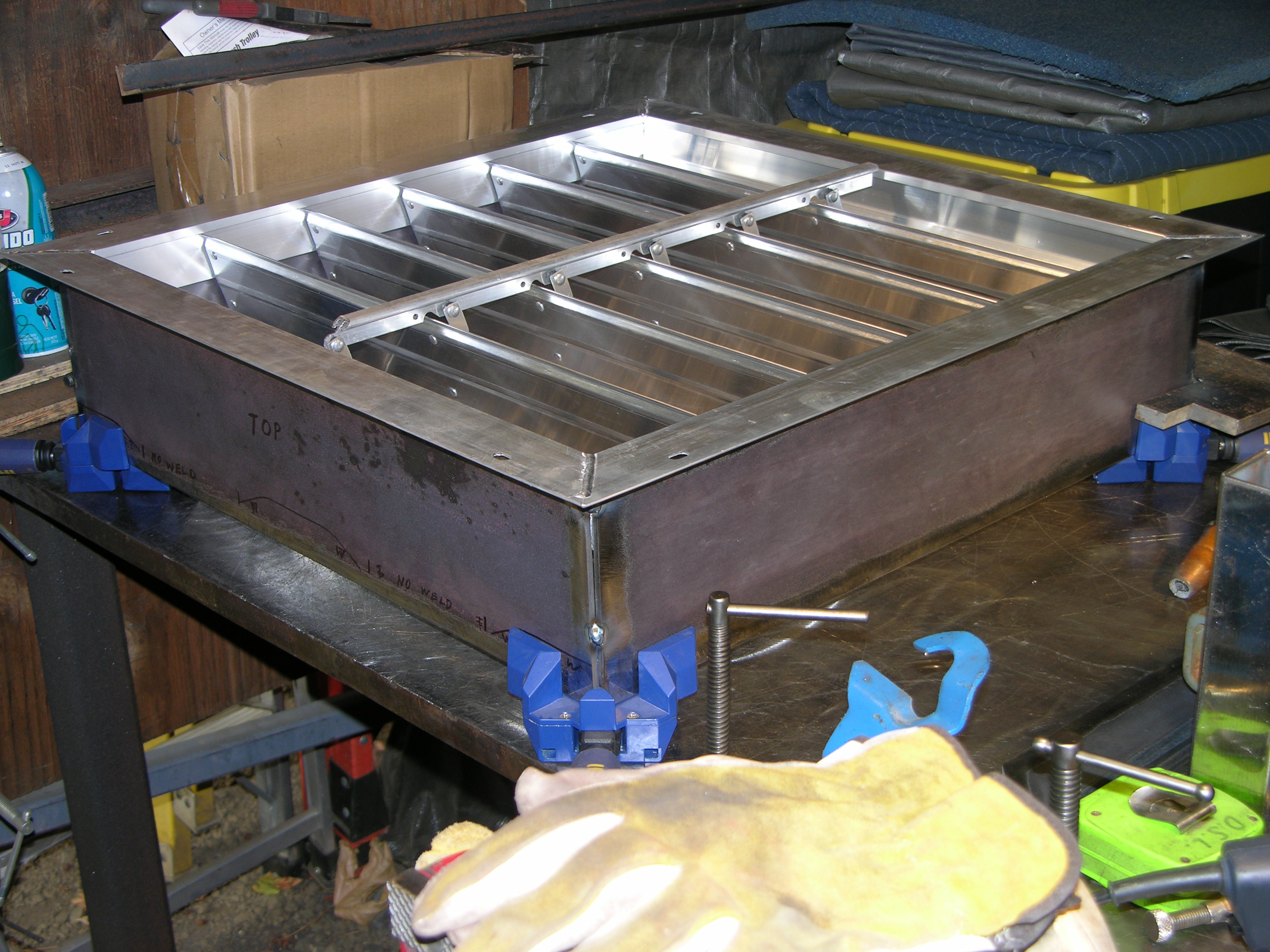

Got a little more done on the bigger louver insert today - a test fit after tacking the 3/16"x6" sides together; if it looks like the corner gap is a bit bigger at the top of the joint than at the bottom, it's 'cause it IS - when I was checking sizes, etc, I didn't notice that the pivot points for each louver stick out about 1/16" past the aluminum frame, so the part of the steel insert where the louvers mount needs to be just a little wider than the rest - too late to start over, so I just clamped the sides a bit further apart at the top before I tacked 'em -
View attachment 567743 - it's easier to see in this pic - View attachment 567744 :laughing: ...Steve

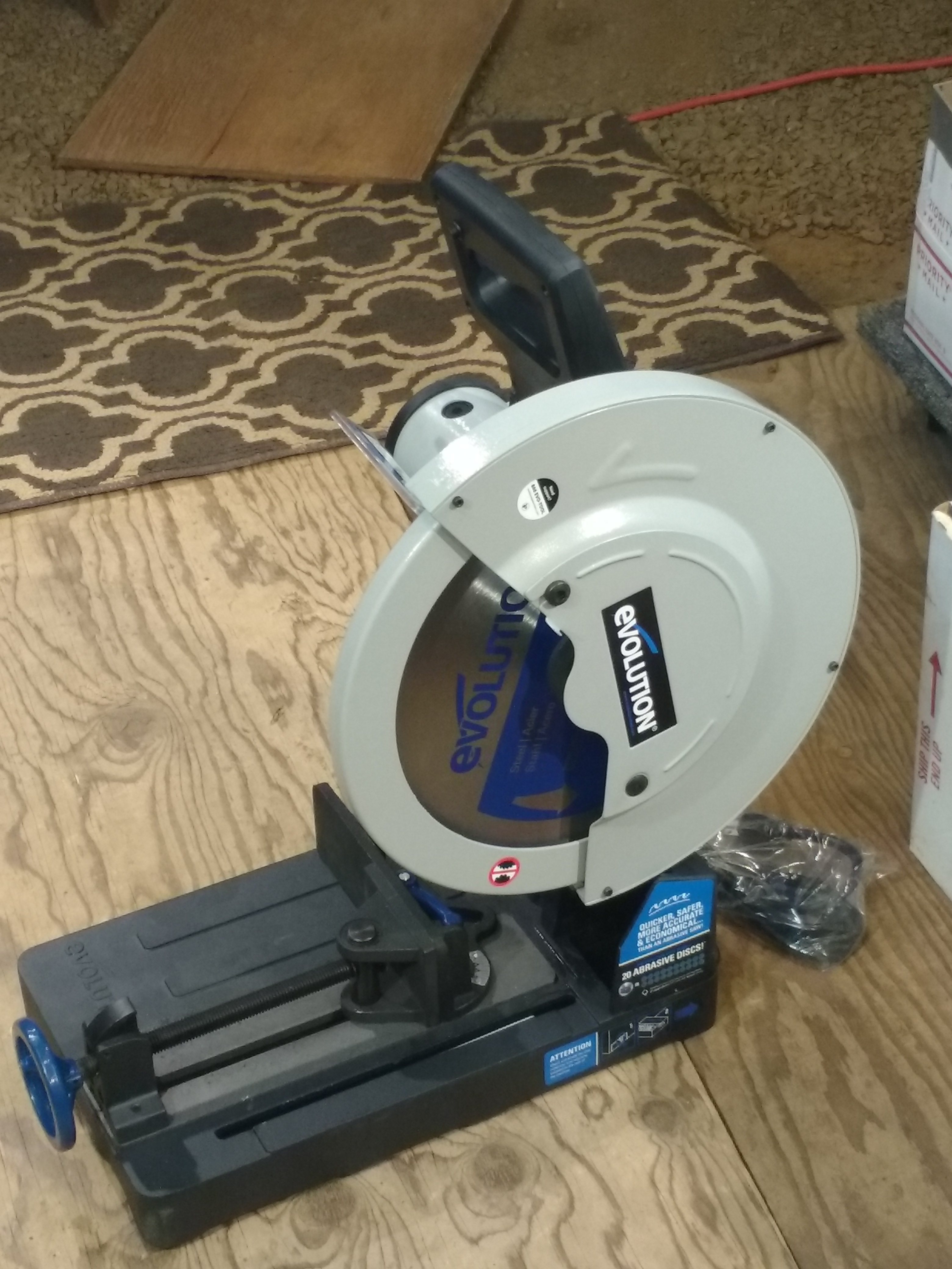

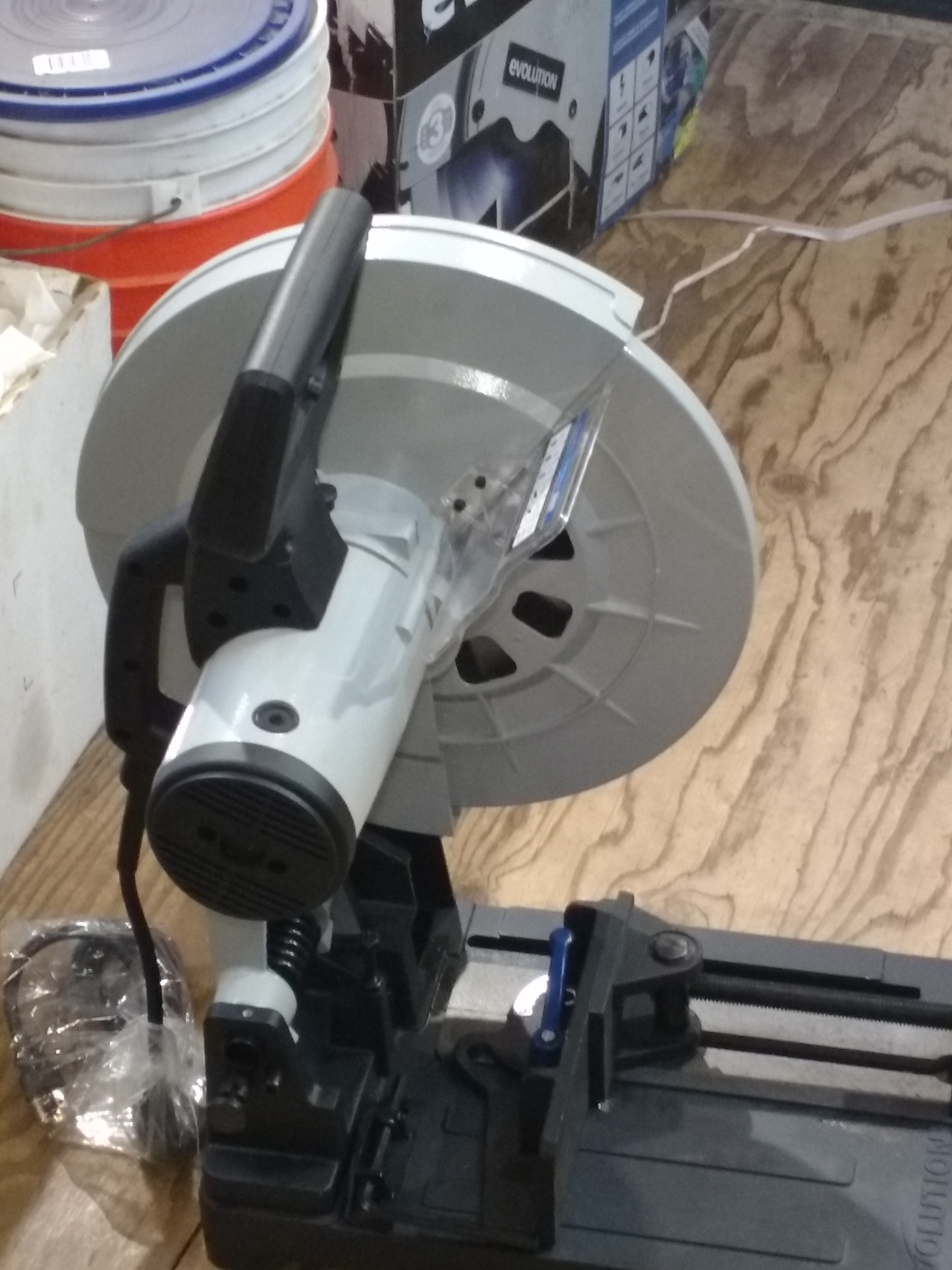

What you think of this for cutting steel, you have something like it?>>> Evolution Power Tools EVOSAW23 9-Inch Steel Cutting Circular Saw - - Amazon.com
It sure is a handful and dont see much out there for competition at the same around about price. I could've sure use that this past month trying to cut 3 pc of 1/4"x 27" a straight cut is lot nicer to weld. I usually can cut nice and straight 2-3" with torch, it's just so hard for me to maintain a constant burn speed while holding the torch steady and it gotten harder as the years go by

"What you think of this for cutting steel, you have something like it?" Similar, sorta - I wasn't sure how much I'd use a "skil-saw" type, so I got one of these
7-1/4 in. 12 Amp Heavy Duty Circular Saw With Laser Guide System on a coupon for $29, and one (two, actually) of these
7-1/4 in. 48T Metal Cutting Circular Saw Blade
I have 3 OTHER skil saws; a worm drive, a left-blade Porter-Cable, and a DeWalt 18 volt - I use ALL of them at various times, but usually for fairly precise stuff and ALWAYS only on WOOD, so I wasn't willing to destroy ANY of those for a "maybe" (That particular Porter Cable is no longer available, so if anybody tried to walk away with it I'd probly "fire a WARNING shot to the HEAD" and THEN ask 'em what they were doin'....
Anyway, the HF stuff works OK for up to maybe 1/8", I've used it several times cutting 16 ga. sheet metal - but that saw is nowhere NEAR as well-guarded as the EVO, so I ALWAYS use a full face shield (and gloves) with it. It IS real easy to clamp a piece of angle to a sheet and get those cuts almost as straight as an Iowa road :thumbsup:

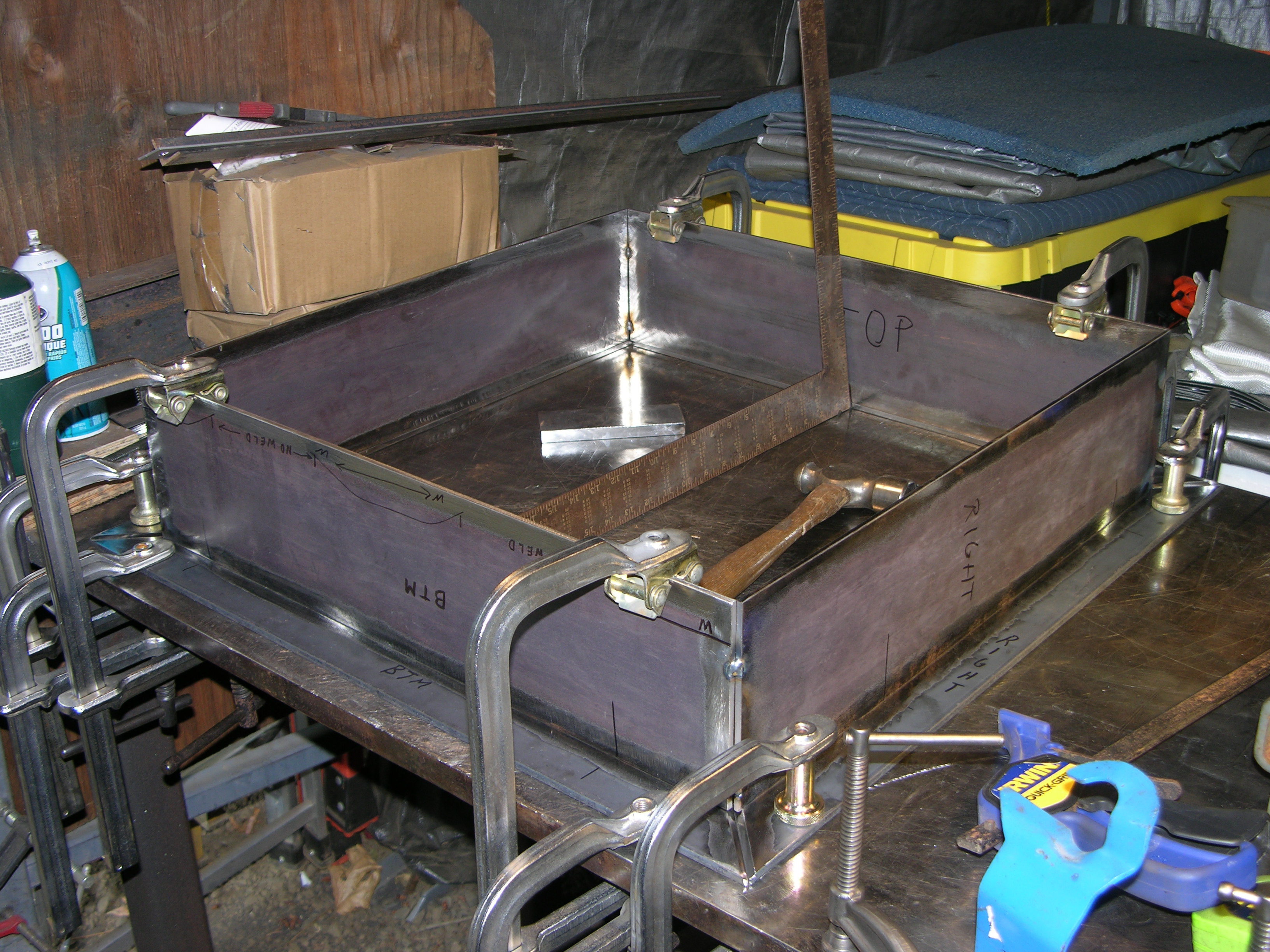

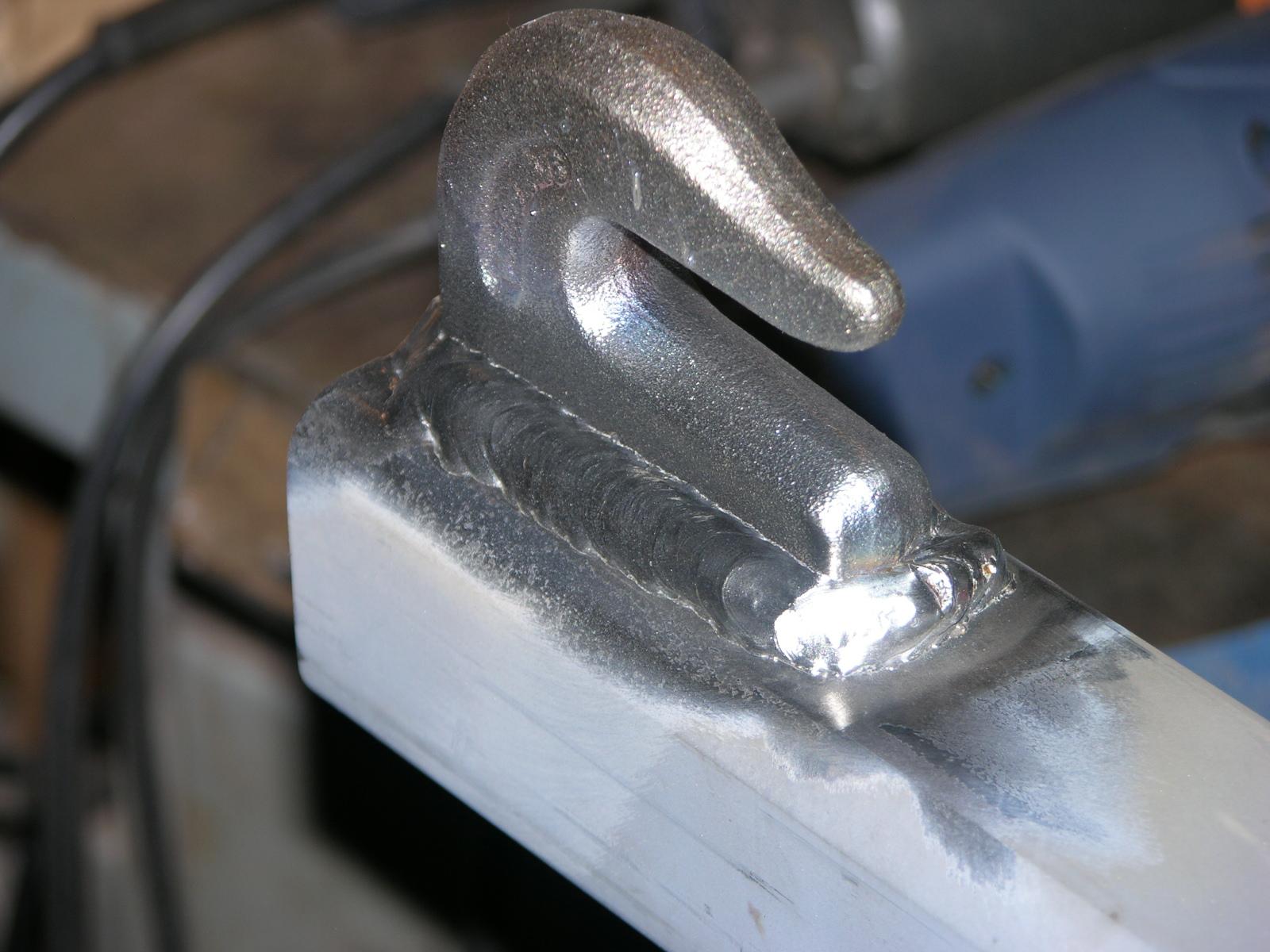

It started gettin' too warm about 10am, so all I got done today (even WITH 2 fans helping) was beveling the 1/4x2 FB "flange" pieces, then clamping everything down to the table starting with the (mitered) flange pieces, making sure everything was exactly spaced (and SQUARE) like it needs to be (24-1/16" between horizontals and 24-1/8" between verticals for louver pivot clearance) - then lining up the previously tacked 3/16x6 "shadow box" frame, pulling it a little bit til it lines up with the mitered frame - bottom line, it's al ready to tack and weld.
DSCN3408.JPG (Did I mention how much I LOVE Stronghand 4 in 1 weld clamps??:thumbsup:

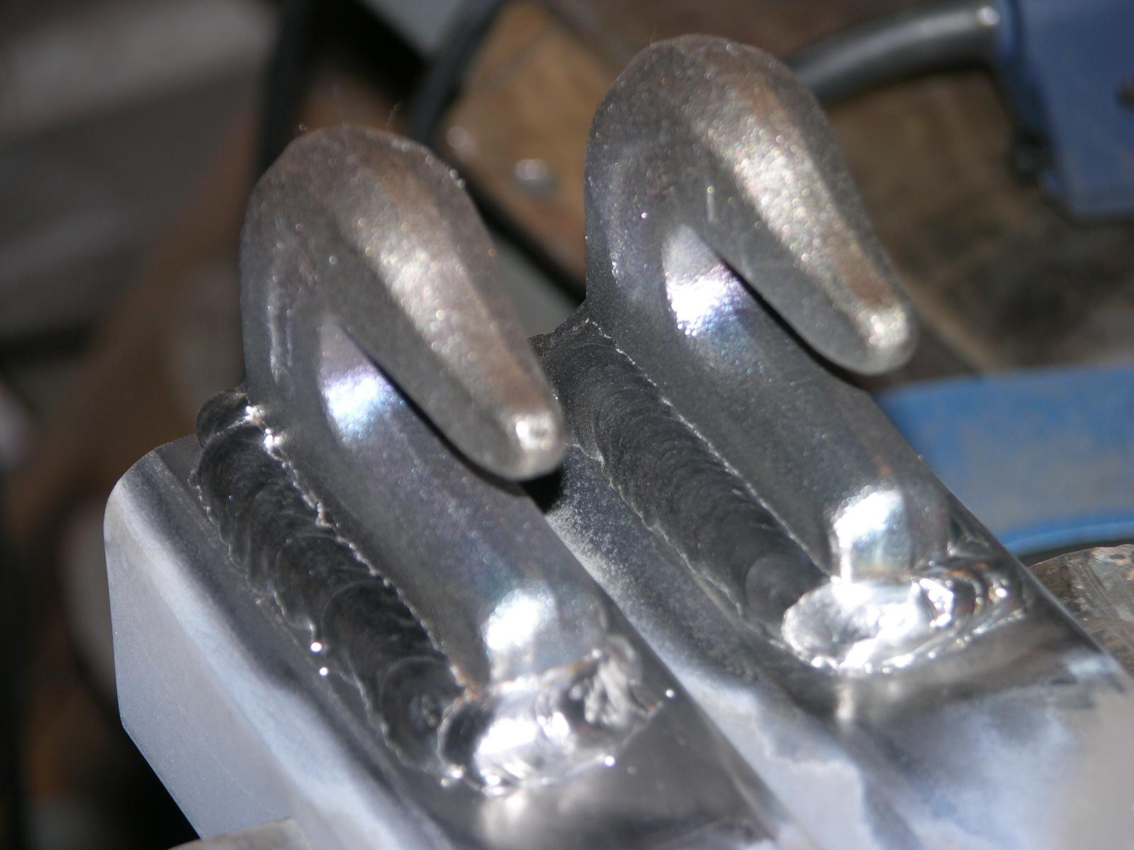

The DOWN side - it's 97* outside in the shade, so it's gonna wait til manana for the "sparky thang", it's only supposed to be 80 tomorrow, and low 70's the NEXT 4 days. Hopefully I'll get this frame welded out, and maybe even have time to add 1/2" grab hooks and swivel D rings to my chain hook inserts - right now they only have 3/8" grab hooks - the 1/2" hooks will go on the opposite side, and the D rings on one of the two sides NOT already used -
Sorry, thought I had pics of the add-ons :confused: The 1/2" hooks (and probably the D rings) will get used when I lift the two hi-cube containers onto my "mil-spec lego blocks", along with a 1/2" Gr. 70 chain (1400 lb. WLL) - I don't really trust my 3/8 "regular" grade chains with just under 3 tons per end, even tho I will NEVER have any body parts "in between a hard place and a hard place"
