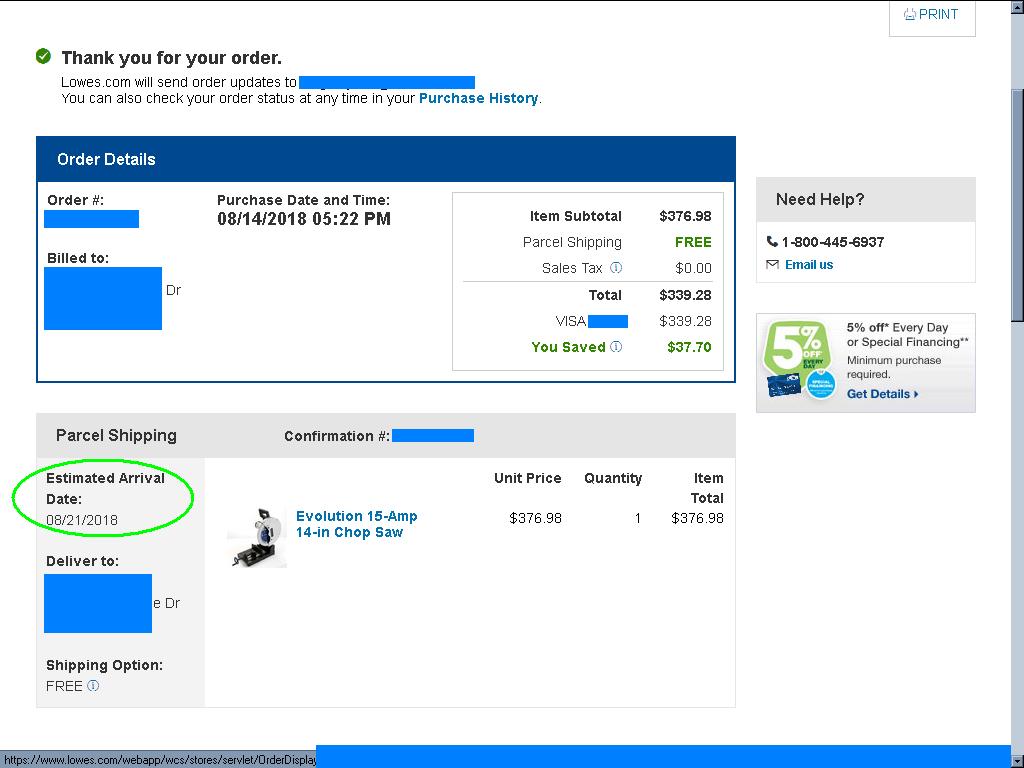

Speaking of which, I finally quit putting it off and ordered one of these
The military discount puts that price about $20 less than the saw goes for anywhere else on the net, and it'll come in handy soon since I STILL haven't ordered a new bow for the Jet bandsaw (that'll hafta wait til it's raining again, too much to get done to wanna open THAT can of worms when there's perfectly good project weather :D )

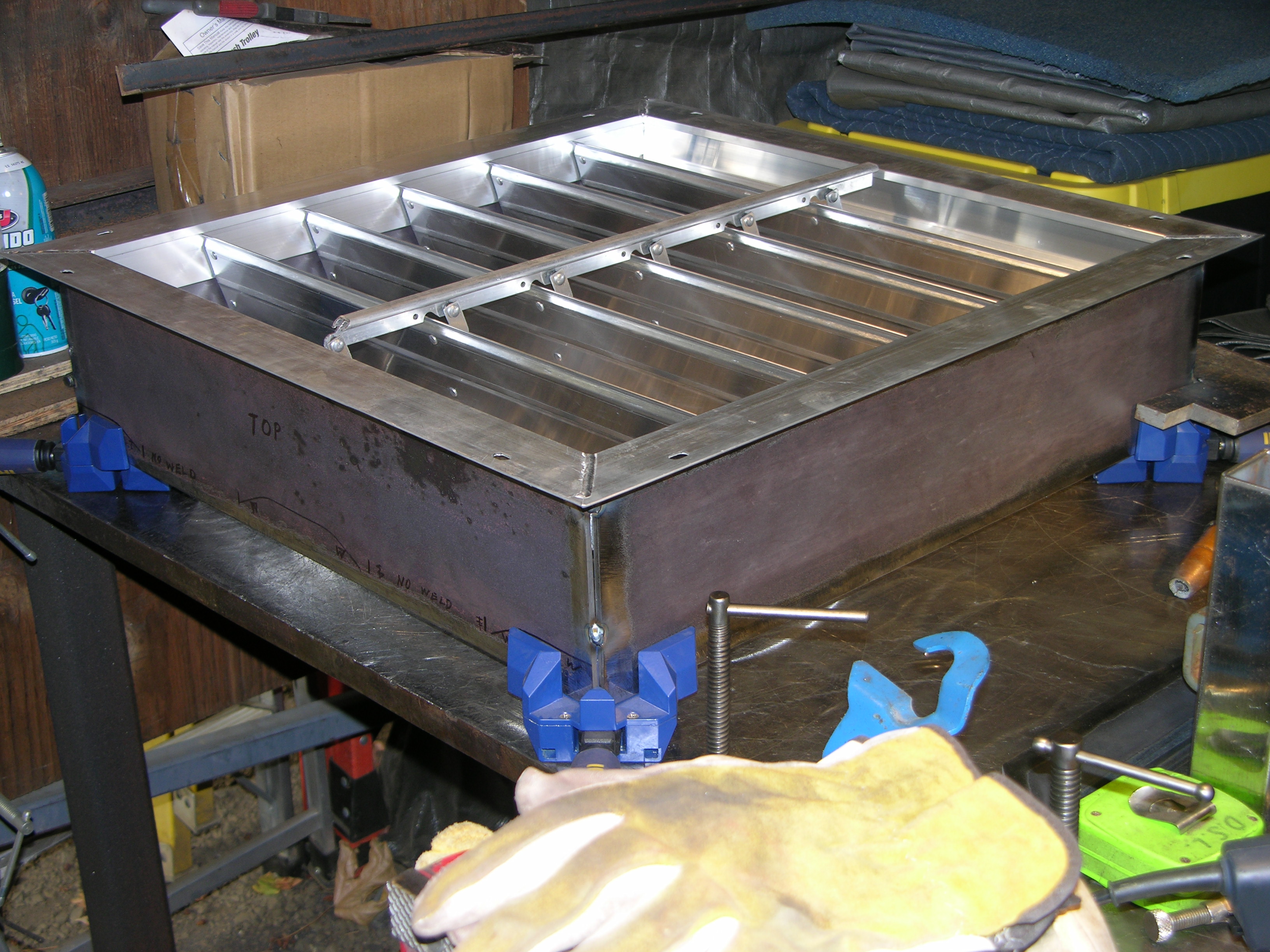

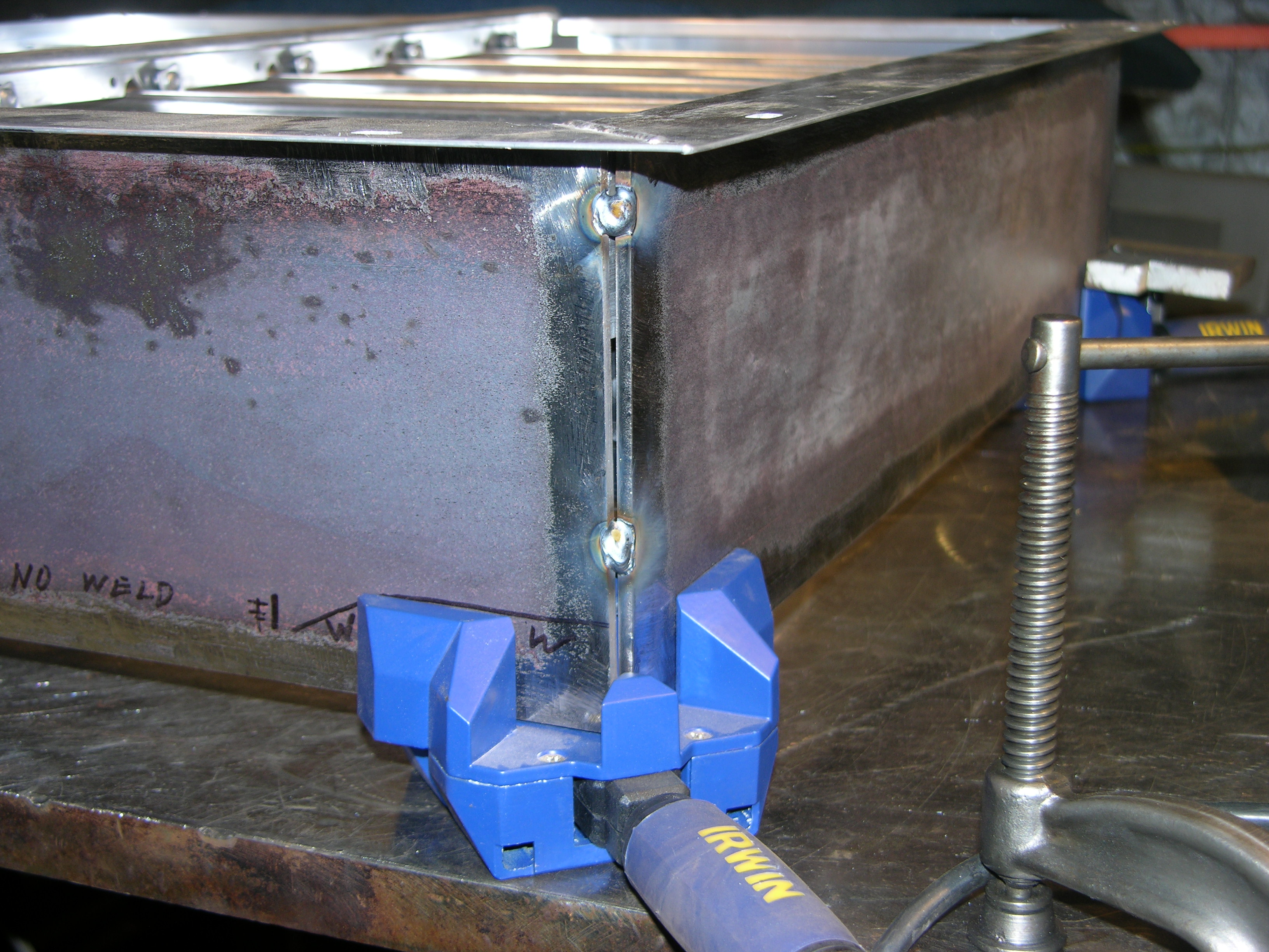

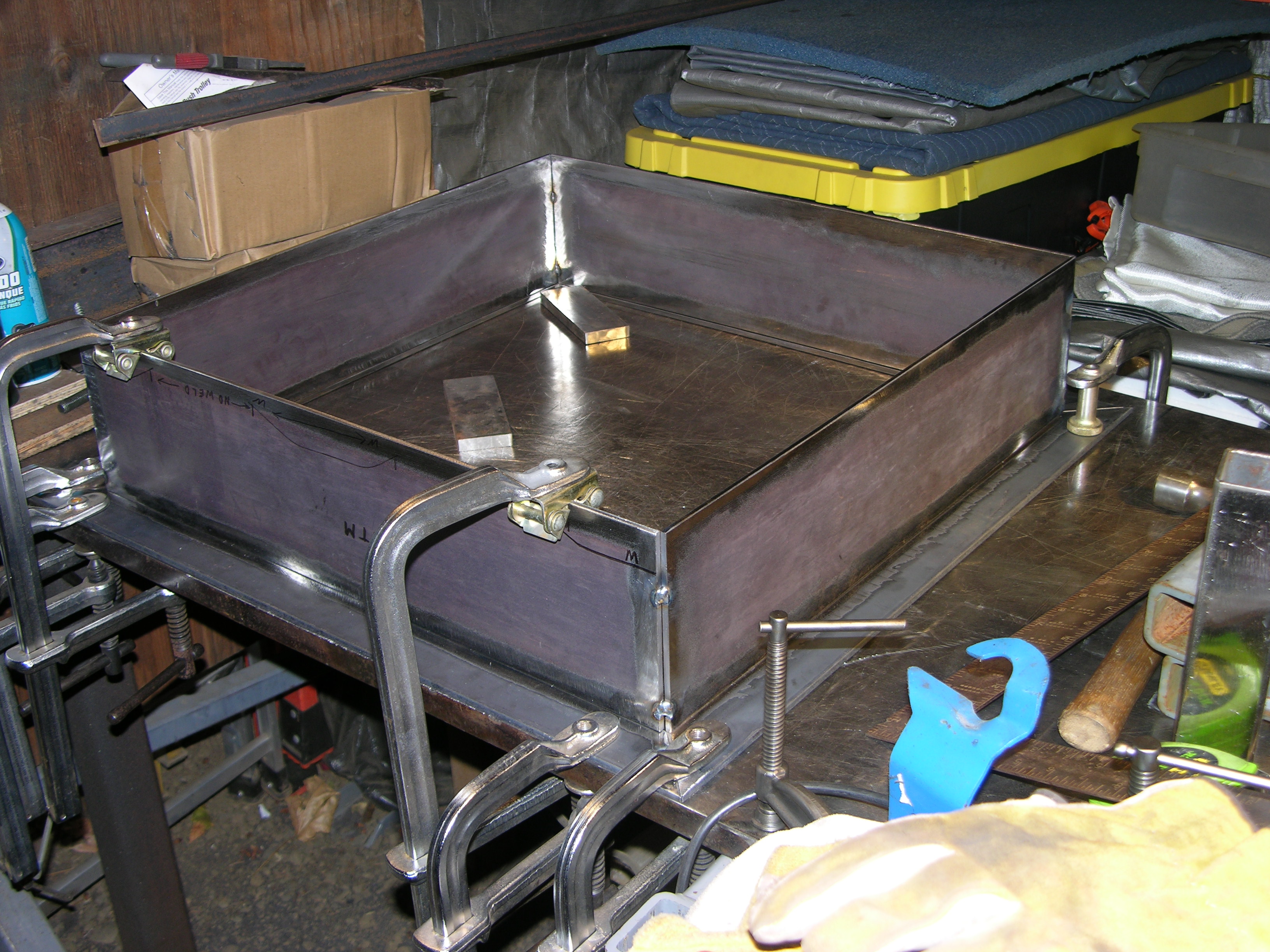

Got a little more done on the bigger louver insert today - a test fit after tacking the 3/16"x6" sides together; if it looks like the corner gap is a bit bigger at the top of the joint than at the bottom, it's 'cause it IS - when I was checking sizes, etc, I didn't notice that the pivot points for each louver stick out about 1/16" past the aluminum frame, so the part of the steel insert where the louvers mount needs to be just a little wider than the rest - too late to start over, so I just clamped the sides a bit further apart at the top before I tacked 'em -

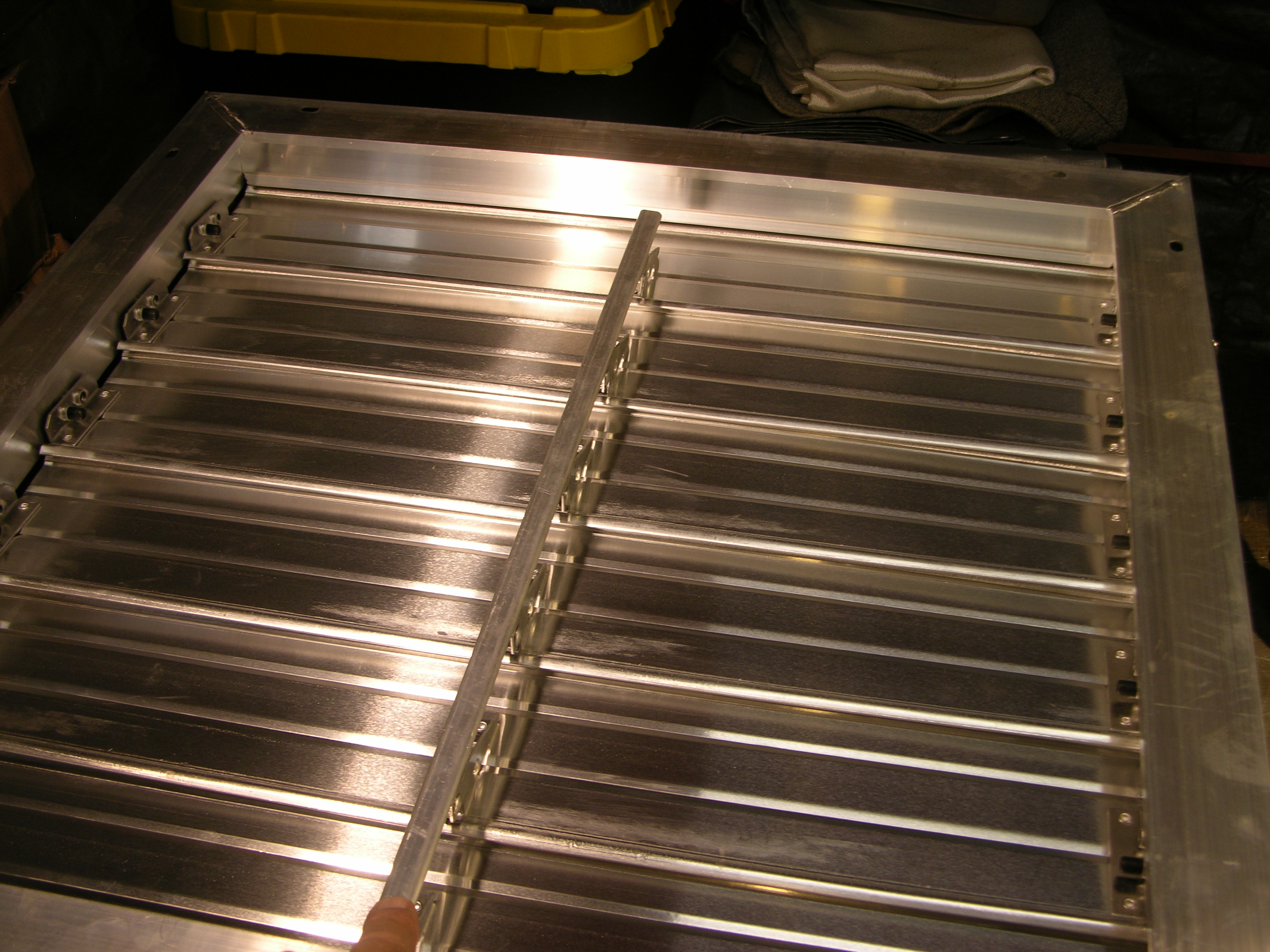

This is what the louvers look like open and closed; that bar down the center gets a spring/chain/actuator motor. Gravity closes, motor opens by pulling the bar downward - DSCN3405.JPG DSCN3406.JPG

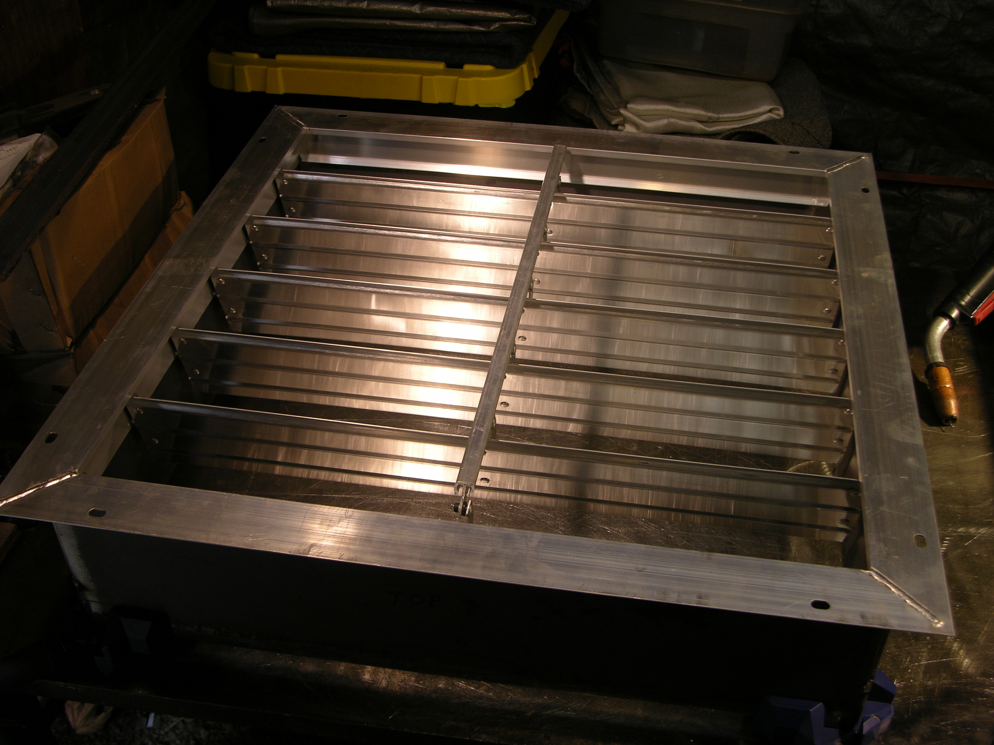

The 1/4"x2" mitered flat bar that's clamped to the table will get welded to the vertical pieces, then the whole assembly (minus the louvers til later) gets welded into the hole that'll get cut in the container wall - then, from outside to in will be 1/2" 1018 cold roll rods vertically every 2" across the opening with another welded in the center horizontally (for 2-legged varmints) - inside that will be 1/2" hardware cloth (smaller, 4-legged varmints) then a window screen/frame - the louvers themselves will protrude into that frame by about 4" or so, that's why the 6" sides - otherwise the louvers would hit the screen. DSCN3407.JPG
Then the aluminum framed louvers will get bolted to that 1/4"x2" mitered steel frame, that way I can clean/change/replace louvers if necessary (AND clean the screen), WITHOUT the 2-legged varmints being able to unscrew anything that'll give 'em access.
