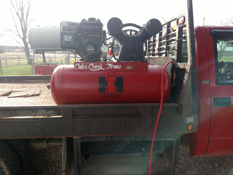

#12
Well here it is should work for what I want it for. I used a old tiller motor that is a 6.5 Briggs, found a twin cylinder pump at a yard sale and ordered a IR pressure kick down bull whip, and mounted it all up! Hardest part was getting it to idle down and rev to the max rpm. It builds up to 120 psi pretty quickly. It will come in handy for fixing flat tires and blowing of balers! No more running back to the shop!! Of course I had to put my farms name on it and a IH logo! All in all I have about 200 dollars in it.

The go kart clutches I have seen all work from centrifugal force, like a chainsaw.
Any car with an AC compressor on it would have an electric clutch though.
All compressors have check valves in between the compressor and tank. On electric ones they are so there is no head pressure on the compressor to have to over come when it kicks back on (the hissing sound you hear when the compressor shuts off is the bleeding of the line).
On gas compressors they are there to not stall the engine at idle and let compressed air bypas the tank until internal pressure falls enough to throttle up the engine and shutoff the bypass.
