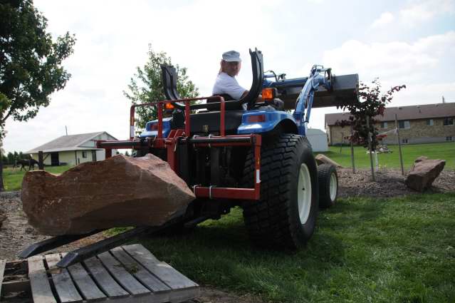

I hear what your saying.....just a fabulous addition to the TRACTOR. Moved some rock for the first time yesterday after getting the cylinder. I moved more rock in two hours than I could in a previous day.
Thanks to the guys here, I took their advice & got the remotes installed as part of the deal when I bought my dynamo. That made it cheap & simple to install.
The attached pic shows the biggest rock I took delivery of this summer......all 5400 Lbs of it......boy do I love BIG Rock !! :D

Let me get this straight... I can't get rid of rocks fast enough and you're bringin' 'em in??LOL
BTW, my hydro top link from Carter & Carter just arrived....
If it weren't for rocks, the Adirondacks would be in a very deep valley!
If you'd like to take a road trip, I'll make sure you leave with a lifetime supply... Free!! LOL
