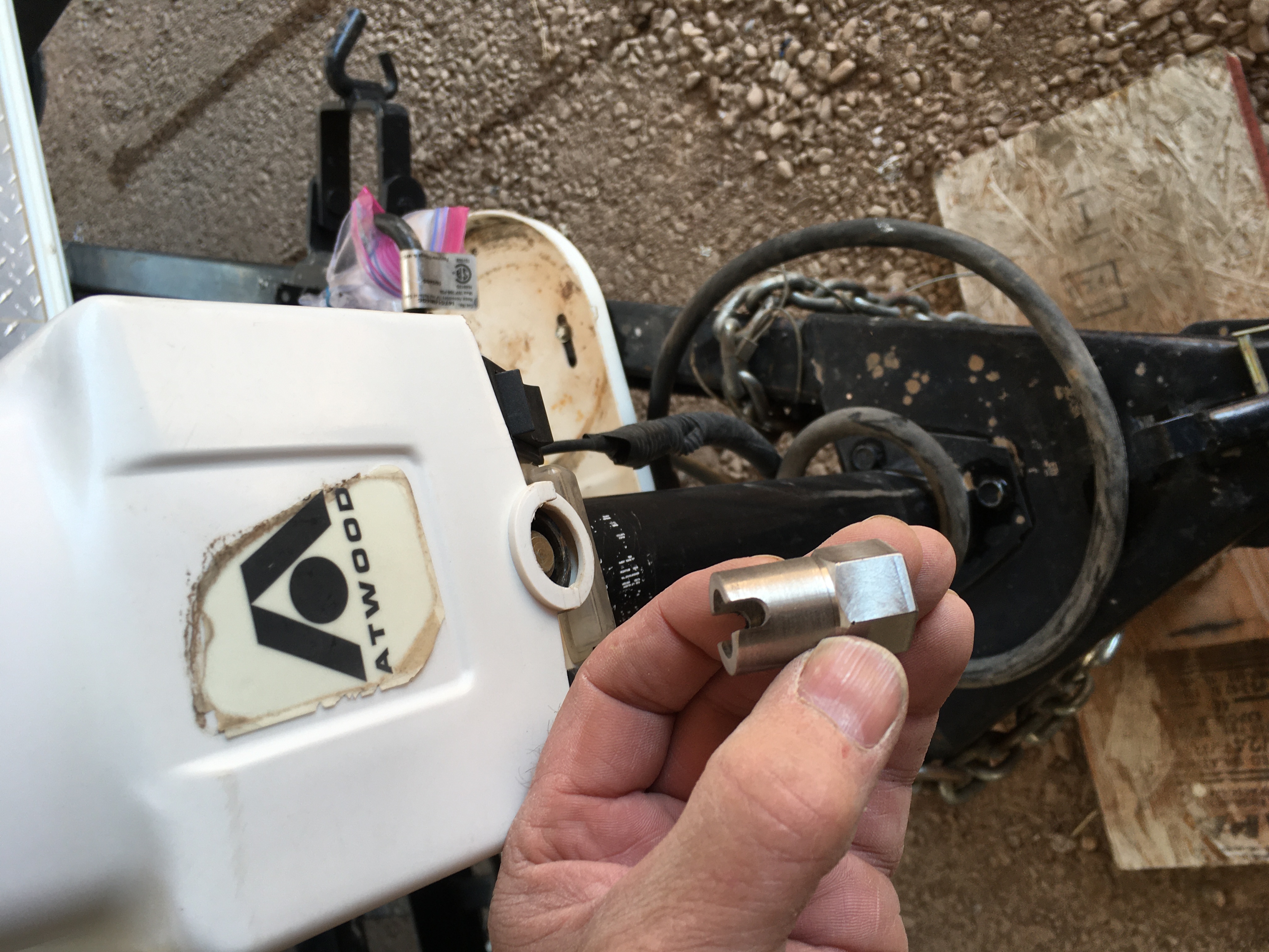

This is an adapter I made for my travel trailer in case the motor went out on the electric jack. I don't know why a person couldn't make something similar for an equipment trailer. It was made to use a 3/4" wrench, crescent wrench or cordless drill with a socket.
That’s exactly the sort of thing I need.

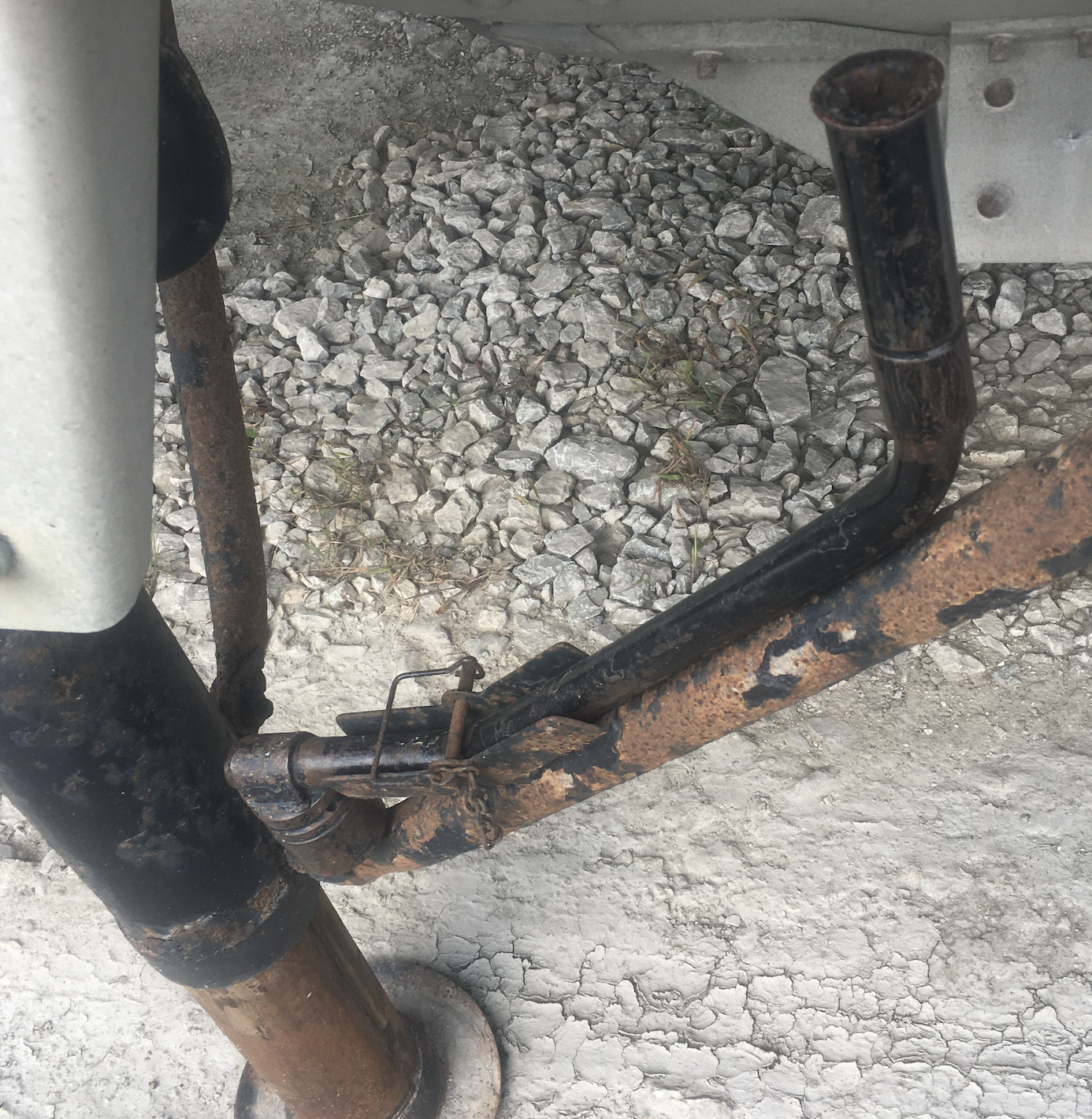

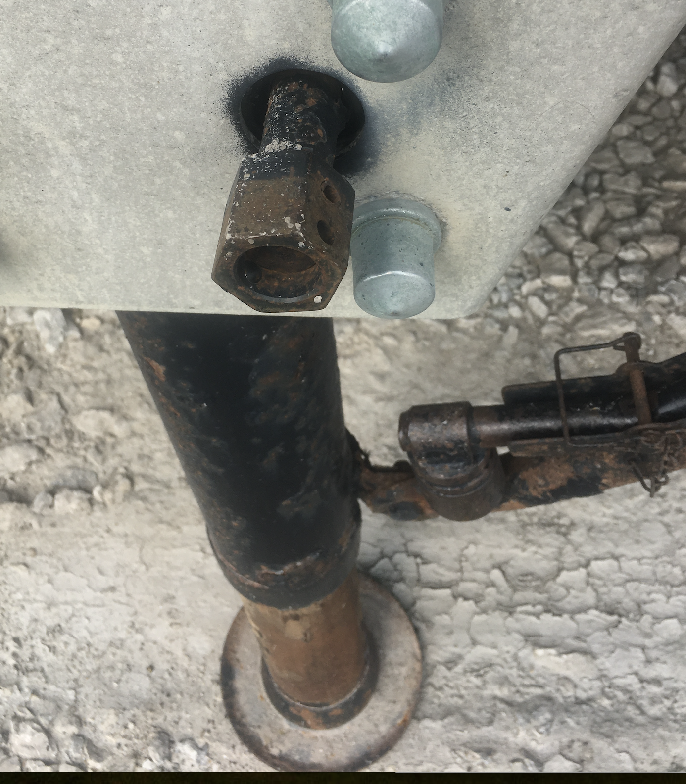

This is how the landing gear works on our Timpte Super Hopper grain trailers. The handle works on the landing gear and the dump doors. I wonder if you could weld a nut on the end of the shaft to use a drill and fix your handle similar to this.
Screen Shot 2020-09-22 at 9.29.20 PM.pngScreen Shot 2020-09-22 at 9.30.09 PM.pngScreen Shot 2020-09-22 at 9.30.35 PM.png
   / Cordless impact to crank trailer jacks #27
Hummm......:confused:
Just showing how Timpte does it. The handle has a hex socket that fits the hex nut on the shaft. A person could use a drill (or impact) to run the legs down and finish with the handle.

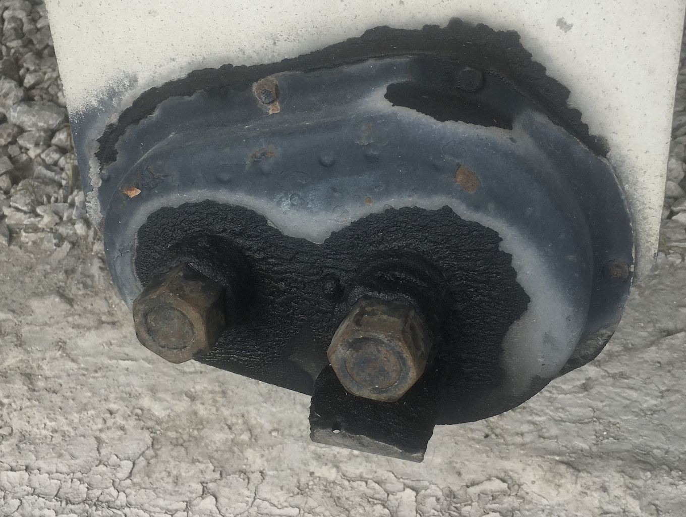

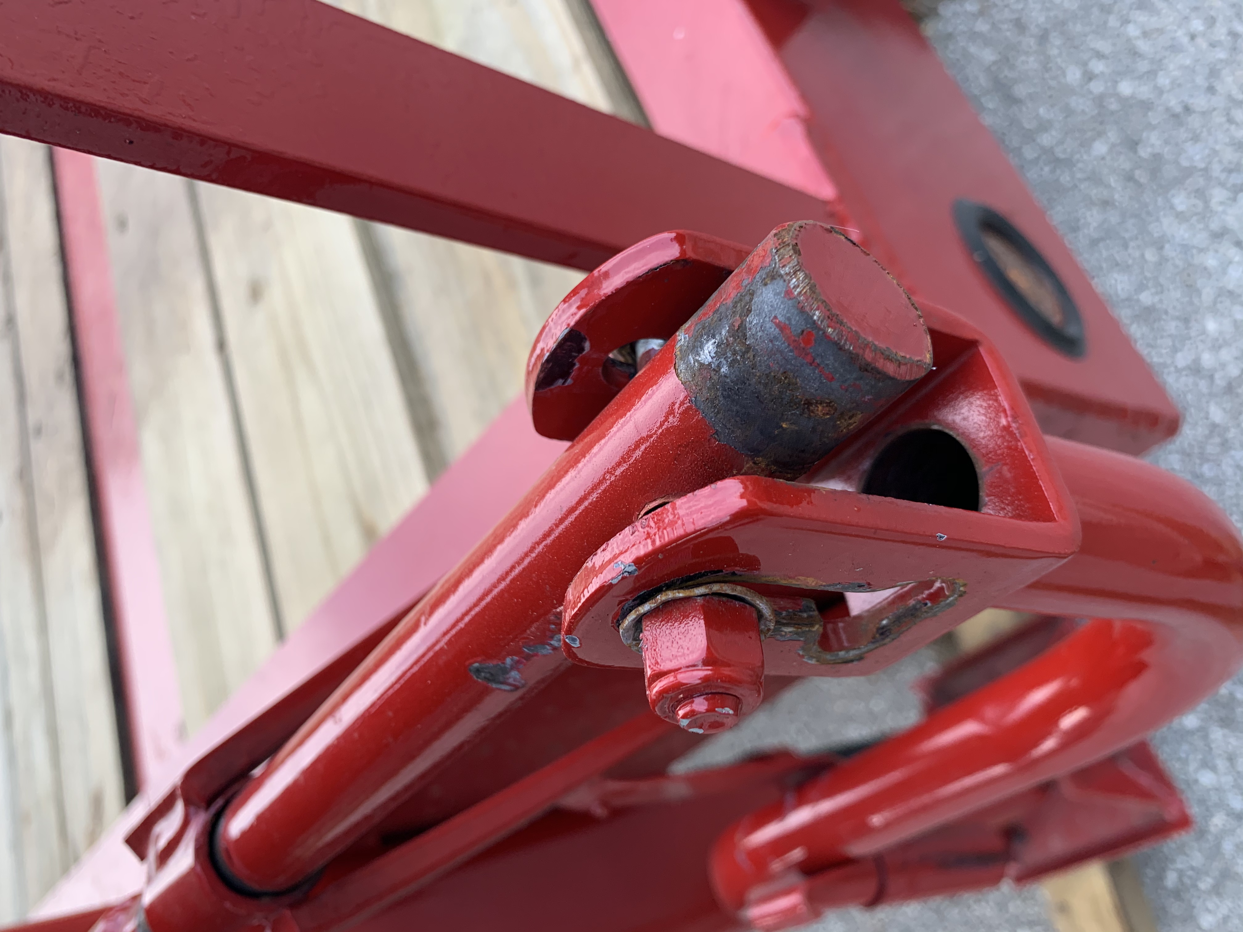

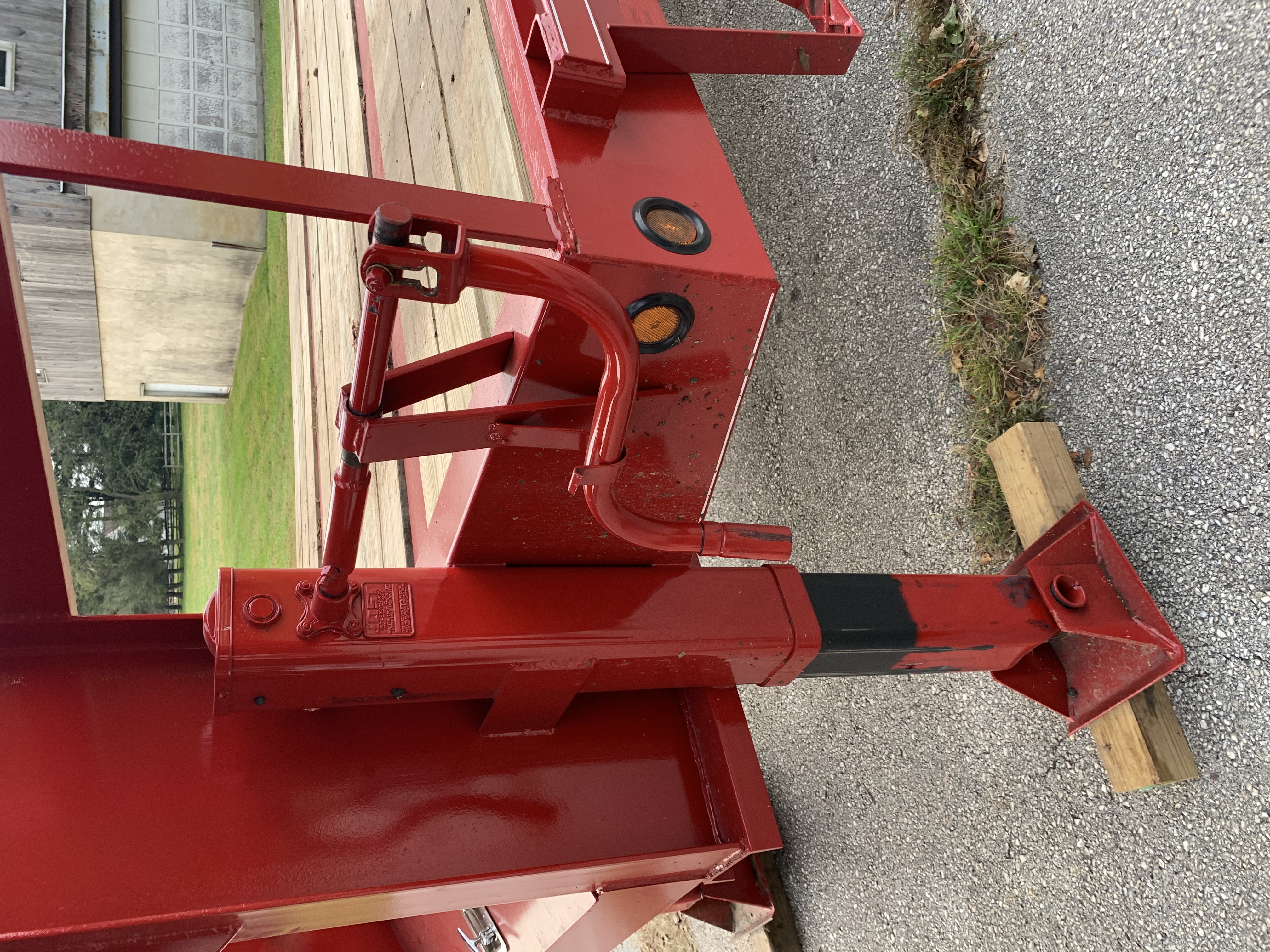

Here is my jacks & handle
