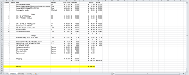

Here's a spread sheet of the parts required to install a true third function.
I just installed this on my L4240 for grapple control.
All of the mounting plates I custom made. I'll be doing a write up on the installation soon.
I tried to order this installed at the dealer but the factory kit was on back order for months.
The dealer was going to charge $900 installed. The Kubota kit is a really nice kit.
My installation cost for parts only was over $600.00
After you add my labor and fabrication my true cost is over a $1000.00.
FWIW I did order three factory rear remotes, two float and one two position spring center.
It's hard to say how much exactly they cost because the dealer rolled everything into one price.
I'd say they cost about $2000.00
The two float rear remotes are dedicated to the Top and Tilt.
The third rear remote will need to be split with a couple of diverter valves so that I can have three functions out of the one valve.
Eventually the grader blade will have Hydraulic offset, angle and tilt.
I installed four remotes on my L3800 and that cost was around $1500.00 parts only. Installation and bracket fabrication all in my spare time.
Link here.
http://www.tractorbynet.com/forums/...g/208593-top-tilt-rear-remotes-installed.html
