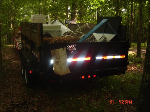

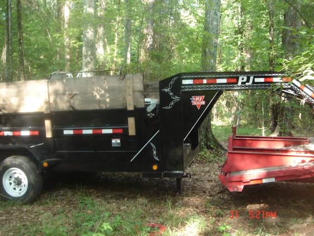

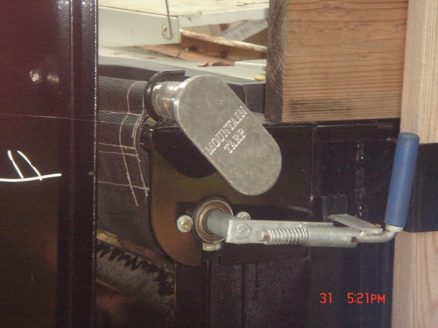

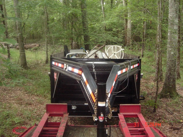

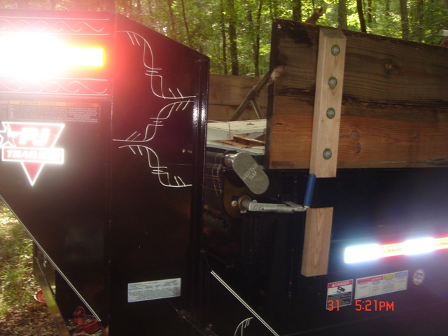

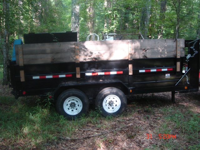

Here are a couple of pics. I know ya'll (Southern English) like pics.
Sorry about all the junk in it, I'm getting ready to make a run to the metal recycling yard.
Another nice thing about this trailer is I can move my Bobcat in it, and my New Holland TC-45 with front end loader and backhoe. So I can haul the equipment to the work site to load the trailer. That was one of my requirements when I was trailer shopping.
