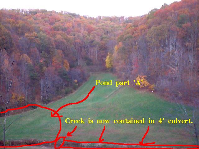

I met with the excavator again this evening and went over the project again. The yardage will work out fine with the amount of fill and grading we want to do. So far his references are checking out good and the contract looks good. I'll check more references tomorrow.

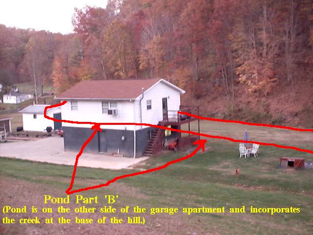

#32
The pond incorporates a creek from the center of the land as well as along a hillside. It's sort of l-shaped and measures about 301'x60'x160'x85' where the narrow ends are the 60'w at the apartment and 85'W at the holler. The pond will be 9' deep +/-. Eventually, the buildings out from will be taken down, leaving the driveway and pond out front.
This is the front site.

#33
Second part of the pond, towards the back/side of property.

#39
Alan
The fill needs to be moved btween 300 and 600 feet.
There should be enough dirt to make our pond blend in naturally also.
I'm taking lots of pics for a nice digital photo album of the construction.
I have around 70 pics on my camera yet to be dumped onto the computer (mostly of us putting in those 4' culvert joints!)
