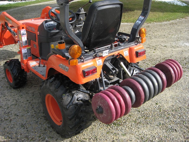

If turn around space is an issue then nothing would beat loaded tires since they would add no length to your rig. As far as cheap and dirty goes, this is about as cheap and dirty as you can get. I was able to find over 400lbs of used weights for $45 on Craigslist and at garage sales. One other thing you might want to try is to use the search feature on this site and search for "ballast" or "counter weight". I know it has been discussed before and it always amazes me on all the different ideas people come up with.

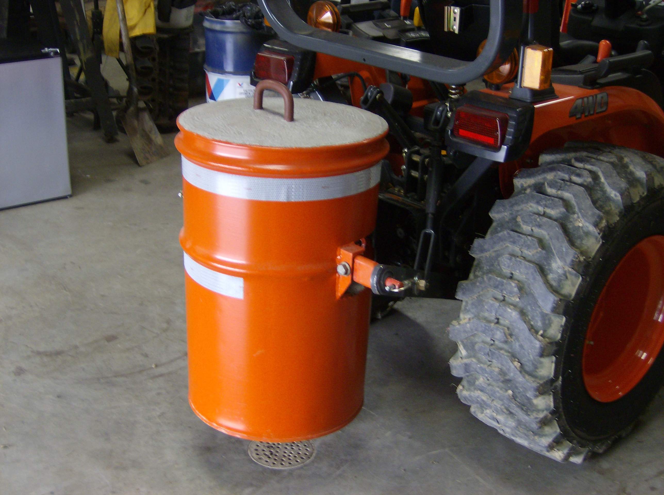

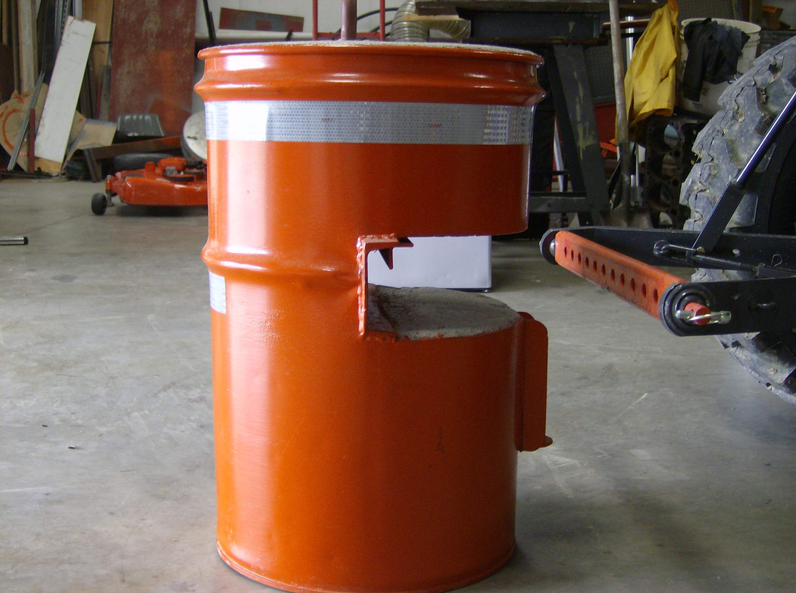

Here are some pictures of a fast attach counter weight I made for my kubota B2920. It is about a 30 gallon barrel filled with concrete,weighs about 500#. I cut out the center and fabed a notch that a standared draw bar with holes fits into. Just back into the cut out and lift,close draft control,put in 1 safety bolt and your ready to go. Takes about 30 seconds.

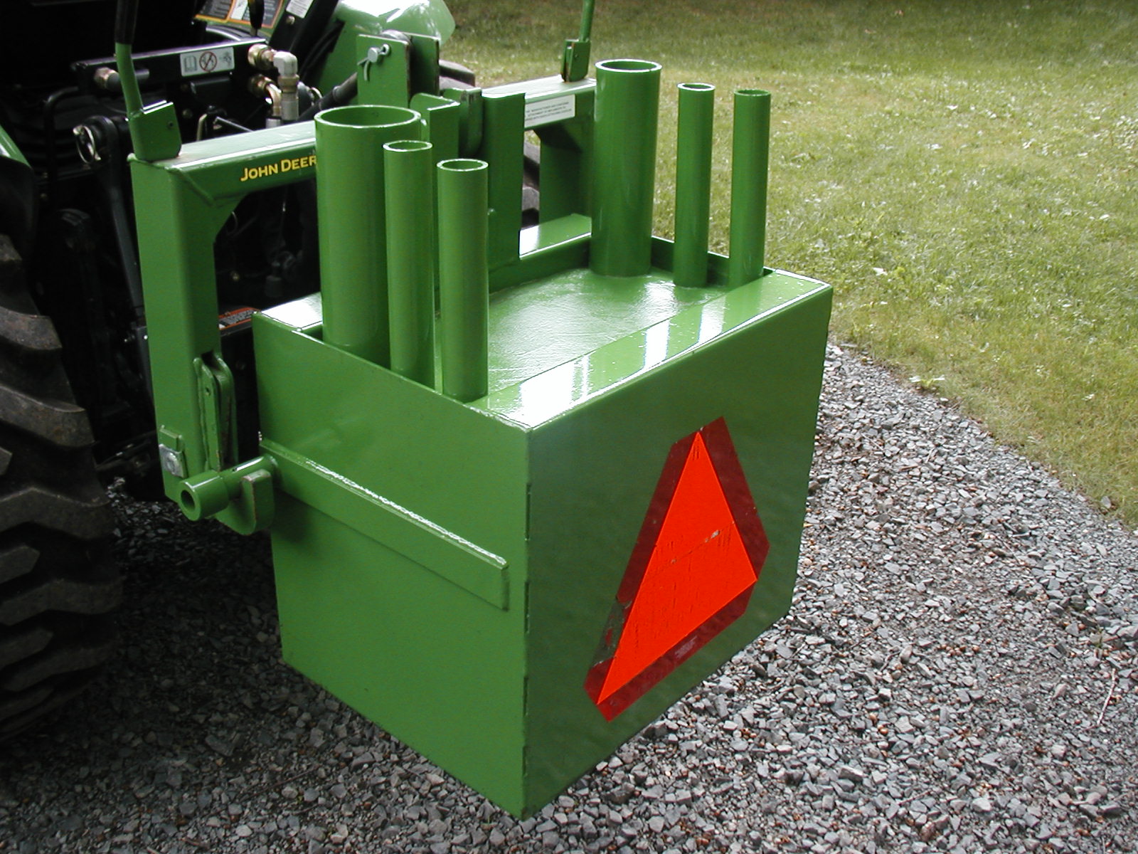

I bought this box a week ago for $25 from A Guy that got it new with his tractor two years ago. He said it had been used two times and had no use for it. Won't tell Ya what color it was but a $3 can of paint and 3/4 full of rocks what a inprovement in FEL work.
http://i34.tinypic.com/21e6g79.jpg
I know what color it was :) That was a great deal for $25. I would have bought it without a 2nd thought just to have another one. I filled mine with concrete but it would be nice to have an empty one for other chores.
Made one just about like this. Instead of the expense of a drawbar, I just drilled holes in the side and mounted 3 point pins, then welded scrap angle across the pins to connect them. Then welded angle iron vertically for the top link to attach to. I welded on rebar for support to the verticle pieces, and filled it with concrete.

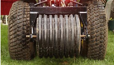

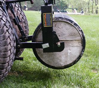

I have 2 rear ballast weights. The first is made from a 55 gallon plastic barrel with 50# of steel for the framework then filled 3/4 full with 10 - 80# bags of redimix cement. I estimate it about 850#.
I just made my second weight from a safe I had hanging around the garage that I tried selling but had no takers. The safe is about 40x40x40 and weighs over 1200 lb. It was used in a Doctors office as a data / records storage safe. I keep extra chains and tools in the safe while using it. I welded on some 3x3x1/2" thick angle and then drilled through to the inside and bolted the angle. The weight is in the fire rated cement sandwiched between the inner and outer skins.
