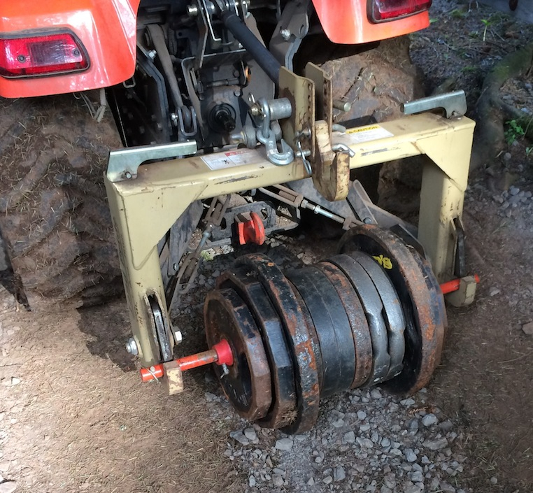

   / Counter Weight #6
Weights from Goodwill. About 3 feet of 1 inch bar. Pair of weight bar clamps.

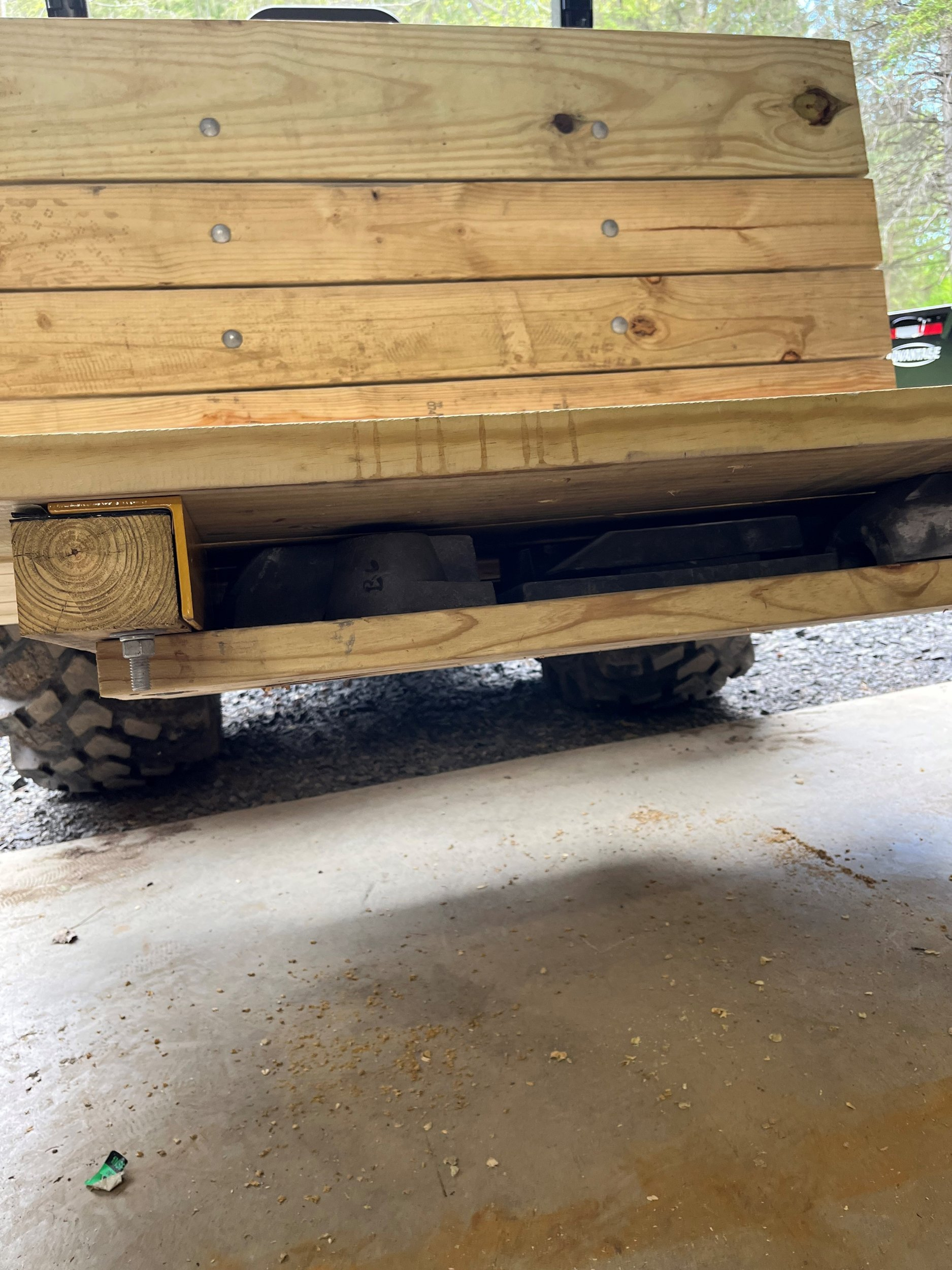

   / Counter Weight #10
I needed a Carry-all, but wanted to have it on when lifting logs with the grapple so it needed to be heavy. I put an extra layer of 2x6s on the bottom to hold a bunch of lead I had. Still under construction but should do the job. It's a little over 500#s now and I still need to add sides, tail-gate (with vise) and tools. I should be able to go over 600#s before I'm through. I don't lift a lot of big timber so I think that should do it.
