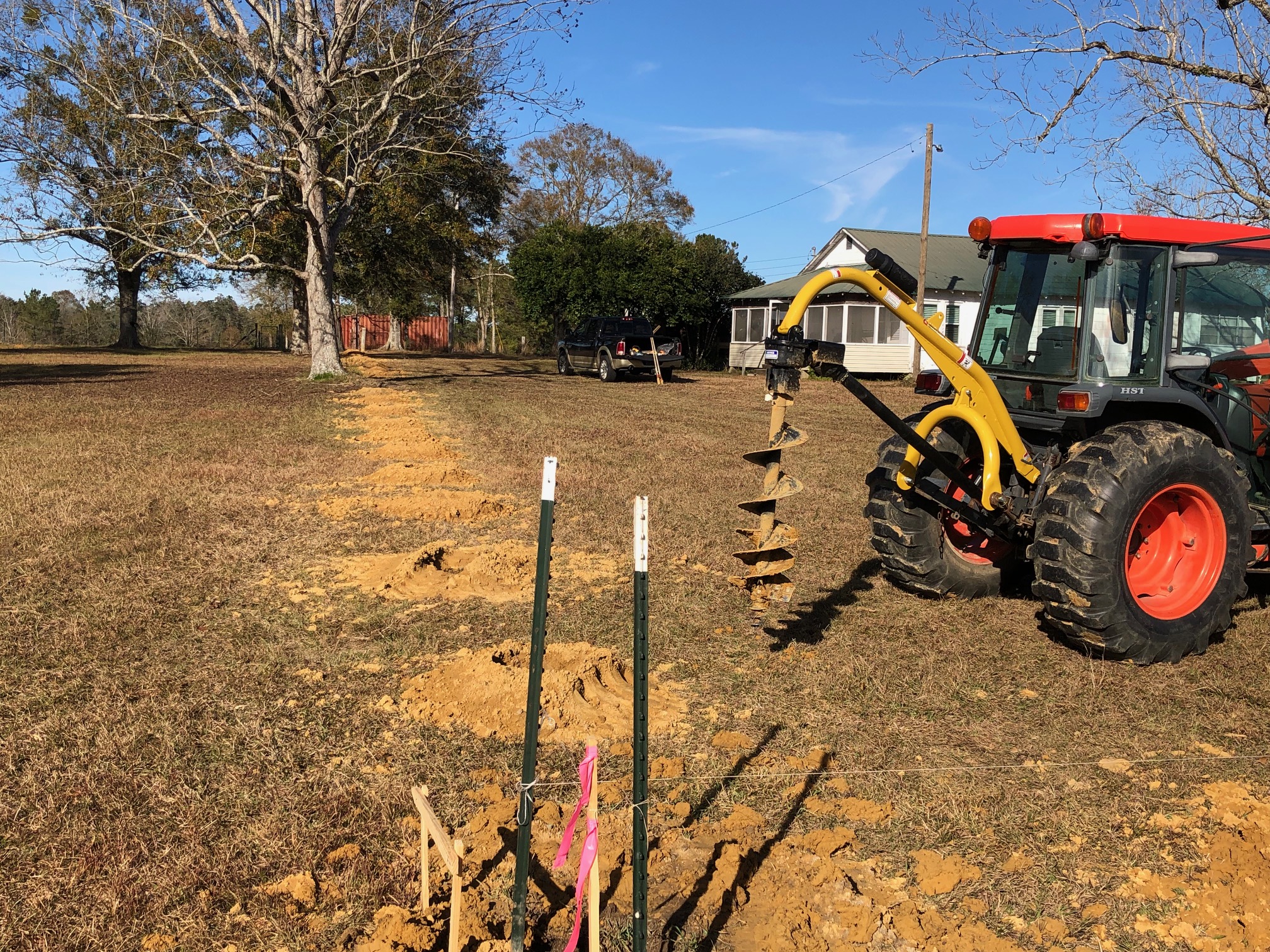

I couldn't be happier with the TSC auger. It has worked better than expected. Only broke one shear pin and it was the hole I saved for last due to tree roots. Sure enough the tree won that battle.
The only other issue I had was that I couldn't find the replacement shear pin. Searched everywhere. Then I remembered them with the manual. Searched everywhere for the manual. Was about to go to TSC when I realized both were in the tube where the manual is supposed to be. :mur:

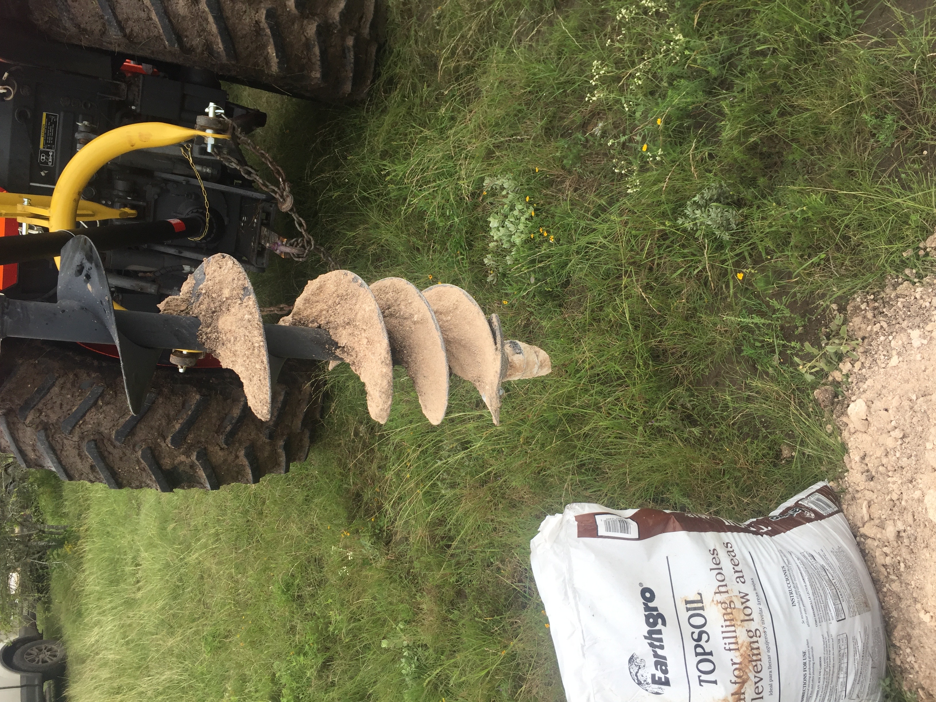

I dunno about you -- but i been using grade 5's bolts in my tsc post hole digger. i just buy them by the box at my local store like lowes or home depot.like the other poster said if you using the tsc stuff on sub compact or compact tractors - i dont think you will be tearing them up. I have drilled many holes for decks builds on my job and i would always break the auger shear grade 5 bolts when it finds a medium to large rock. I am not complaining - i think its doing what it supposed to do.

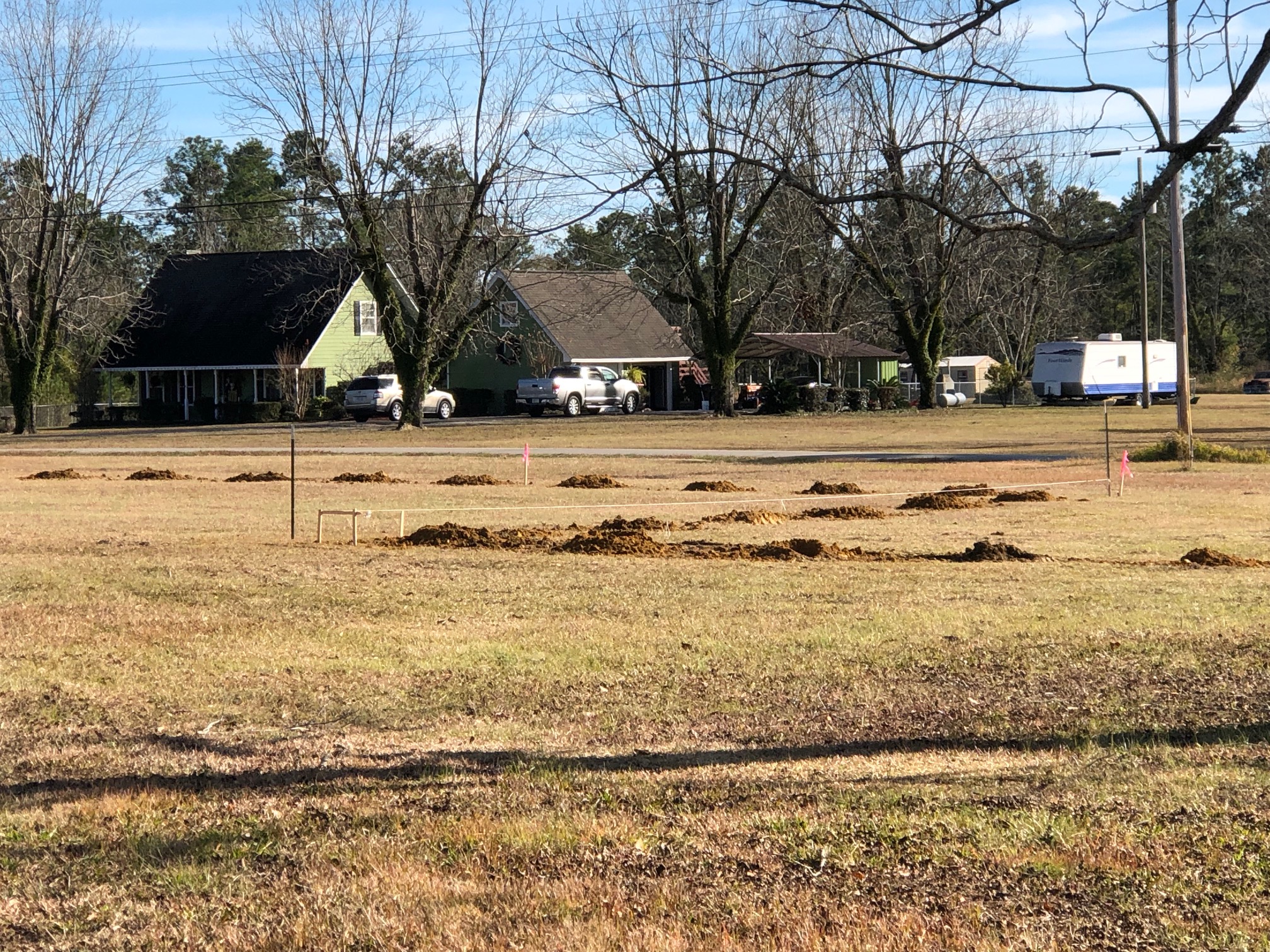

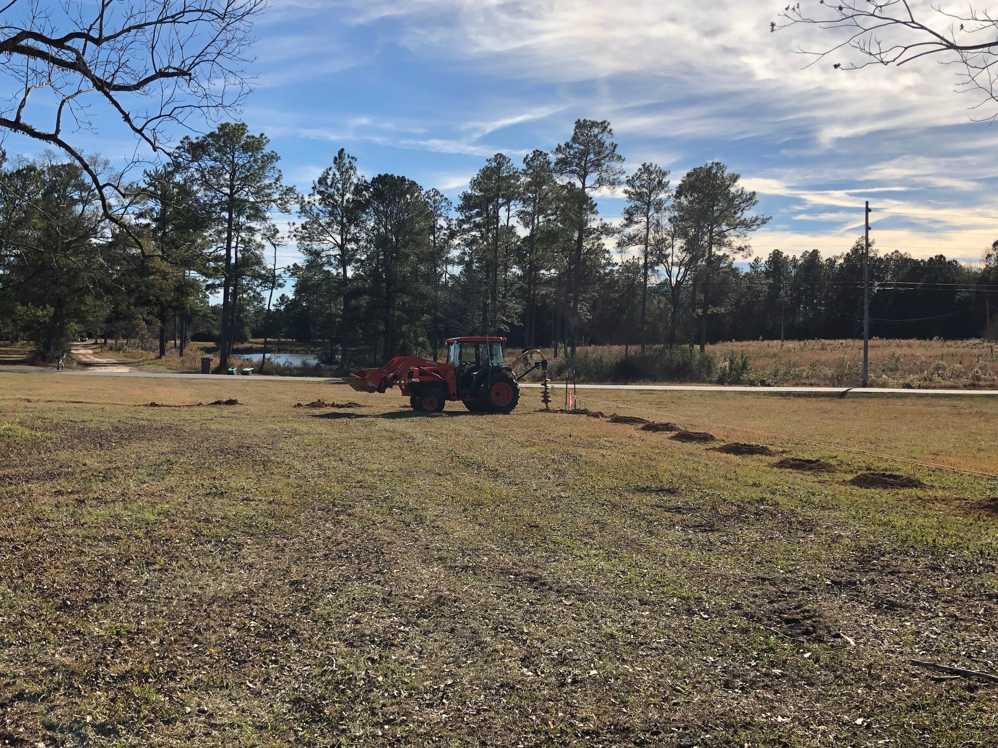

If you need it for commercial use.... ie Fence builder, every day use... TSC isn’t your place... But like most on here,,, You might drill 20 holes a year or 200 in a month then string her up and never use again.. TSC drill is for you.. I am very happy with my purchase. I drilled 7 holes thru caliche rock with it and she dug very well.. Only sheared one bolt... I was impressed..

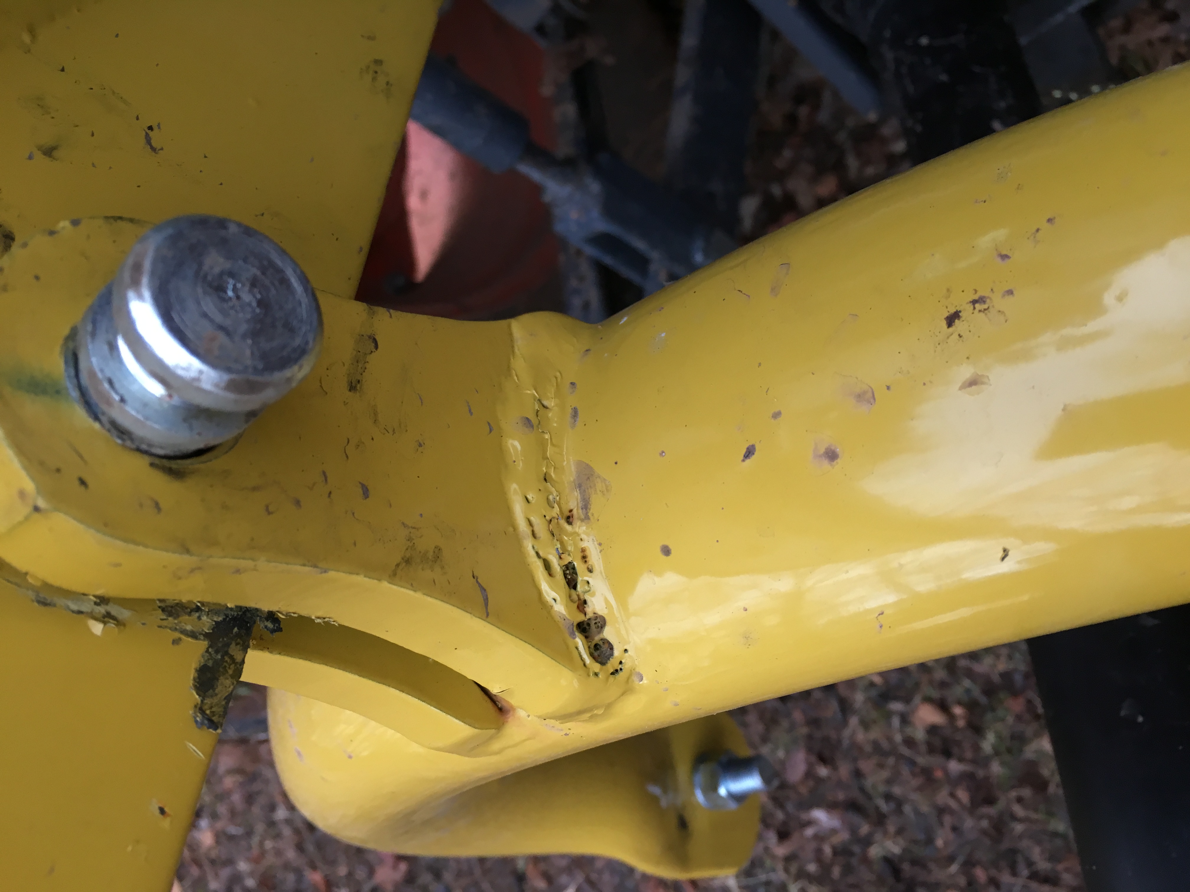

As far as the weld original post..
It must have slipped by Quality Control.. lol. it happens..
Like others mentioned.l Its easier too grind/clean and throw a bead on there...

Careful which one you get from the lot. Check the welds before you take it home. Lots of porosity here. Dang tab was almost broken off after three holes.
View attachment 583333.
Wire wheel that crappy paint off and put a good weld over it, good as new. I have some county line attachments and they've been good for the money in my opinion.
Yep, I find the same. Country Line attachments are worth what you pay for them.
However, nothing beats an air operated needle gun for removing paint and welding slag. Removes paint much faster and gets into cracks and clevises where a wire wheel will never touch. Cleans the metal better and by doing so eliminates porosity in the new weld. ;)
