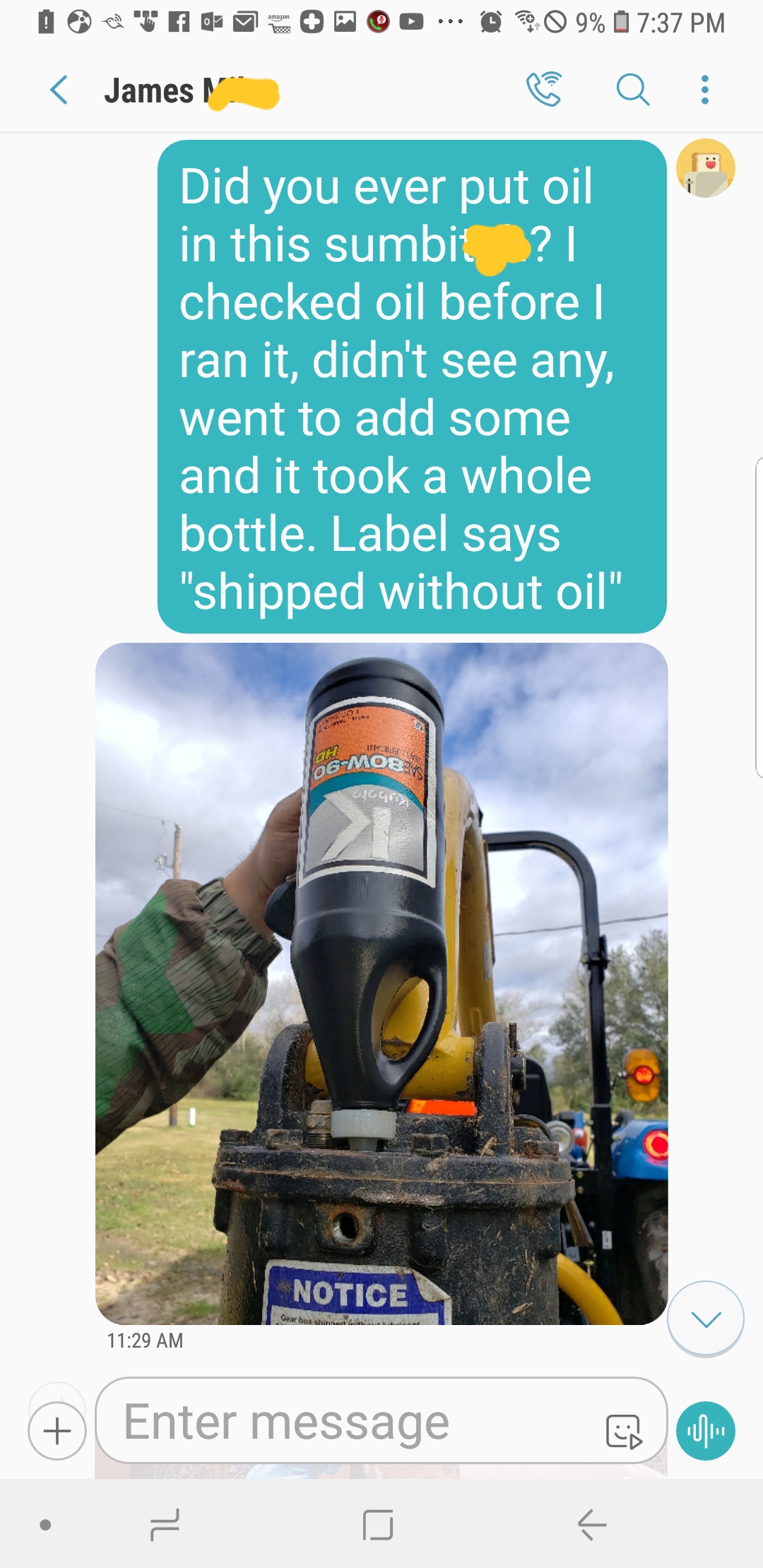

The TSC post hole auger is pretty bullet proof in my book. It will run for years without a drop of oil in it. I know because my buddy has one and he's dug a couple fences and a pole barn with it and I've borrowed it a few times over the past 3 years he's owned it. I borrowed it last week and decided to check the oil before I ran it. See attachments.
   / County Line Post Hole Digger - Watch which one you get! #38
View attachment 583769View attachment 583768
Very funny. Loved the screenshots.
