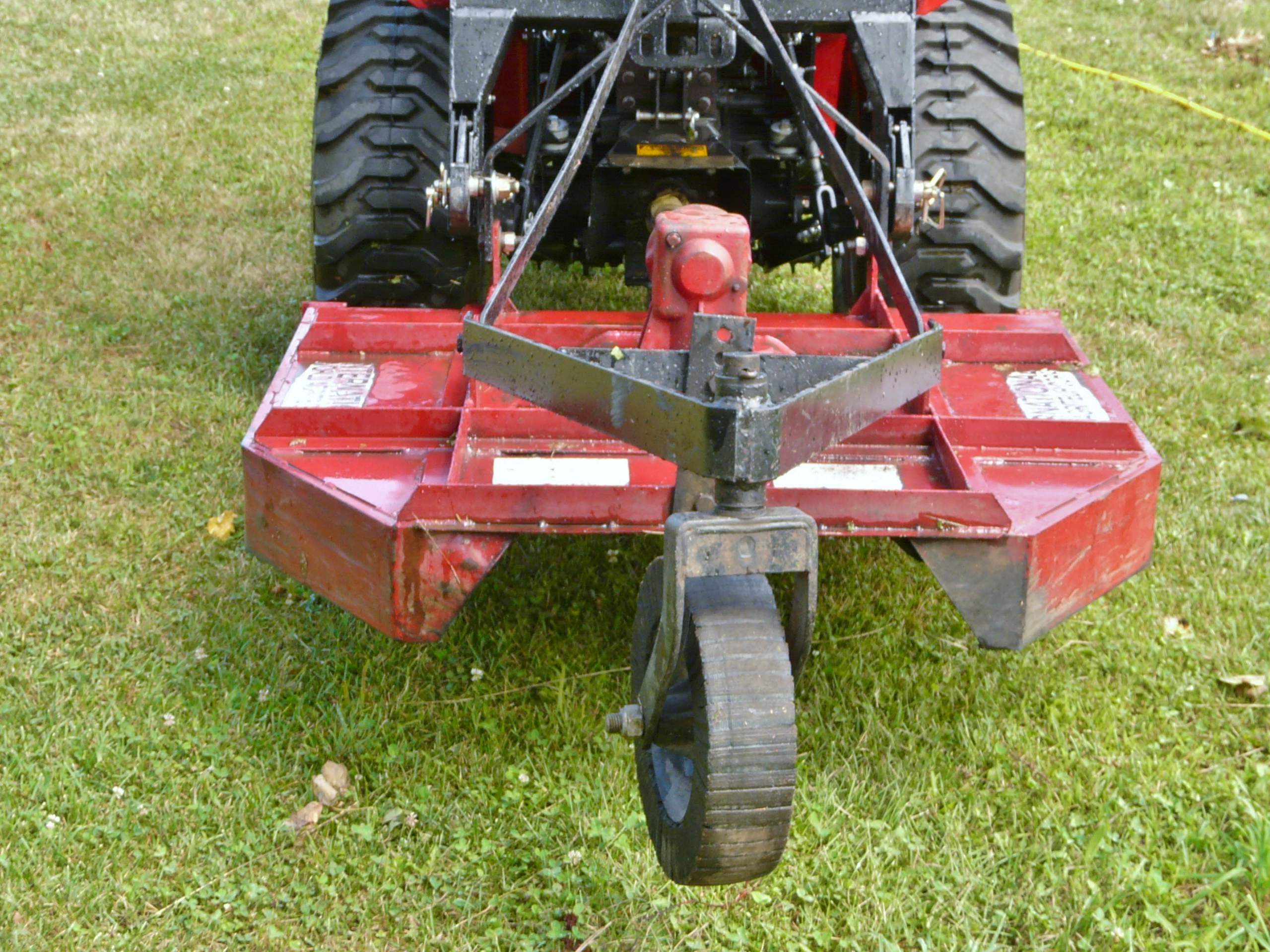

I reworked the "flex link" on my BushHog thusly. It required that I drill a new hole to relocate each of the two vertical side links at the correct QH spacing from the lift pins (I think I used 15").
Also had to cut/grind down the bolt that connects the long "back links" so that it would pass between the verticals when necessary.

The flex link is vital (IMHO, and that of Bush Hog) to allow the back of the hog to swing up and down to follow the ground contour. Some folks have just replaced the long back links with chain to accomplish the same thing.
Yes, the top hook on the QH can just be moved up or down, but I disliked the notion of having to "adjust" the QH any more than absolutely necessary between different implements. Makes it easier for the wife to change implements herself. So it was easier in the long run for me to just adjust the spacing between the lower pins and upper pin to fit exactly. This required redrilling the two holes for the side links about 1-1/2" lower.

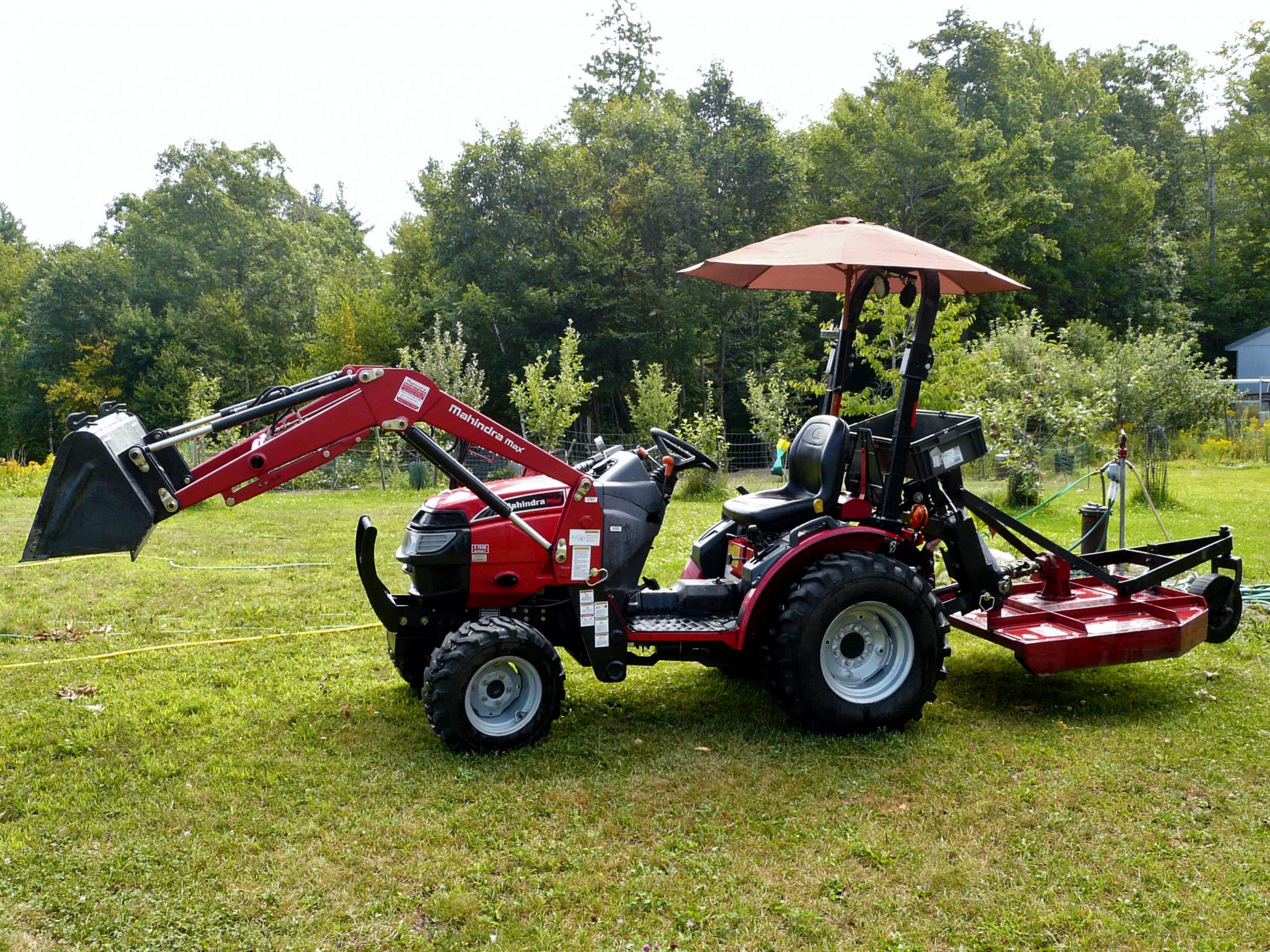

You only need that top link to lift the mower, not when mowing. So chain is sufficient.
And at least in my experience a lot of flex is needed there. I mowed down a gentle slope and as soon as my front then rear tires dropped off into disked ground at the bottom of the slope, the rigid top linkage I had at the time left the tractor suspended with only the front tires and the mower's tailwheel touching the ground. 2 wheel drive so no brakes. I slid down a few feet out of control until the mower's rear wheel reached the bottom of the slope. I had started to turn so this made me slew around toward sideways too.
I learned then and there I needed to add some flex.
(Photo) That wasn't even much of a slope. I was mowing straight down this 'lawn' toward disked ground on the near side of that orchard row.
Summary: You need flex if your terrain is uneven, even to this minor degree. You need a lot of flex to mow up/down terraces like I showed in post #43 above.
