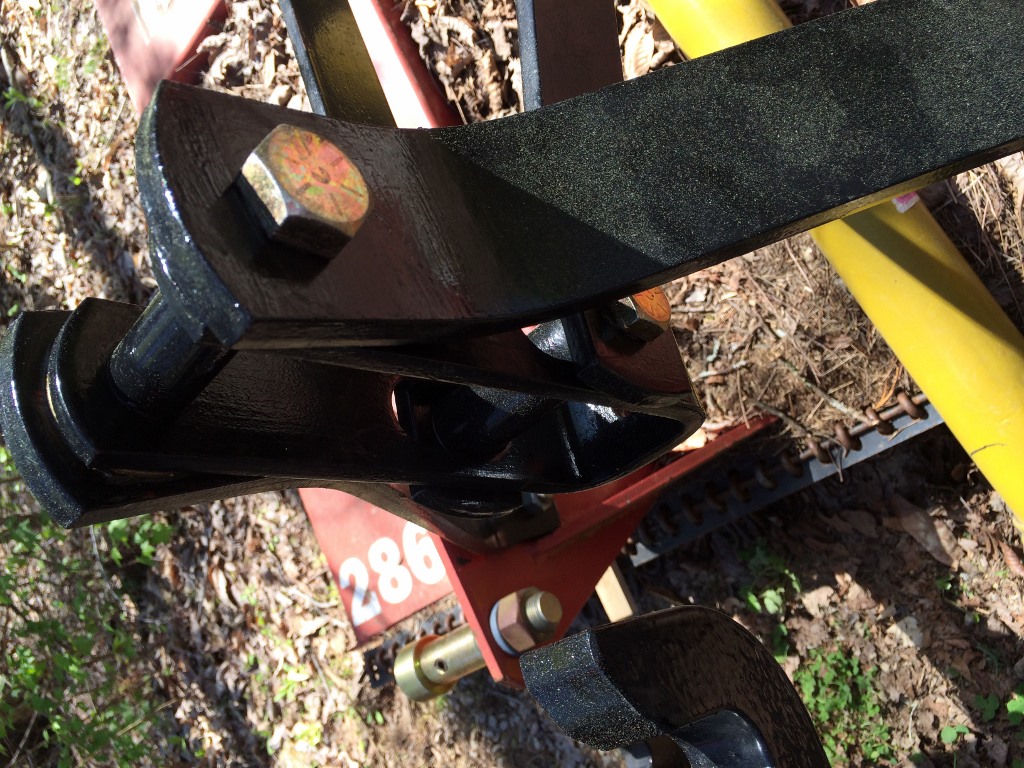

The other two pictures are of the top mount area of another implement. I didn't play with it, just took the pictures. Any comments/thoughts about how this will work with the QH? It's a pretty common setup on implements so I expect some of you guys to have experience here.
We were / are in the same boat as you. Modern QH & Antique Implements. In the case(s) like the one you pictured here, we were lucky enough that the height of the bolt for the bracing was relatively similar across the implements so we moved the braces from inside to outside the upright links and added a wider spacer (cut piece of steel pipe) and new bolt as needed and use this bolt for the top link connection.
We had one implement that the braces were too heavy / thick to bend the small amount needed to relocate so we did end up notching & welding them in place.

To answer one of your earlier questions, if you can't get them converted then the adapter should work - just swap it for the top hook.
I bought the adapter just so we would have it but thus far we haven't had to use it yet.

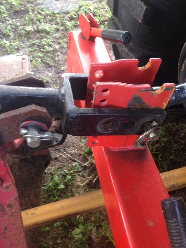

I reworked the "flex link" on my BushHog thusly. It required that I drill a new hole to relocate each of the two vertical side links at the correct QH spacing from the lift pins (I think I used 15").
Also had to cut/grind down the bolt that connects the long "back links" so that it would pass between the verticals when necessary.
