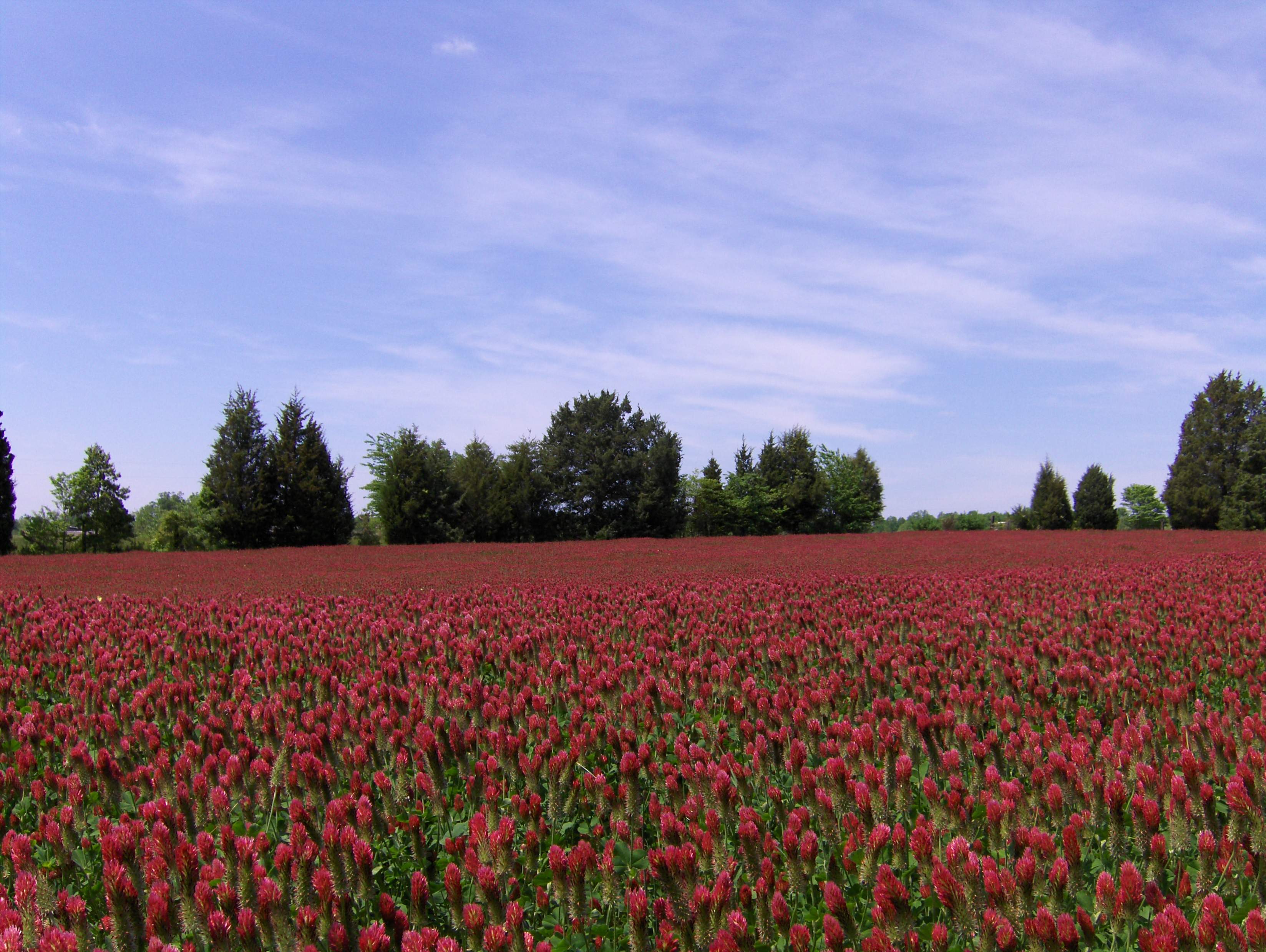

I've had good luck planting crimson clover as a cover crop on some of my plots. The photo attached is from April. Decided to test one plot by bush-hogging it in June after it seeded and letting it reseed. It grew and looks great now going into the winter.
