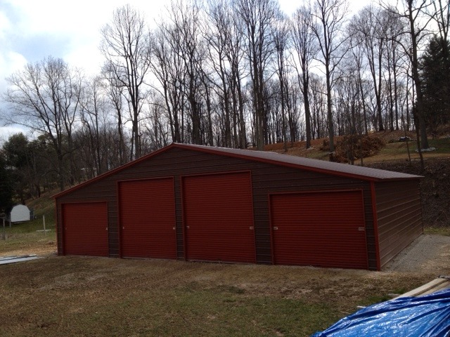

The most economical way to get them under a roof would be a carport. Carolina Carports - Homepage
I opted for the Carolina carport.
