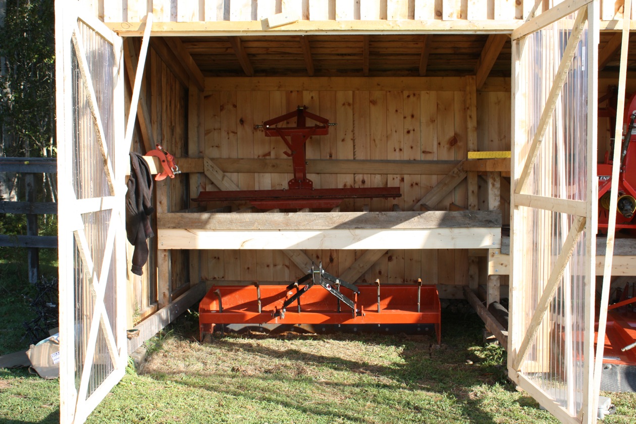

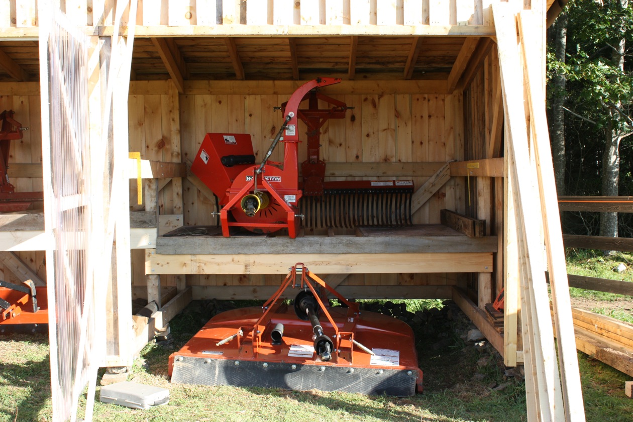

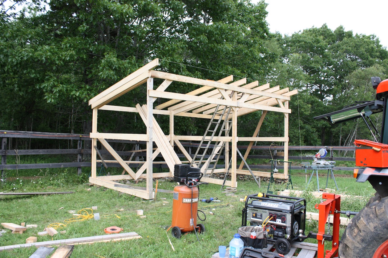

bdavis,
I built a 10'x20' shed with shelves that hold some of the smaller implements - sander/spreader, back blade, rake, chipper and auger. The bigger stuff - bush-hog, box blade stay on the ground. It is board and batten with metal roof and open front with pvc glass doors to allow sun it to keep moisture low. I use the forks to get items off the shelf when needed. And yes, I should have built it deeper 12'-14' but we can build up to 218 sq.ft. without permit here thus 20'x10'.

Very clever idea to get around the permit thing Lloyd!!! That shed accomplishes a lot for no bigger than it is!!!! Very clever.

Wow, great idea!

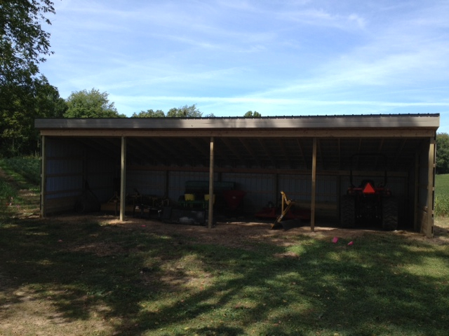

I built a 40' x 16' lean to 10' high in front and 6' in the back. It was pole barn style
The cost for materials from menards was $2300.00. I will install sliding doors this summer.
It took us 3 days to build.

There ya go Murfster!!! Good investment!!!
