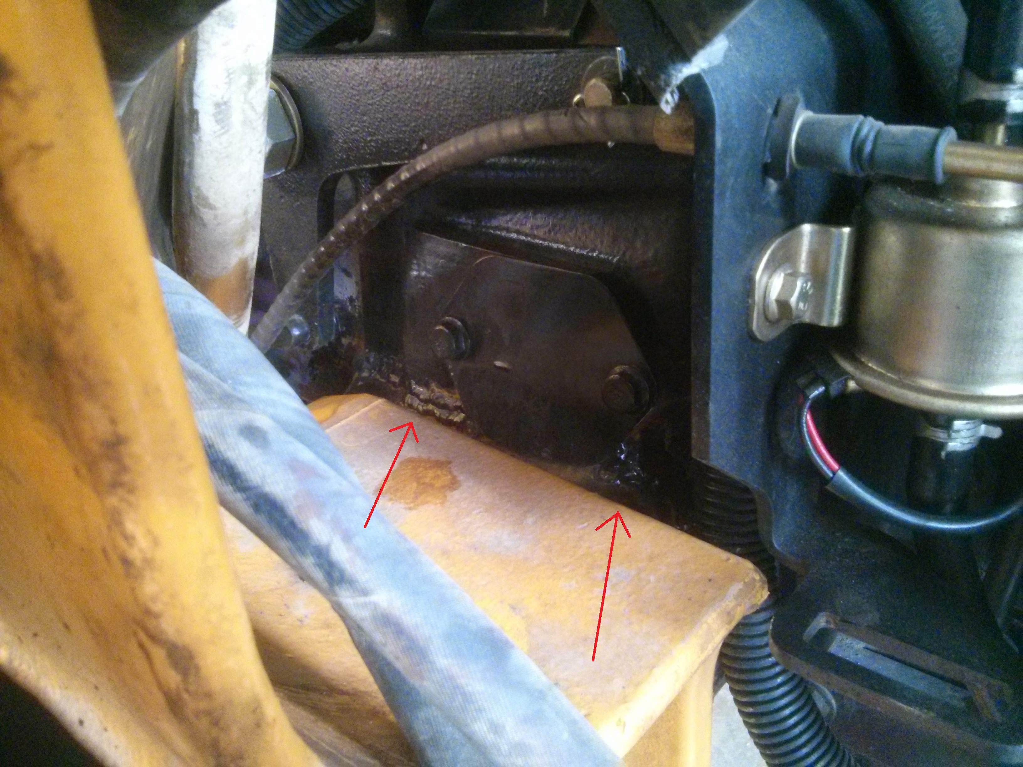

the only pic that I have is a cracked bell housing that has been repaired
   / Cracked bell housing in a 2006 110TLB #83
Thanks doc. wow, that's not an easy spot to inspect. would recommend this TLB aside from this known issue?

Browsed through this pretty fast. On the discussion on whether it was CI or steel the welder should have known as soon as he started grinding the V. Difference is sparks is notable. Not familiar with the tractor; but, is the bell housing part of the tractors structural frame supporting the running gear? Older tractors were made that way. Now frames are structural steel shapes due to the cost of those heavy castings today.
Cast iron in place and possible under tensions I would do the repair with bronze welding either torch or stick electrode. It is more malleable under stress than nickle rod. I have used both successfully.
Ron
   / Cracked bell housing in a 2006 110TLB #86
Honestly if it ever happened to me (based on what guys say Deere wants for the bell housing) I would fab and machine the entire thing from steel.

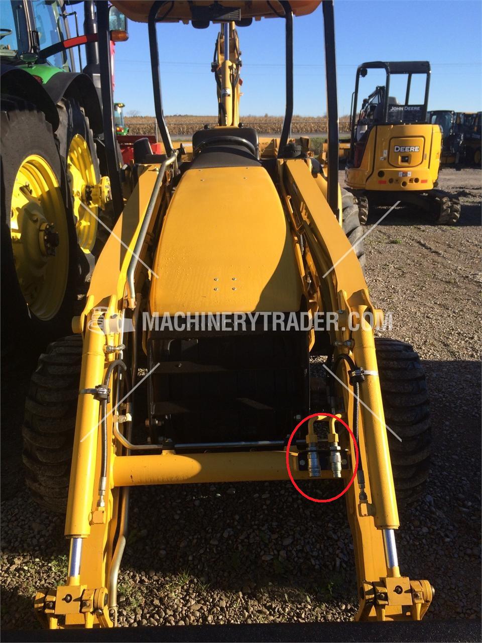

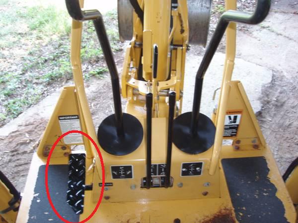

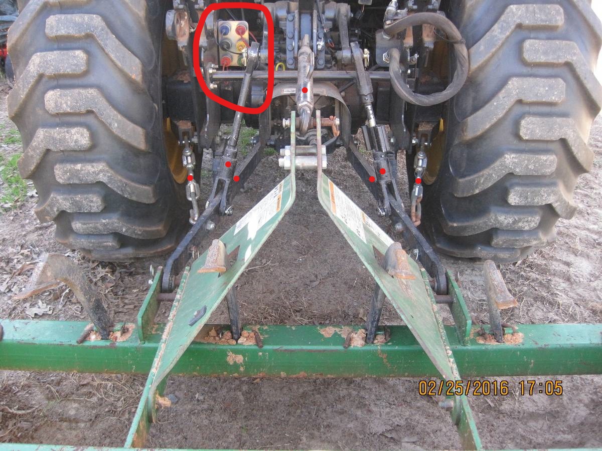

Some of the options that are nice to have
3 point hitch
Rear Aux Hydraulics
Foot Pedal control for thumb

Front hydraulic outlets
